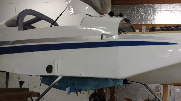

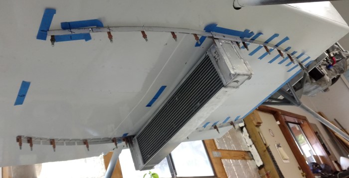

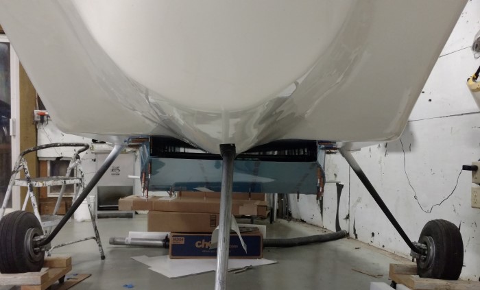

Update on Belly Scoop
Just an update. I made a little progress on the belly scoop. There are two pics below. One of the scoop from the side and one from the front. The odd blue color is just protective plastic sheeting on the aluminum. As you can see it is still in the cleco stage, but at least it is progress. Astute viewers will notice the front opening is offset one inch to the left. This is to avoid the exhaust that will eventually exit the right side of the cowl.

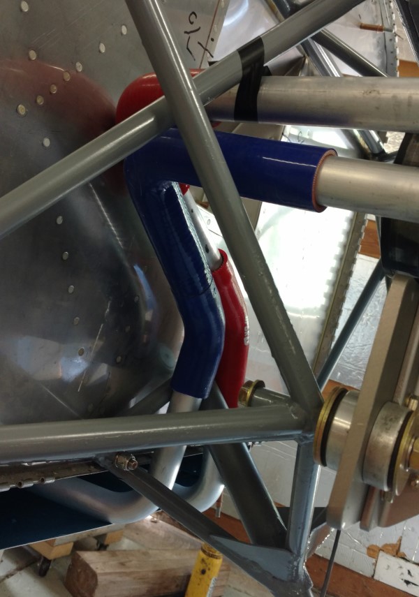

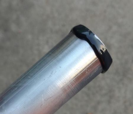

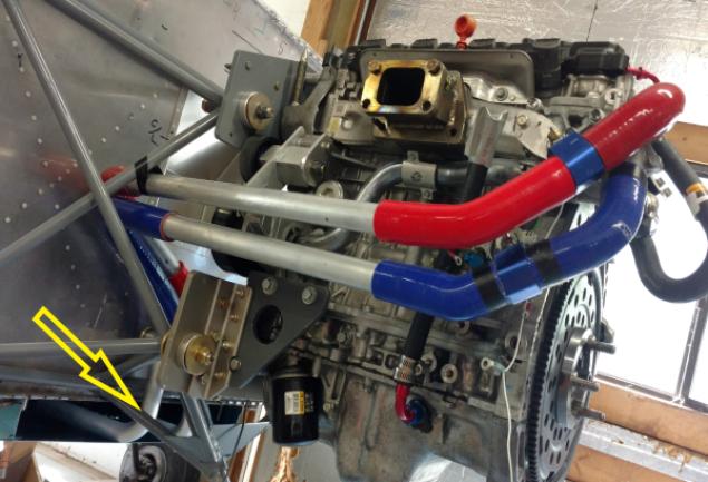

coolant tubes roughed in
Now that I got my shipment of tubes and elbows, I roughed in the coolant tubes in a path that I think will work well for my set up. The aluminum tube is 1.25" OD 6061T6 that is 0.062" wall. The elbows are 4 ply silicone. If you look close you will see a dark anodized "joiner" at the top of both the cool side and the hot side tubes. Each of these has a 0.125" NPT temp sensor for monitoring.
Notice the tubes go down at the firewall and then enter the radiator scoop where they will eventually connect to the radiator. The second picture is a close up of the route near the firewall.
While it is not particularly necessary, I put a bead of JB Weld on the ends of the tubes to help keep the silicone fittings from slipping off. Works great.

I'm not familiar with molded silicone elbows - they really look nice. I guess hose clamps are still needed?
John,
Yes I should have noted that when the final lay out of the pipes is completed all elbow will be band-clamped on the aluminum tubes and there will be cushion clamps used to secure the pipe firmly in place, against other stronger structures.
Silicone has been around several years but was not used too widely until the costs started coming down making it competitive with the more common EPDM hose. I like it when it comes to basic 45 and 90 joints. It is more flexible and very good choice for coolant. But they cannot be used for oil or fuel.
Charlie

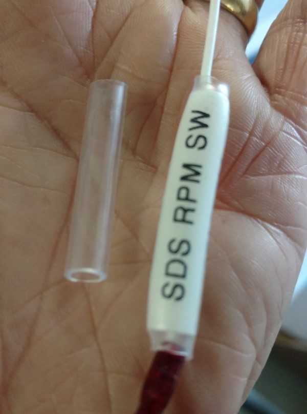

labeling wiring
I had to send the radiator back to the shop to have a pin hole filled.
It gave me a chance to start getting serious about installing the engine wiring.
One point that I had struggled with in the past (may be some out there have too) is how to label thin wires, esp if the terminal is already on the wire?
One option that works well for me is to take a short length of flexible 1/8th PE tubing (the kind at the aviation isle at Home Depot) to give the label something large to wrap around and then cover both with clear shrink tube.
On important benefit is that you can cut the PE tubing lengthwise if the terminal is already on the wire, then slip the label in between the 1/8th PE and the shrink wrap. make sure to cut the clear shrink wrap just a bit longer than the PE tubing so it will shrink down around the PE and the label to hold it all in place.
Here is a pick of the finished product, and that short section of PE next to it.

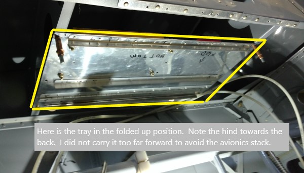

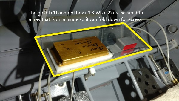

fold down tray for ECU etc under panel.
I suspect I am not alone with struggling to find room for all the electrical components that need to be installed. Even more difficult is finding a way to make it secure, but accessible. One way that I have seen others do is to build a tray under the sub panel that can be removed, hinged, or even slide out on rollers.
Here is what I came up with. It is a panel that has a hinge at the back, so the majority of it can be unbolted so the tray can swing down in front of the rudder pedals for "easier" access. I do like it but i also struggle with esome interference with the throttle cable. Nothing that I cannot work around.
The next picture is of the tray swung up and bolted in to place.
Notice the 0.032 stiffners I added to the bottom just to give it some strength and rigidity.
Disregard the loose random break lines. Those qualify as a yet to be done project....and.....wait until you see the birds nest of wires that I get to clean up!

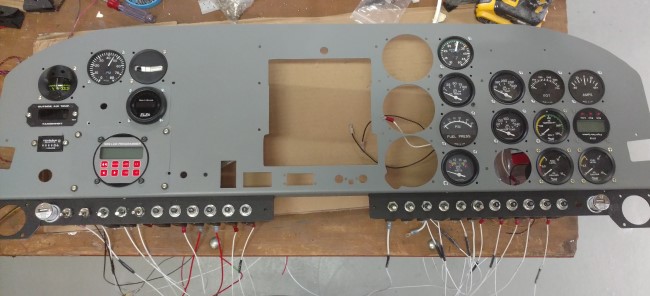

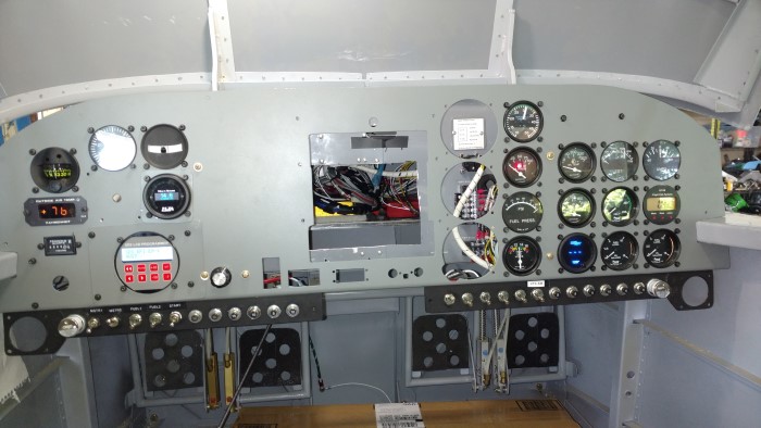

working on panel
Just up date on the progress.
I have the wiring from the FWF back through the sub panel and I have a good start on the panel...
Here is a pic below. When it comes to the engine instruments you will see "traditional" gauges. I guess I am a bit old fashioned that way. The "Blank" area in the middle of the panel will be an IPAD probably running forflight.
Also, one thing I found that I really like, is a USA made, water proof, re-settable master breaker, and only $26 bucks!
Here is a link to that breaker. https://spemco.com/175-s0-090-2-mechanical-products-90-amp-manual-circuit-breaker-surface-mount/
I have this mounted on the subpanel.

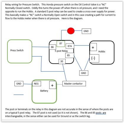

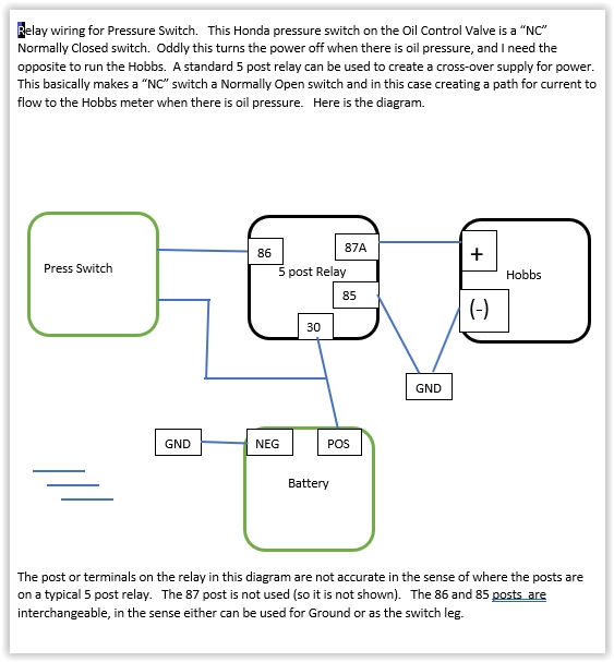

Hobbs Cross Over Relay switch
As I progress with the wiring of the panel I learned the Oil Pressure switch is a "NC" Normally Closed switch. Which means that the contacts are closed thereby providing a circuit (power) - unless - there is oil pressure, the opposite of what I need. Since I want to use this to run my Hobbs I need to reverse it. I need it to be a "NO" Normally Open switch.
I could plumbed an after market NO switch but since there are two oil pressure ports on this engine it made sense to me to use one. Oddly, one is BPST thread and the other is an "O" ring 10mm thread.
So I decided to use a common 5 post relay to convert this from a "NC" circuit to operate as a "NO" switch. Thereby providing power to the Hobbs only when there is oil pressure.
Charlie
I assume you simplified the drawing; not showing the Hobbs system being wired after your master contactor. As drawn, the relay is a parasitic drain on the battery when the engine isn't running.
Mike,
You would think that would be easy. So far I have ordered two and neither were the correct units. One came with NPT threads, event thought it was advertised as 10mm (which is what I need). The other was 10mm but with 1.0TP and I need 1.25TP. I do have a 3rd one on order, so we'll see.....
In the mean time I decided to wire up the cross-over relay to get the job done.
Then I thought, what the heck, I'll share it thinking someone may find some value it in it, if not for this purpose, may be for another application.
....and in case some may wonder about just installing an oil manifold, I thought about that too, and may in fact do that too, but this relay was a bit easier for now.....
Charlie

While I previously said 87 was not used, I should have mentioned the option of using post 87 for a low oil pressure warning light. The 87A in this case works as the NO line, 87 will be the opposite, it will be NC, hence when oil pressure is lost, this leg will close and energize the warning light. You can buy 1/2" very bright to install in your panel in a variety of placed.

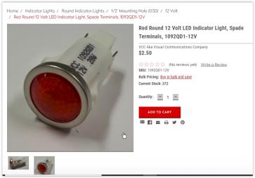

Here are the ones I like and use...
https://spemco.com/red-round-12-volt-led-indicator-light-spade-terminals-1092qd1-12v/
They come in a variety of colors

Panel installed and ready for engine run
Just over a month ago, someone asked when I could have the engine running on the airframe. Largely the hold up was building the panel. At least to the extent that it included the necessary gauges to run the engine.
Well I installed the panel today. It took a bit longer than I had anticipated but I am happy with the results.
Here is a pic of it installed.
Some of you will be surprised to see analog gauges on a current panel. When it comes to monitoring the engine systems I like gauges. Just me.
But when it comes to navigation, well that will be glass. That is why you see a fairly large blank area on the left. I am leaning on installing an IPAD and running foreflight for navigation.

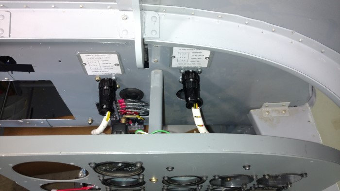

I know I mentioned the "CPC" circular wire connectors previously, and I thought I would include a pic of those. They are hard mounted in the sub panel. I ended up using 3 9 pin connectors. This makes installing the panel, or upgrading it very easy. These connectors are readily available from Mouser, or DigiKey, or Ebay. They take wire anywhere from 22ga up to 14 ga. I did end up having to use one full sized Universal Mate-n-lock connector because my starter switch wire was 12ga and the panel feed line was 10 ga.
You will notice a white colored paper above each CPC connector. This is a list of what each terminal (wire) is as well as a diagram of the pins.
I suspect it will be a more than a week before I actually start the engine. I do have a bit of coolant plumbing to finalize and secure some loose wires, etc.
Feel free to ask questions.
