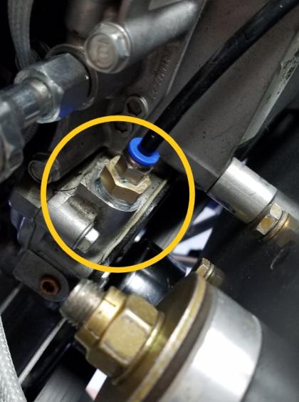

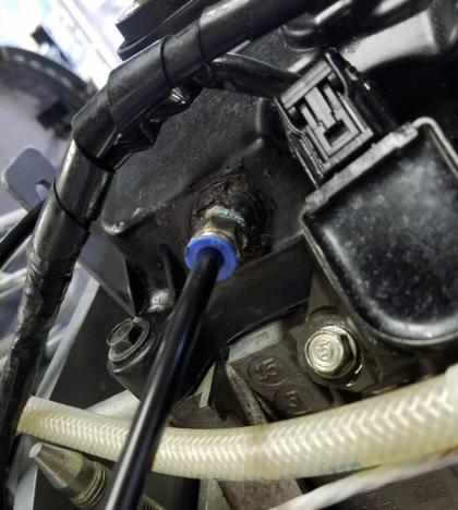

Venting the crankcase and valve cover space
One important task when turbocharging an engine is to recognize the potential that pressure may develop in the crankcase if measures are not taken to vent the crankcase beyond what is normally accomplished by the PCV.
When you add turbocharging you add positive pressure to the intake manifold, which by its very nature eliminates vacuum from the intake, which prevents the PCV from being able to vent the gases in the crankcase.
One solution to consider is to add a line from the crankcase to an oil catch can. This is often done in lieu of the PCV. The reason for this is that in order for the PCV to work effectively, it needs vacuum.
Here is a pic of a push-to-connect nylon line where the PCV used to be that is connected to an oil catch can.
The same is true for the valve cover, it needs to be able to vent pressure and the best way is to connect a line to a catch can as well. Here is a pic of a push-to-connect with a nylon line on it as well.

If these are the only crankcase vent lines, I'd suggest upping the size considerably. Minimum I'd run on a turbo engine would be a single 1/2" ID.
If you've ever seen a turbo engine on the dyno at full chat, you'd see a very high rate of flow from here which can build up a lot of crankcase pressure quickly.

crankcase pressure
I was able to get a MAP pressure gauge connected to the 1/4" line off of the crankcase and valve cover. I did a bench test on the gauge first just to make sure it was reasonably accurate.
I am fortunate that this engine did not create any appreciable pressure at 5 lbs of boost with the 1/4" vent lines. If it did, it was less than what I could see on the MAP gauge I was using, probably 1 lb or less.
This is certainly not to suggest that a 1/4" line will be enough for other engines with turbos. It would be wise for anyone with a turbo set up to test their system to make sure they have adequate venting. There are many folks who use larger lines to vent their crankcases and valve covers.
Charlie

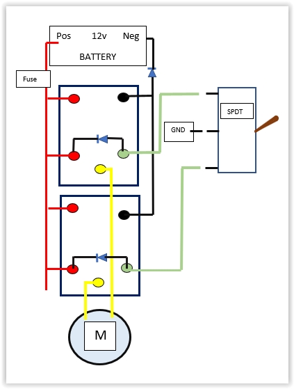

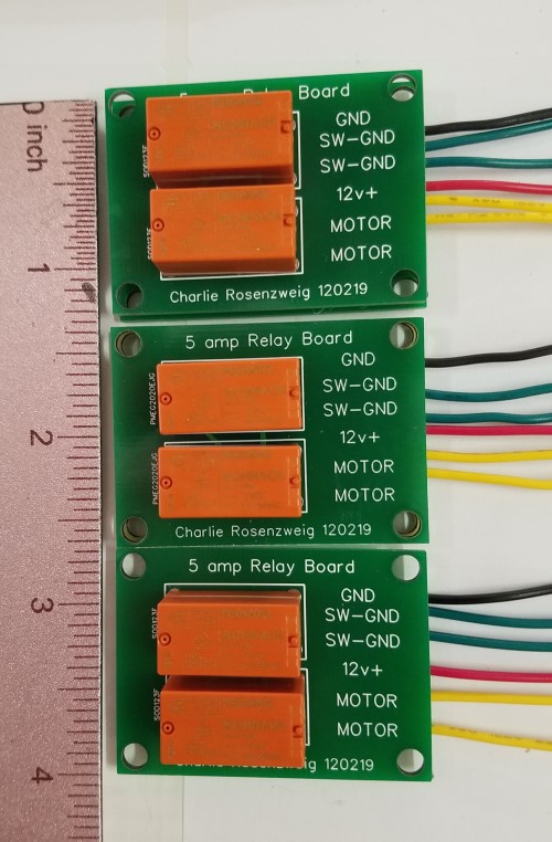

I am working on the electrical system and that includes the stick grip switches. I purchased the infinity Aerospace grips a long time ago and at this point I needed relays for Elevator, Aileron and flaps.
I found a diagram that Bob Nucklos on the Infinity website that shows the components necessary to build your own relay deck. I thought it would be fun and an inexpensive project.
So I created my own PCB using a free tool called EasyEDA and then had the blank PCB built and added the components myself.
Here is a picture of the Trim Relay boards I built.
It is an ingenious system that allow the trim and flap motors to reverse direction by simply grounding two wires off the grip switch.
Here is the diagram in a simplified view.
I am willing to sell these for a modest cost if you are interested PM me.
Charlie

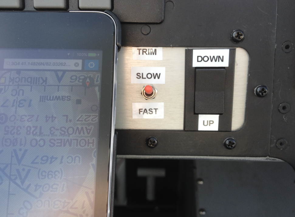

Charlie -
Are the trim motors adjustable for speed? I converted my RV-12 to Ray Allen with two-speed trim. Very slow speed in cruise and fast trim in slow flight in the pattern. Speed is selectable with toggle switch. Makes airplane a pleasure to fly...
cool

Charlie -
Jim,
I had not thought of that. Good idea. So is your "slow" equal to RA stock or is the fast setting equal to stock?
Charlie

Charlie, I do the same on my 7 and fast is full speed with the slow being set by a ray allen trim pot. I tested for a few months until I liked the speed then hid, ahh, errr . . . . relocated it behind the panel

Exactly... My trim pot is located behind the panel after I made final settings. Slow is really slow for cruise. RV-12 guys that fly my plane like the ability to easily set pitch trim at cruise speeds without overshooting. Trim speed for slow flight in the pattern is quite fast. Works very nice and feels natural as the plane slows down. Again - no overshooting. A side benefit is the ability to re-trim quickly in event of a missed approach and go-around.
Another thought - I don't know if you would use two speeds for each of the three axis (I suspect you would). In that case, use a single toggle switch to operate a relay with three sets of contacts - one for each axis.

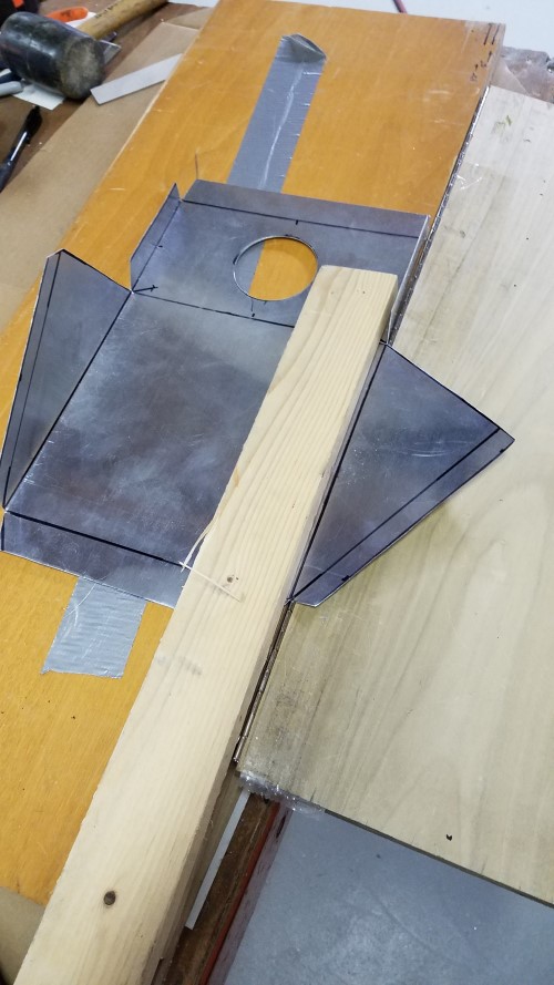

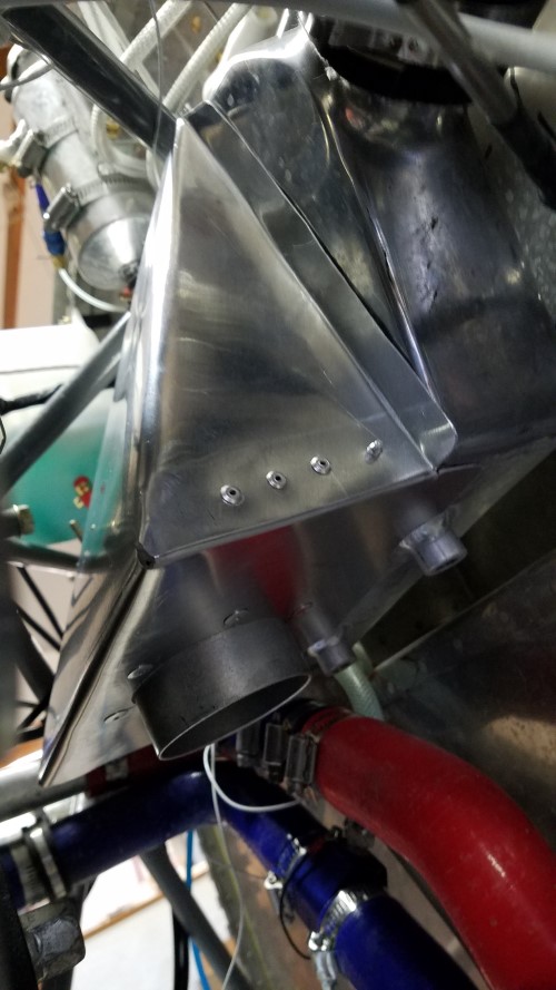

intercooler shroud

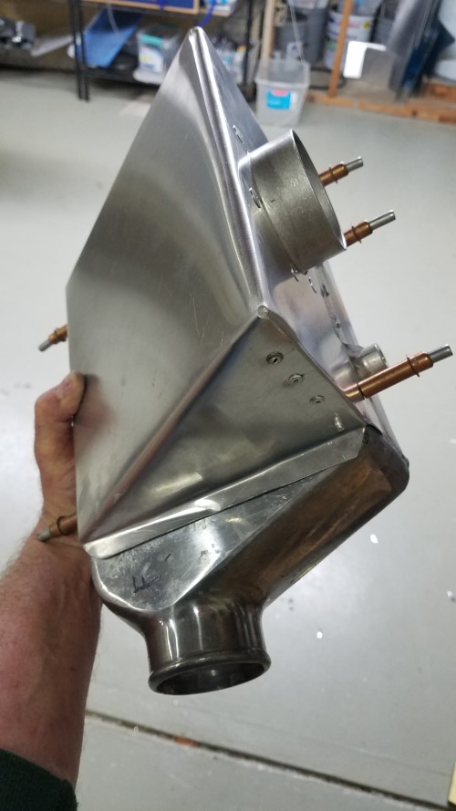

I had a chance to build up a simple shroud for my intercooler. Here is a pic of it.
Here is how it looked in the pattern stage. It is 0.25" aluminum. I actually like the 0.025 aluminum sheet found in the aviation section at Lowes for pieces like this. I find it is easier to bend that 2024-T3. The next picture shows it on my DIY wooden sheet metal brake I made out of old hard wood maple doors and a hardware hinge. Works real good. I do find it helps to duct tape the piece in place. Keeps it from creeping while in the clamps. With metal this thin you can simply hold the metal or wooden brake by hand while it is being bent.
Here it is attached to the intercooler.
The only down side to this set up is it did not allow for a nice outlet that is plumbed to a negative pressure area. While this would be ideal, I am going to wait and see how well it works as is. I have seen very nice temp drops with the intercooler on the test stand with no shroud at all, so I think my IAT (inlet air temps) will be reduced at least as well as what I saw on the test stand (60*F-80*F) and probably much better, and if that happens this will be more than enough to get me where I want my IAT to be. Given that very small amount of boost I plan to use <7lbs This should do just find.
Charlie

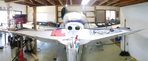

fuse on stand for wing fit
Things are progressing well.
It was time for me to fit and rig the wings. I have had them on the Fuse before but not to set the incidence, sweep and install most of the bolts for a true test fit. (as you can see in my avatar....

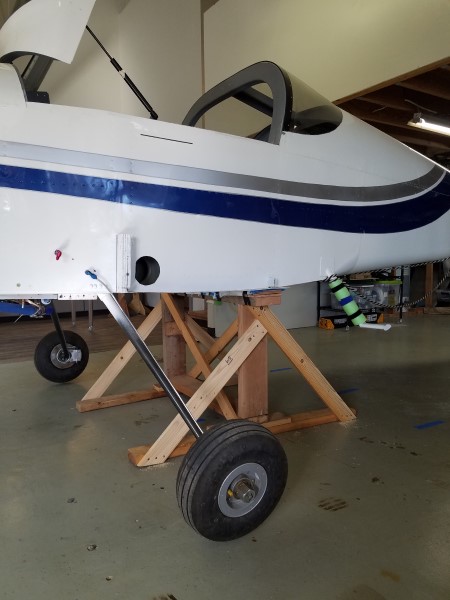

To do this you have to set the plane up on a stand without the main wheels. This is because the main wheel gear leg on a "-A" are attached directly to the wingspar.
Here is my fuse on the stand ready for the wing fit, which I hope will be Saturday.
Charlie

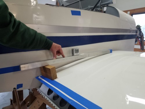

Here is a pic of me setting the wing incidence. After reading the manual I sought out to do things with various priorities in mind. 1) Watching for proper edge distance on drilling rear spar tabs. 2) Making sure the wings were true to each other. 3) being true to the longerons. Using a digital scale with many reference checks I was very happy to get the wings at 0.00 degrees to each other and within 0.44 degrees true to the longerons. The edge distance was no issue at all.

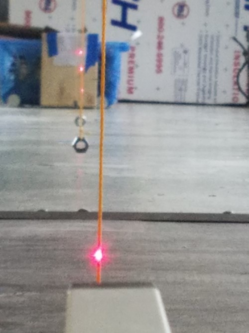

I also was very happy setting the wing sweep. The manual says withing 1/2" is allowed. I dropped the 4 plumb lines off the forward edge of the wings per plans and shot a laser across them. The laser hit all four lines. Probably about 1/8" tolerance at the end of the light. Good by me esp knowing this is a slow build before all the wonderful pre-punched holes.
Here are some pics.
Here is the laser shot:

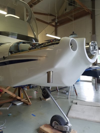

update turbo exhaust exit
Things are progressing quite well.
I finally made a decision on which way I was going to have the exhaust exit the cowling. This was a bit of a big decision for me, only because once you cut a hole in that cowl you are committed.

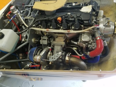

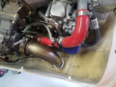

So here are some pics of the turbo exhaust exiting the cowl. Also a view from the top.
Side view
Top view of exhaust exiting cowl.
Overall view of engine of top view.
I hope to have things ready to make the move to the airport in 3-4 weeks.
I fortunately have lined up two CFI for some refresher training too.
Feel free to ask questions .
Charlie

I wonder how hot the exhaust is after the turbo? A lot of energy gets used up spinning the compressor.

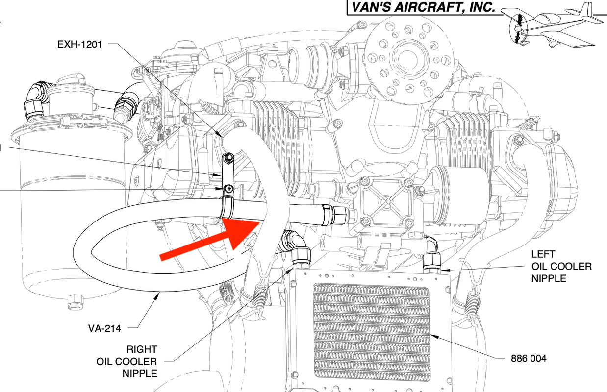

Not quite the same thing: The RV-12 has a flexible oil hose passing thru exhaust loop of right front cylinder. The hose is held away from the hot exhaust with a minimal hanger strap. I always shake my head at that decision...
Jim
I really have not ran the engine long enough at high manifold pressures to give a meaningful temp. But my recollection is 1300*F for a ball ball park number
