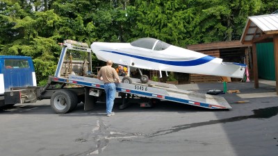

The BIG move
A little over a week ago we made the BIG move to the airport. I had contemplated doing this a lot of different ways and ulitmately decided to hire a flatbed tow truck as you will see in the photos.
It turned out to be a real smart move. The width of the landing gear fit perfecdtly inside the rails of the bed of the truck. Plus, the owner operator was a real professional who had just the perfect gear to snug it down very securly for the 50 minute trip.

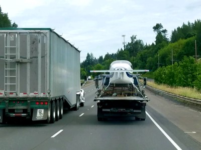

Here is another view that my wife took as we followed the truck up I-5. It was actually quite uneventful - thankfully!

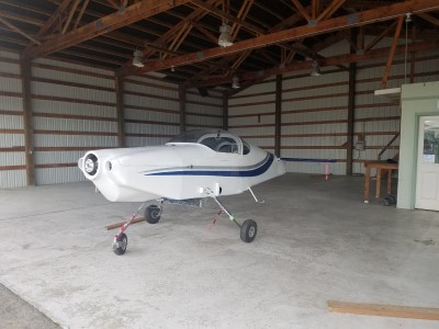

I think I previously reported a heck of a time finding a hangar to rent. I finally found a 1/2 share of a 45' x 45' hangar at KTDO. It really turned out to be a super way to go and I am very thankful to have it.
Also, one point worth noting is that I struggled with the best idea on how to attach the lines from the tow truck to pull the plane up on the deck. I ended up using swimming pool noodle foam (that I bought at the aviation section at a local walmart) and cut them lengthwise and secured them above and below where I tied a 1/2 poly line that the tow truck could attach to. This proved as an excellent method. The foam kept the attachment from sliding up or down the gear leg and kept the line low enough so that it did not interfere with the cowl. I did not have anything attach to the nose gear. It went on great with zero difficulties.
There will be many trips to bring all the rest of the pieces and parts and tools to put this puzzle back together.

W+B done 1036lbs 71"
We did the Weight and Balance today. It was - mostly - good news.
I came in at 1036 lbs with a C.G. at 71.4".
Considering I am in uncharted waters with a never-before-tried engine, PSRU, Enging mount, liquid cooling system, etc, etc. I am happy with the numbers. If anything, the engine is too light!
For those of you who are RV6A guys, you will see the C.G. is a bit on the "AFT" side of the world. I did a full weight work up and I am still "in the box" at 76" but real close to the aft limit which is 77". With very low fuel, and 60 lbs in the baggage area I am at 76.4". I was a bit concerned that the cowling I made was on the heavy side, but now I am glad I did not make it any lighter. Of course there are a few creative things I could do to move the C.G. forward but at this point. It is good.
*** Updated. The full weight configuration was configured in the worse case scenario, certainly not what it will be during phaseI. Configuration during phaseI puts the C.G. at 73.2" which is very good. I add this because someone has thought I would be at 76.4 during Phase I which of course that will not happen....Just for clarification).
On a side note, I am 12 lbs heavier on the right tire than the left. I am sure this is for two reasons. The turbo is on the right, and the panel is heavier on the passenger side. Considering if I fly solo and/or that my wife is lighter than me, it is actually a "good thing" that the right was the "heavy" side and not the left.
So for now I am good with it. It is not "ideal" but it is good.

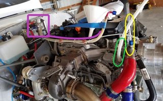

Filling the coolant.
As I continue to get the plane back together after moving to the airport, one of the unique aspects is to properly fill the coolant system.
Every liquid cooling engine system is different and I have learned how essential it is to get all the air out of the system.
For this set up I have learned that it works best to disconnect the large hoses (cool side and hot side) disconnected up near the Cyl head. Once those are full then I attach them and leave two ports open on the head. One was where the original OEM temp sensor was and the other was a small line that went over to the TB.
I am going to try to attach a picture here using a new method since HALIE seems to no longer bee working.
and......
(the embedded image was done using postimages.org - do not confuse with postimage.com)
There are 3 colored circles and an violet colored lines. Here is what those represent.
Yellow. This is where the OEM temp sensor was. Notice the extension on the port. This is only attached when filling. Once the air is burped out, I cap it off.
Green. This is where the coolant line for the TB was. I also cap this off when done filling the syste.
Violet. This is the aftermarket catch can that "catches" any bubbles left over. Notice the reinforced silicone line that goes from the thermostat housing over to the catch can.

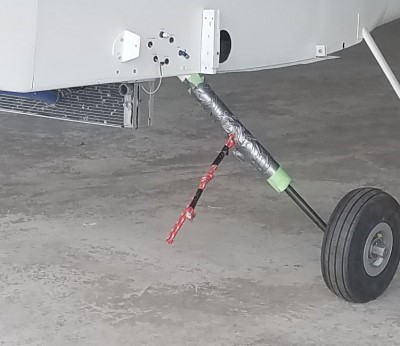

One thing that stands out to be is how "sqatty" it is. Quite tail low. I put a 1.5" thick board under both tires and it is still quite squatty. I have always known the -6 still low compared to the -9 an -7 and I don't like it.
It makes for poor visibility. on landings. Larger diameter tires would help in several ways. 1) More stability, wider tires, stronger tires. 2) Better visability over the nose. 3) better larger brakes. Tires are actually cheaper too. The down sides are reduced speed, and some added weight. I care more about better visibility and stronger breaking and stronger tires than I do the reduced speed and increased weight. So I am 98% sure I am going up to 6.00x6 tires on the mains. I know this is unusual for a -6a. But the -6 guys do it all the time. I set it up this way and put a level on the longerons and it takes me from 5.2 degrees tail low up to only 3.7 degrees tail low with a 1.6" lift that I expect I would get with 6.00x6 tires.
Just food for thought....
