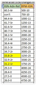

The more I think about my "stumble" I reported, I am suspicious of (pre) detonation, which of course is critical. But, in hind sight, it happened at the end of a full power climb out, where temps are at their highest. It also went away as soon as I lowered the nose, and reduced power. It might have been the knock retard feature kicking in. I really don't know, I can tell you when that happened (at 500agl I was not focused on intake air temp or knock retard). Ill be pulling the plugs tomorrow to see how they look. My intake air temps have been very low since adding the intercooler. About 10-15 above ambient. But that was at lower power settings on the ground.
I do not have a dedicated source of cold air for my intercooler. So there is a lot of room for improvement in these areas.
Next flight will be a bit lower on the throttle esp on climb out. Probably 4200rpm.
I will keep folks posted on the progress.
There is pre-ignition and detonation but no pre-detonation.
If you had pre-ignition, you'd likely have no ground electrodes on the plugs and quarter sized holes in the pistons in less than 10 seconds.
To minimize the chances of detonation, restrict the total ignition timing to about 25 deg at TO and climb power on 91 octane. With 100LL you should be able to run 30-32 safely. Ducting the intercooler properly will give you increased detonation margins as well. Try to avoid IATs over 160F.
Other possibilities are the AFR is too rich and you're getting into the rich misfire zone.
For now, good to keep climb power at or under 35 inches until you get more experience with the engine.

Ross,
I will attach a screen shot of (the top) of the ignition curve. It is as you suggest. Limit at 25degrees - but - with a 1-3 degree retard as MAP goes above 31 inches.
I have not seen any intake air temps above 130. But I will watch that more closely next flight, esp on take off.
I always use 92 octane.
Good, this is even safer. Watch too little timing, can cause high EGTs though. You'll be down to 18 at high rpm and high MAP.
