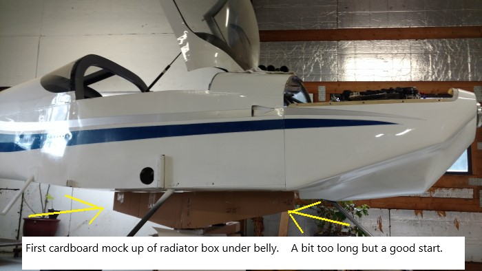

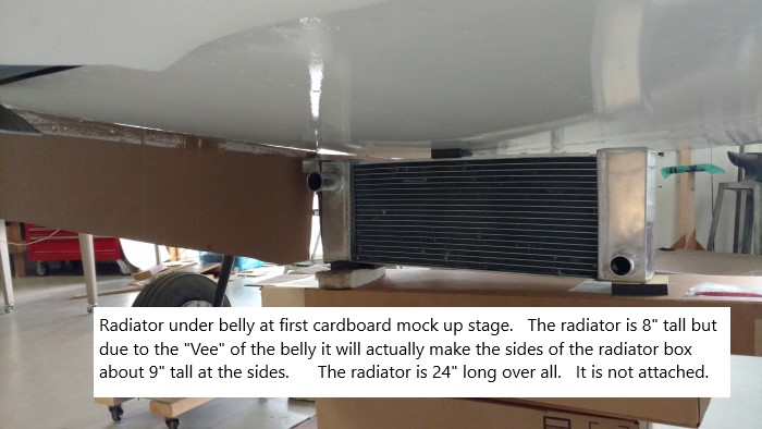

New pics on radiator belly mount mock up
Below is a test fit of the radiator under the belly both from the side and the front. It is bit hard to see but the first pic is from the side and shows a carboard template of how the side of the box that the radiator would be housed in.
Truthfully, it is longer than I think I am comfortable with. Ross if you read this can you share how long your box turned out to be - front to back? I think this is roughly 42 inches total front to back.
The next pic is of the radiator positioned under the belly. It is just held up there on cardboard boxes.
The last post would not take the other pic of the radiator under the belly so let me try it again,.
What do you guys think?
Do you think the side view of the cardboard template shows a box that is too long? Personally I am leaning towards shortening it up 4" to 6"
More pics to follow.
Charlie
I'll measure mine tomorrow. You can shorten the aft part behind the rad as the air won't separate as it converges.
Ross, thanks. Thats very helpful. But it also surprises me..
I think it's because yours has the nice contours and my sides will be straight tapers that mine looks longer comparatively. I measured my cardboard template and it was 48".

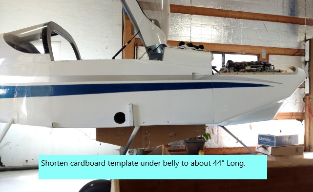

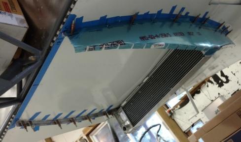

Pic of shorten cardboard mock up.....
Charlie
I am leaning towards 4"H x about 18" wide for the inlet and about 5"H x 18" outlet. The outlet will not have a swing ramp to vary the outlet. If it cools too much I may consider adding an adjustable flap up front, but that will be put off for quite some time after much testing.
Feel free to comment on the plan...
Those are very large areas, both inlet and outlet, in particular given the theoretical higher efficiency of a water to air exchanger. And closing the inlet in order to to throttle flow would be bass-ackwards. You want to throttle the exit. "Swing ramp" sounds right.
Before going too much further down this path, are you sure you can't move the exchanger(s) inside the cowl? Most sport airplanes get real slow with something the size of a garden wheelbarrow strapped to the belly. You're a good fabricator; treat it as a challenge. Heck, Eggenfellner did it with the Subaru packages, and I note SARL racers with nicely integrated water cooling.

You shouldn't need more than 25 square inches of inlet area with a proper duct shape to cool 180hp in flight. Extra area may be beneficial in ground cooling. With extra inlet area and a movable exit door, your cruise drag penalty is probably slight. Lots of compromises involved here. Certainly you don't want to overheat on an 80-90 degree day with a long ground hold somewhere.

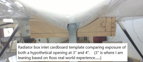

I thought it might be help or of interest at least to most people, what the cowl bump and its relation to the belly inlet looked like so here is a pic.
Notice on the cardboard template there is a line at the bottom marking where a 3"height would take the inlet as compared to the template itself which is 4". Based on Ross' real world experience I am leaning towards making it 3".

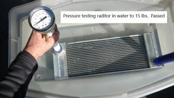

Here is a pic of the radiator submersed in water where I pressurized it to 15 lbs. It passed with no bubbles.

I've been dead serious. The proposed inlet and exit areas are excessive, throttling the inlet would be a technical error, the additional frontal area adds external drag, and it's not going to be pretty. I don't believe in being critical without proposing solutions, so I've linked photos of other liquid cooled aircraft, proposed ideas, and explored details. You're under no obligation to consider any of these things, but they are legitimate commentary.
On the inlet sizing question, assuming you have the rest of the duct/ diffuser shape and rad sizing correct, experiments by Russell Sherwood have shown that he can cool 230hp with less than 15 square inches of inlet area. He said he'd go down to 12.5 if there was another iteration in the future. It does look like ground cooling is impacted somewhat by reducing the inlet size so be careful there.
On my installation, the main rad inlet is a lot bigger than that primarily because I couldn't get my hand and wrench in to access the bolts which attach the splitter to the rad and would have had great difficulty in laying in the glass and resin if it had been smaller. As you shrink the inlet, the diffuser shape and guide vane placement become more critical to make it all work efficiently so that is a consideration too.
The penalty of a slightly oversize inlet is minimal from what we know as long as you can throttle the exit.
This all being said, none of us want to re-do a rad scoop design which doesn't cool adequately in the climb or on the ground so we tend to fudge the rad and inlet sizes upwards.

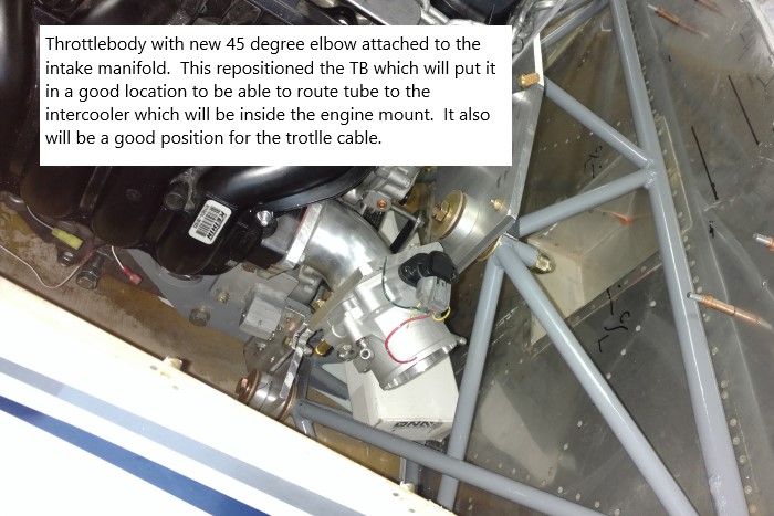

New TB mount
Attached is a pic of the new adapter I had made up that repositioned the TB so it will fill well in the cowl. There were several factors that caused me to chose this. One being the location of the exit of the turbo, second my desire to try to get "straight on" air flow to the intercooler, and of course the challenge of obtaining a smooth travel for the throttle cable. Given these factors this seemed to be the best choice.

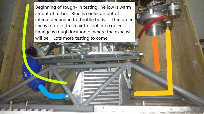

Rough in test fit of intercooler routes
I am doing some initial testing to try to find the best location for the intercooler. It is important to know that the intercooler orientationn as seen in this pic probably not going to end up as you see it in this pic. But I thought it would be interesting for some to see the beginning stages of where and how the intercooler will be plumbed. I also have two intercoolers and may use the other one and may even modify them as needed.
I am trying to get it so it will be "straight on" to the air that will be routed to it in cat hose. Which means it may be vertical. Of course this will also depend on how well this interfaces with the tubing that comes from the turbo.
One thing that is important to know when looking at this is that the exhaust will be where the orange line is. I noted that because many would ask why I did not consider this location for the intercooler.
Others may wonder why I don't put it forward on the left side of the cowling. One reason is that it would be a long haul for the charged air to get there and then back to the TB. The other is that it would be tough to get "straight on" flow to cool it.
Lots more testing fitting to happen before final decisions are made.

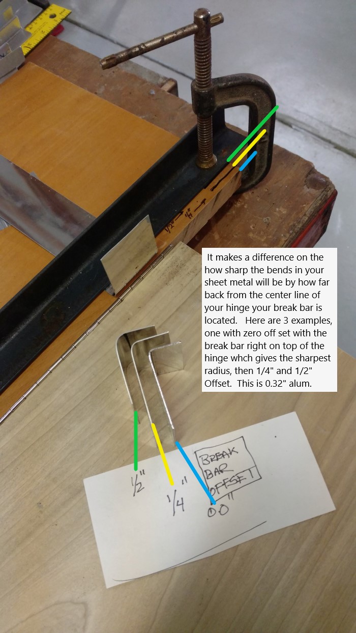

Sheetmetal break examples
Many of you will already know this and may have additional helpful hints to add, please do so...
As I begin to fabricate the aluminum sheet box (Belly scoop) for the radiator mount, I wanted to do some testing to get the right radius of bend. I will have to keep it fairly sharp due to the bottom of the radiator is square and the metal will be tight up against it.
I made my own break with a couple of pieces of straight and flat wood with a simple hardware store hinge. I use a 1/8" angle steel with 1.5" x 1.5" sides as the "break" to clamp down on the metal to keep it secure while it is being bent.
You will see in the pic below (I apologize it is quite big, there is detail in it that I wanted to make sure was fairly easily recognized) there are 3 test pieces with various radius curves. You get a more gradual bend if you set the "break" bar back from the hinge. It is hard to see in the pic but if you look close at the right side at the end, you will see a line labeled as "1/4" and another "1/2". Below you will see the results of the test. The sharpest was done at zero, the next at 1/4" offset and the last at 1/2" offset.
Also notice the bottom board is longer than "tilt" board - This is important so when you bend the sheet you can go past 90 degrees without hitting the clamps.
i made a welded 26 gallon tank for my 12 and i made the bends for the flanges and short bends. for .062'' 5052 the book says 3/16'' radius [i think]. i took 3/16'' steel bar stock 11/2'' wide and with a bench grinder and belt sander i did a pretty decent job of rounding the edge. i set this bar back at least the thickness of the sheet metal from the edge where the brake bends. 5052 is a little softer but even with 2024 and 6061 i get real nice bends, no indication along the bend that the sheet metal has been weakened. i use this bar for all my bending.
Bob, Thanks for sharing. Your set up sounds better. If I would have had that thick of a piece that was long enough I would have done the same.
If you have a pic of that rounded edge feel free to post it here.
Charlie.
It is easy to make inserts of varying radii to use in a traditional (sharp nosed)
or home made bending break.

Scott weird you mentioned that. The general concept ran through my mind but I had never done that or seen it done.
Thanks for sharing, I sure people will try it. I will.
Charlie

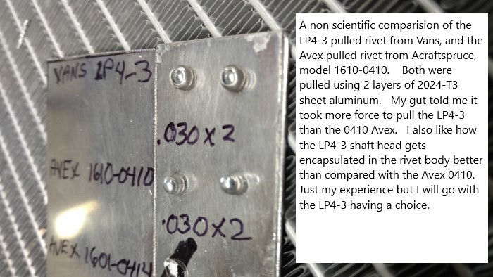

As I venture towards the fabrication of the radiator belly scoop I am revisiting my supply of pulled rivets.
While driven rivets are certainly stronger, there are a wide variety of pulled rivets to consider.
I personally like the LP pulled (blind rivets that Vans sells, but I know there are a lot more rivets on the market and it can get confusing. I am certainly no expert but I thought I would share some of my observations.
One thing that is often noticed is that some rivets are sometimes labeled as "non-structural". There are design features that dictate that label including body alloy, shaft alloy, head shape, and stem shaft retention. The one feature that seems to stand out more than others though is the length of the remaining portion of the stem shaft. Does it break off at the "top" of the head, or considerably lower in the bottom of the body.
The best example of this is when you look at the Cherry "N" rivet verses the Cherry "Q" rivet. The Cherry "N" stem breaks off low in the finished body and does not transcend the line where the two parent metals are mated. Hence it provides no extra value in shear tension. On the other hand the Cherry "Q" stem is designed to break off up high towards the "top" of the head of the rivet after being pulled. This results in the stem shaft transcending across seam where the two metals are joined and offer additional strength for the rivet especially in shear.
This is why you will see that the Cherry "N" rivets and the "Q" rivets have virtually the same strength rating in tension, but the "Q" is almost double in strength in shear.
Here is a quick test I did comparing the AVEX 1610-0410 rivets with the LP4-3 rivets that vans sells.
The strength of the AVEX 1610 series is well advertized but I have not been able to find the strength of the LP rivets. (Scott if you are reading is that something you can share?)

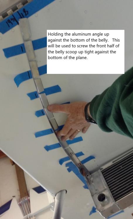

beginning of the belly scoop
I thought I would share some pics of the beginning of the fabrication of the belly scoop. It will be mostly 0.032 - 2024-T3 sheet aluminum. Something I am comfortable working with.
The angle aluminum 0.63 6061-T6 angle that will be rivets to the bottom of the belly of the plane.
And a pic of the side panel that will be screwed into the angle aluminum at the top. (the blue color on the aluminum sheet a the protective plastic coating).
Charlie - The LP4-3 rivets on my RV-12 are manufactured by Gesipa and are the PolyGrip - MultiGrip series. According to factory specifications from the Gesipa catalog .... Shear =162 lbs. Tensile = 236 lbs.
