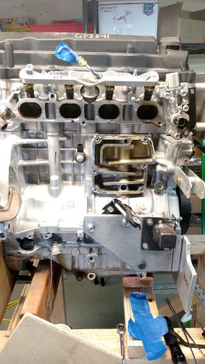

Tom,
I did look back for the early pics and found these two, not sure what you are looking for but this is about as early as it gets....

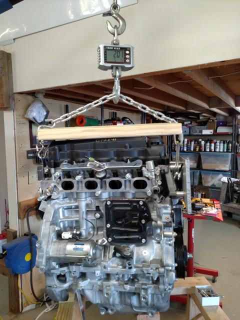

Here it the weight of the longblock- including the starter of course.....

Tom,
This one shows the internal oil separating channels that are normally covered with a plate...

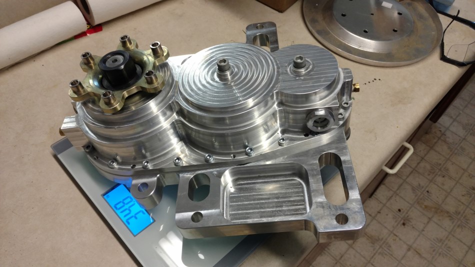

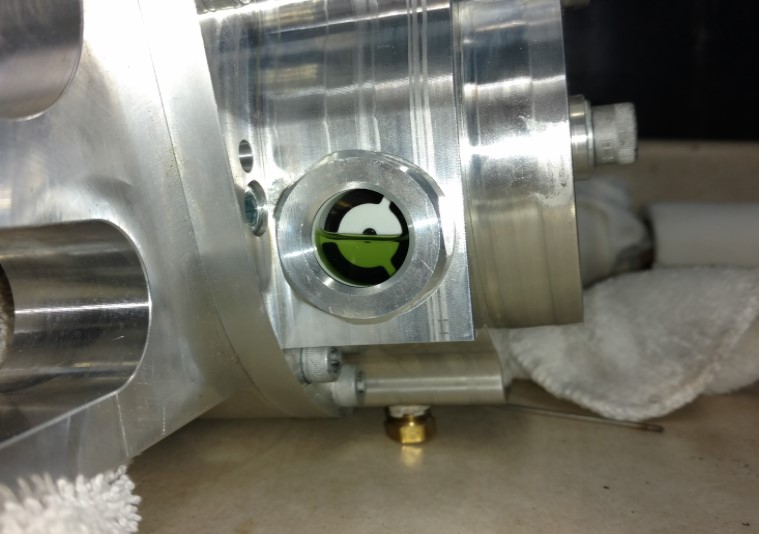

I promised that I would get some pics out on the new "Turbo" PSRU. I have not installed it yet. I have been too busy welding on the mount. But the mount is done and I got some time on the new pics.
Here is an overall shot with it on the scales. This includes oil.
Here is another one of that site that shows the oil level.
I am very happy with this PSRU and Jan has been very good to work with. I want to make remind folks that I am only using the Viking gearbox and not his engine. In case some may want to caution me about Jan at Vikings past, just know that I am very familiar with it. It is what it is.
