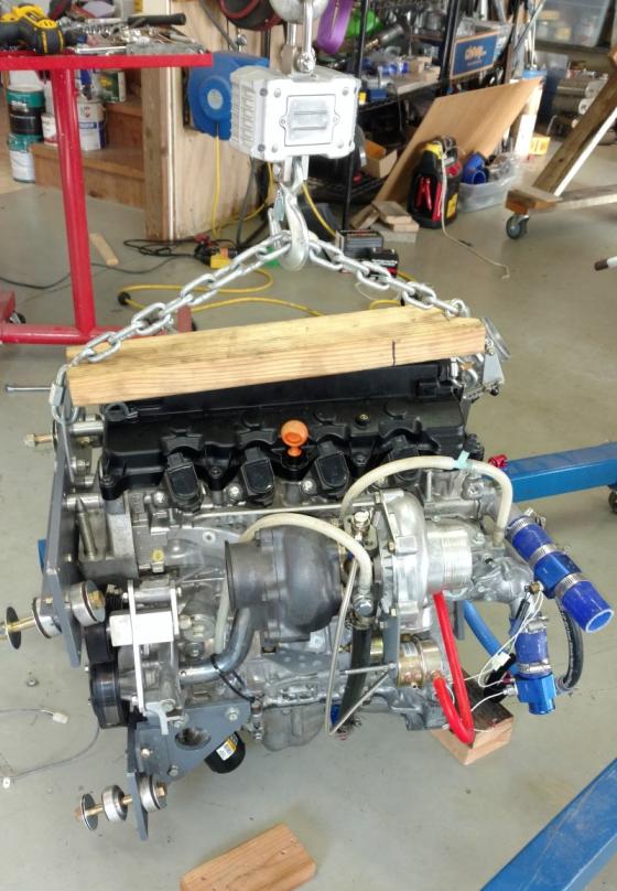

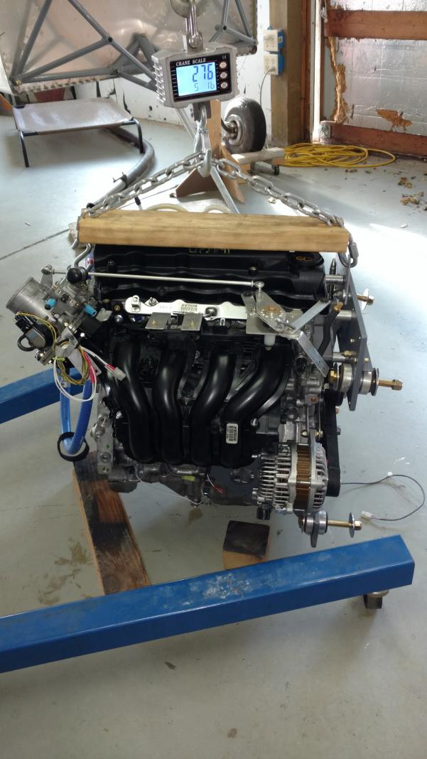

New custom mount installed
I tig welded the new mount and now have it installed on the RV6A. Most of the components have been removed during the move from the engine stand to the airframe.
There are 2 pics below.
This link below is of the engine on the mount on the RV6a.
http://www.halie.com/oP3.jpg
The next link below is view of the mount before the engine was mounted to it.
http://www.halie.com/oP4.jpg
I sent back the "standard" duty gearbox to Viking Aircraft Engines so I could upgrade to his "turbo" heavy duty gearbox. I hope to have it in about a week.
Ill be anxious to see how well I got it properly oriented in the Yaw, Pitch axis as it relates to the air frame; as well as centered to the cowling that I had previously made (from scratch) for a different engine installation I had planned. I'll have to wait and see how that actually turns out when the new gearbox shows up. My rough install showed I was 3-4mm off in the yaw axis but I am OK with that. I can correct that with a washer on the mount.

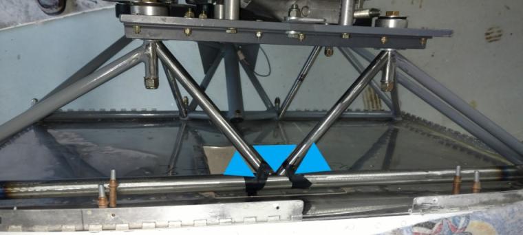

.... in that each of the 4 main points of contact are triangulated from 2 separate points with 4130 tubing that is size equal to or greater than these mounts.
Which brings us to the crux of the problem. Using two points to fixate a third point only works in two dimensions. Put another way, it constrains the third point only within the plane formed by the points.
In addition, it appears you're treating the mounting plates on the back of the engine as truss elements. Can't do that, given rubber between the plates and the other elements.
The lower mounts and landing gear tube illustrate both issues. Assume force 1 is applied to the landing gear socket, as it would be when the nose wheel is in contact with the earth. The result is force 2, pushing points A and B outboard. The gray aluminum mount plate cannot constrain force 2 in any significant way because of the rubber mount donuts. Nor is force 2 constrained by triangulation to points C and D, or to E and F. Using one side for illustration, force 2 is outside the plane defined by A-C-D, by nearly 90 degrees.
One possible solution would be the addition of three tubes. Again using one side for illustration, the addition of tube A-G completes the triangulation of point A; consider A-C-D and A-D-G. Tube B-H does the same on the opposite side. The presence of A-D-G and B-H-F means Tube A-B is not strictly necessary, but I'm pretty sure it would improve stiffness.

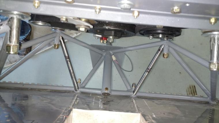

The pic you were using was of the mount before it was finished. (I actually did not remember post it.)
I have added more support and I will post pics of the updated mount soon. I hope I get enough time out in the shop to at least get the changes tack welded. But it may be next weekend before I get time to share more pictures.
In short I have added more support to the top to take lateral (roll axis) force, and I could easily add that lower #2 cross tube to relieve lateral stress on the two lower bushings from the nose gear. Vertical pressure in this area is well supported with the members that go upwards.
I know. That's why I did not comment on the upper mounts. All comments dealt with the lower mounts and gear tube structure, which appear to be the same in all photos.
....and I could easily add that lower #2 cross tube to relieve lateral stress on the two lower bushings from the nose gear. Vertical pressure in this area is well supported with the members that go upwards.

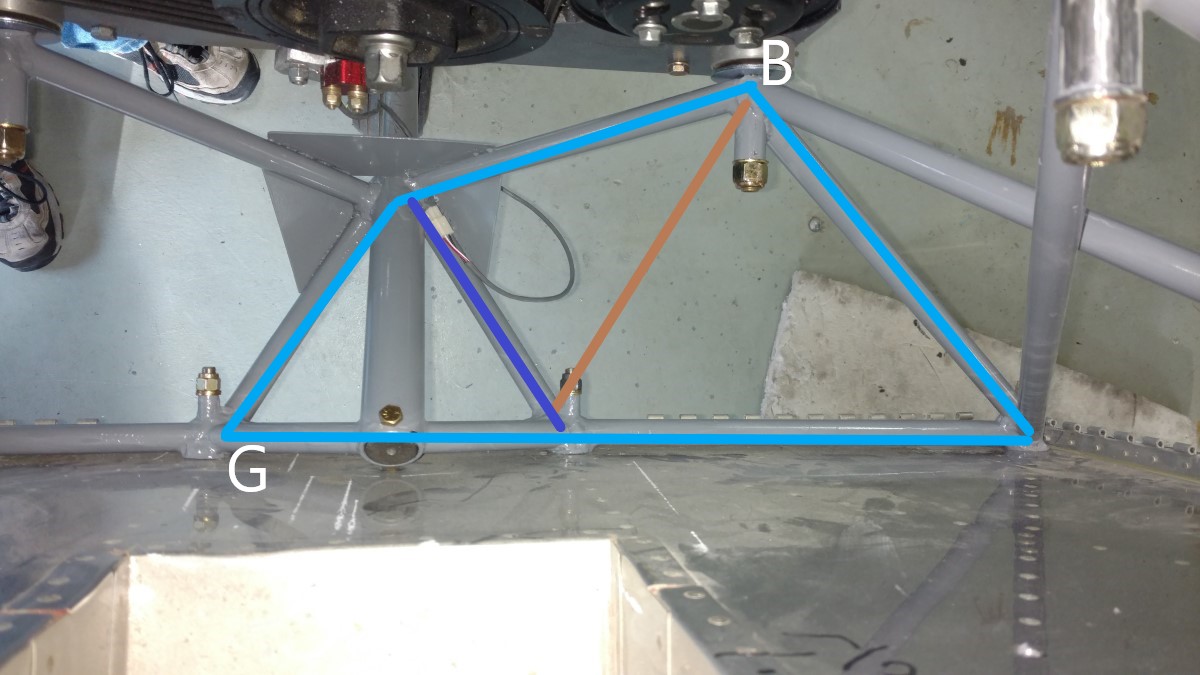

Proposed tube A-B, if installed alone, does not triangulate the mount points. Let's again look at just the lower part of the mount.
The mount plane we wish to triangulate is defined in red. The primary load of interest is transverse (side to side), as would be applied by at least three of the six available degrees of freedom, lateral, torsional, and yaw:
Here is that plane in planform, viewed from the top, looking down.
As currently configured (top), a transverse force applied at A or B is not constrained.
Adding tube A-B (center) constrains the gear load previously described as (2), but does not triangulate the mount points.
Instead, add tubes A-G and B-H (bottom). Points A and B are triangulated.
Adding tube A-B in addition to A-G and B-H (bottom right) adds stiffness when considering spreading load (2, illustrated in post 162) from the forward end of the gear tube. Without A-B, load 2 is reacted back to points D, G, H, and F, which is all that is really necessary. However, A-B supports that particular load directly; the short load path is how stiffness is achieved. Moving to detail design, tube A-B is mostly a tension member, so it can probably be reduced in diameter or wall thickness.

Here is a better view of the lower section of the mount. There has been some reference and diagrams to the the "A" and "B" points and I thought it would be good to see it from a better view.
Note there are three colored lines, light blue, dark blue and brown.
While I agree you can always add additional triangulated members such as the adding another member where the brown line is drawn. I did want to shed some light on the triangulation that exist in the sturcture by showing the light blue and dark blue lines.
Sorry the image is a bit oversize. I will work to get it smaller next time. Also, the point labeled "G" really should have been "H" but I know everyone gets the picture.
Charlie
One more time.
The tubes marked in red have nothing to do with triangulating points A and B. They support the gear tube, and rely on good fixation of A and B to do it well. To fixate A and B, you need to add members A-G and B-H.
You labeled G correctly.
I think we have kicked this can (lower mount support topic) down the road far enough that out of respect to those who want to keep up with my project I say we move on to some updates on the project. (But I will post some pics on the new members on the top of the mount because that got overshadowed and I want to circle back to it. But due to other commitments it will be a few weeks.)

New mount lower support members
Well I actually got time in the shop to day to add those A-G, B-H members.
Here is a pic. I know this will be obvious to many, but if you are new to the thread, I was encouraged to add the members that are the unpainted tubes. They are only roughed in. Not welded. I hope to get the welder next weekend.
Here is a shot of the roughed in new members on top. They are also only taped in place. The blue triangles are were there will be gussets.

Let's return to airplanes. First, thank you for reconsidering your lower mount triangulation. We all want you to succeed.
Now about those upper mount points. Previously we talked about how rubber mount points make the aluminum plate (bolted across the back of the engine) ineffective as a tension or compression member in a truss. Slobovian Charlie quite correctly noted that many mounts do depend on the engine to complete a truss, which is true. In fact, many don't even bother to create a truss. Although such structures may be strong enough to avoid the piranhas, they will exhibit low stiffness. Flexible structures are a wild card you don't want.
Like the jungle bridge, completion of the Warren truss requires one more member:
The gussets? Ditch 'em. Without the above truss member, they add little stiffness while creating a stress concentration. With the added truss member in place, they are entirely unnecessary.
The new bottom tubes look good.
I'd be concerned the top angled tubes meeting the middle of the unsupported lateral tube near the firewall won't be as stiff as if could be. Ideally, you'd have another pickup point there tied into substantial firewall structure, that being tied into the upper longerons. Since this is a lot of work, Dan's suggestion is an easier fix for less weight.

How much does it weight ?
One of the questions, I get asked the most is "How much does it weigh"?
While having so much fun with the mount I took the time to weigh the engine "as is". Some of you who have been following this thread will know that I showed a pic of the engine without any components, just the long block and I am pretty sure it came in at 201 bls.
Right now it is at 276 lbs. This includes:
1) T3/T4 Turbo and adapter mount plate. (Probably 16lbs +/- 2)
2) Alternator
3) New idler pulley.
4) Starter
5) Throttle Body
6) Intake
7) starter ring gear the PSRU mount plate
8) Top, Bottom, and both side mount plates
9) Misc stuff
For me, this is not bad at all. Here's the pic.
Here is the Turbo side as weighed.
Charlie
