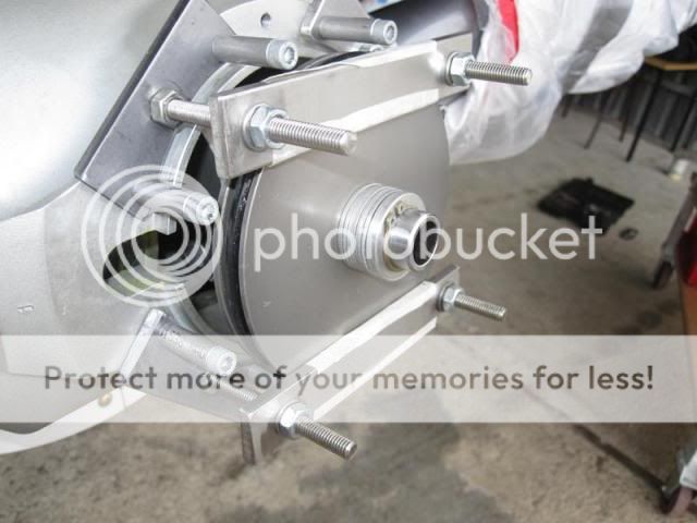

Could you post a photo or two on removing the hub and the shims within?

Here is how I did it, more work however! But can be done alone!
I fabricated some plates from flat steel (actually stainless steel) and used the original srews and aluminum spacers to mount them. On each of the four plates is a threaded rod which holds one end of two other steel plates. Screwing a nut down each a little at a time depresses the piston with it´s spring and unloads the shim pack. Now it´s easy to add or remove shims.

Unfortunately, I did not measure the original stack (3 washers) only what was added. Added a total of 5 shims, which I measured at approx. 0.030 each. Started with 3 at WW suggestion (picture above) and then added the other 2. The prop could probably use at least one or 2 more.
