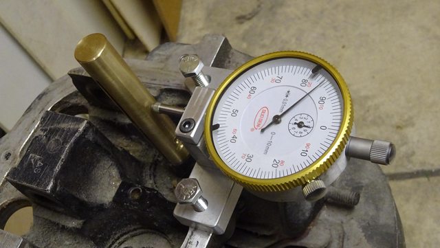

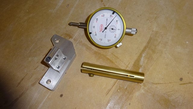

Had exactly the same idea and made my tool myself.

Do you have any drawings with dimensions for this tool that you could share?
Unfortunately not. I used an old cylinder to "design" the baseplate. Then I made sure that the dial gauge is at the prescribed height above the valve cover base. This dimensions are taken from SB388C. The "valve extension" is just a brass rod slightly larger in diameter than the exhaust valve, bored to accept the valve stem and sliced to be able to tighten it to the stem. Hope this helps.
If you aren't in a hurry, I can dig my dimensions up. It will take me a few days as things are kind of busy around here.....as always..... We just got a new FOOT of Snow here!

If you can send the dimensions when you get a chance it would be much appreciated. I currently don't have a cylinder or anything else to measure from, but I would like to fire up the mill and lathe to build the tool as I will be reacquiring a Lycoming to attach to my next project. I haven't used one since my R22 days, where the wobble test was required for 100 hr inspections, 30 years ago.
I will be moving all my tools to my new hangar at Pateyaviation.com when they get it done this fall. Until then, I have the resources to build the tool. Thank you in advance.
