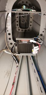

Trying to figure out what all I need wiring for in each wing, here's what I have so far:
Electrical/pneumatic:
• L/R - Wiring for wingtips (landing, taxi, position, strobe, area) I am installing the integrated AeroLED wingtips with all the lights in the tips
o 3 strands of AWG shielded wires
o Use Vans Conduit
• L - Wiring for pitot tube heating/controller
o Use center hole with grommets
o Mount to nearest wing rib
• L - tubing for Pitot/AOA sensor
o Use top and bottom holes with grommets
• L - Wiring for OAT sensor
o Left wing inboard-most access plate?
• R - wiring for autopilot servo
o Use Vans Conduit with opening
• ADAHRS??
• Magnetometer??
The last two are the ones I'm unsure of as to where those typically get mounted, in the wings themselves or out on the tips inside the wingtips?? Looks like I'm going with Dynon for the avionics.
Mount the ADAHRS behind just behind the baggage compartment up high. I used a piece of pre-peg fiberglass board to mount them. Access is via taking the baggage shelf rear bulkhead off. See attached photo. Magnetometer not required or desired (SkyView install).

I did basically what Carl did except I moved the ADAHRS back further to the front of the next rear bulkhead, in trying to keep it 2' away from the servo and any ferrous metal or possible magnetic field. I also put the OAT sensor about 6" below the H stab and about the same back of the leading edge. I installed it there on my 7 and it is accurate in that location and an easy run from the ADAHRS. (Dynon also)
If you’re using the Dynon stuff, I’d suggest you consider mounting the magnetometer in the far outboard bay of the right wing which keeps its wires away from the high(er) amp wires of the pitot heat controller in the left wing. The OAT probe can be mounted underneath the right wing out near the magnetometer. You can then plug the OAT directly into the magnetometer.
