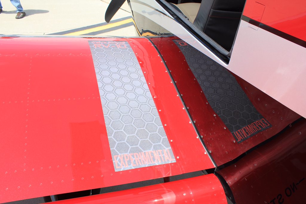

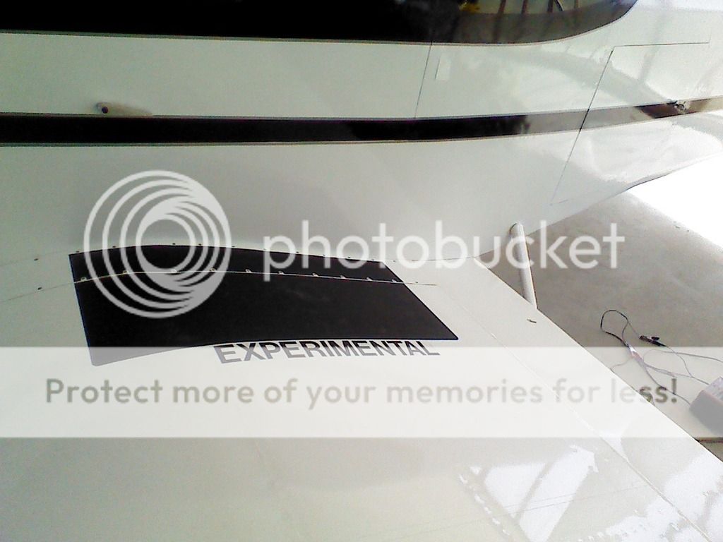

I had step off pads made up by a company named board pushers.com I put experimental down the middle with N789KD and RV9A at the top. They can make the pads to your design, colors, & lettering. The company make state board covers but the blank is rectangular and it works out great
