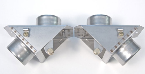

- You left out what I consider the major tunnel heat source, the cabin heat control valves. These valves get blasted with heat muff air when the valves are shut. The heat then conducts to the firewall and the tunnel. For this I place a piece of KoolMat between the firewall and the valves. I then extend the KoolMat over the top of the valve and down such that the not used hot heat muff air gets directed down toward the cowl exhaust - not just bounce back at the engine driven fuel pump.
- I do not consider the exhaust to be a major source of heat in the tunnel if using the standard exhaust setups.

Those valves will work fine.
I’m now working the firewall. I’ll have photos of the KoolMat install in a week or so.

+1 - Built to plans except for the spruce stainless cabin valves and the control approach pedals which add holes on the top of the tunnel.
No tunnel heat issues.
My opinion: the firewall insulation isn't needed to keep the tunnel cool. OTOH there are good reasons for it. It will keep your feet from getting charred, and reduces smoke from other stuff getting real hot, during the quick decent to the field in case of a firewall forward fire.
Stainless vents keep the flames on the other side. As Dan's work shows, aluminum doesn't hold up against an oil or fuel fueled fire.
