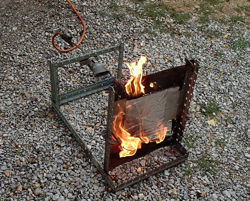

Ok, the rest of the story...

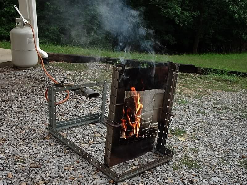

Some time ago Mike sent a sample of the insulation installed on the cabin side of his RV-10 firewall. It came to him via a third party rather than a vendor. Mike didn't know for sure what it was, and he had become concerned. Although I could not identify the brand with certainty, I was pretty sure it was a polyester fiber insulation similar to a sample previously tested, and probably the same as that involved in a recent RV-10 incident. I suggested he remove it ASAP.
This weekend my buddy Stan and I were standing around the shop enjoying a cool one after doing the sealant burn and I remembered Mike's sample, still in the envelope on the shelf. We walked outside, clamped it to a stainless panel, and hit the burner. This was 15-20 seconds later:
In this photo the burner has been turned off almost a minute. Consider how long that minute might be in the air.

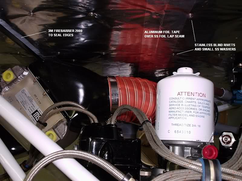

foil/insulator sandwich
The firewall perimeter got a filet of FireBarrier before adding the foil/insulator sandwich,
Dan, what product did you use for the sandwich? Engine or cabin side? How did you attach it to firewall?
On the engine side, I'd suggest ordinary Fiberfrax felt (available Wicks, Spruce, etc) under stainless steel foil, attached with SS pop rivets and sealed around the perimeter with 3M Firebarrier 2000. Common 24" wide SS foil is fine, actually preferred. Overlap a mid-panel seam about 2 inches and cover it with one strip of aluminum foil tape. In a fire the aluminum tape will melt away instantly and provide a directed escape path for the outgassing binder in the Fiberfrax.
On the engine side, ordinary Fiberfrax felt (available Wicks, Spruce, etc) under stainless steel foil, attached with SS pop rivets and sealed around the perimeter with 3M Firebarrier 2000. Common 24" wide SS foil is fine, actually preferred. Overlap a mid-panel seam about 2 inches and cover it with one strip of aluminum foil tape. In a fire the aluminum tape will melt away instantly and provide a directed escape path for the outgassing binder in the Fiberfrax.
Dan, What thickness stainless foil (shim stock) did you use? I'm thinking ~.003".

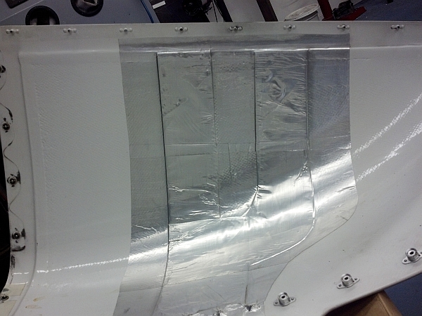

Any thoughts to using Vans heat reflecting material over the fiberfrax as a low cost substitution of stainless steel?
Any sort of shiny metal film over fiberfrax will reduce heat engine transmitted to the cabin during normal flight. An aluminum foil, however, would be totally useless as a fire barrier. Seconds after application of the standard 5" x 5" 2000F hotspot, the aluminum will evaporate. Then the binder will burn out of the fiberfrax, and airflow will blow the loose fiber off the firewall.
The link you provided does not specify what type of metal the heat reflecting material is.
Yeah the Vans website does not say what it's made of. It's intended for under the cowl. I just saw how cheap it is and was wondering if it could work in this application. Dan's assumption that it aluminum is probably accurate due to it low cost.
It's aluminum. Works great over fiberfrax to protect fiberglass and paint.

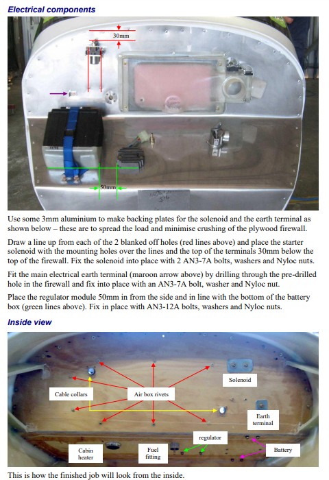

Ok, so there was an ignition source (a hot battery) on the engine side of a firewall. The question investigators fail to ask is how did a hot battery result in open flame on the cockpit side of the firewall?
The J170 has a firewall assembly typical of composite aircraft, a bonded-in plywood core faced with a ceramic fiber sheet (fiberfrax) or similar, then covered with a stainless steel sheet. Here's a link to the construction manual; check pages 45 to 53:
https://jabiru.net.au/wp-content/uploads/2018/05/Jabiru-J170-Constructors-Manual-WEB.pdf
I've never burn tested a SS/fiberfrax/plywood assembly, but I suspect the bare stack-up would do moderately well. The problem is practical detail. As noted in this thread and elsewhere, steel fittings and bolts are both capable of point heating. They can glow red and transmit (by conduction) more than enough heat to provide an ignition hot spot.
Look at the photo at the bottom of page 53, a view of the cabin side after installation of all the bolts and fittings:
Now jump to page 234:
Yes, that's foam insulation glued over all those ignition point sources.
Folks, I cannot absolutely state that in this case the fire transfer mechanism was hot battery-->hot hardware-->foam ignition. We just don't have enough information, all too typical for an EAB crash report. I have watched bolts glow red in an otherwise relatively cool firewall, and if it walks like a duck and quacks like a duck...
