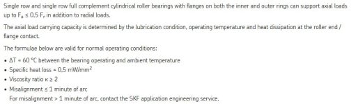

If you float the segments and the pinion drive flange, the drive flange could strike the back of the gearbox housing when running.
Odd. The Viking video linked earlier shows the driven flange seating against a step on the pinion shaft (video snips below). Press fit or slip fit of the spline would make no difference in terms of clearing the gearbox back plate. That clearance is a function of where the step is machined on the shaft, and the axial position of the shaft in the gearbox...
The other part of the puzzle is the pinion drive shaft moves forward a bit as the helical gear in the gearbox loads...You can plainly see the movement in this video as the prop loads and unloads.
...was was apparently kinda iffy.
You're certainly wise to keep an eye on the axial freeplay dimension shown in your video. The shaft and flange is hammering fore and aft every time the system passes through its first natural frequency, at a rate equal to that frequency.
BTW, what is the first resonant RPM with the existing cut coupler?

Got thinking about John's video showing fore and aft freeplay at the input shaft. As he noted, it would cycle through a fore and aft motion at every torque reversal.

I believe it is this bearing from SKF
I dont know if the lubrication oil qty and temperature comply with the requirements, but as mentioned in the text under the right conditions they can support up to half the radial load in axial load. The Hubelbank gearbox that had 800 hours on it did not show a collection of fine metal from bearings and one cannot see any visible wear on the rollers yet.
While I dont agree with the choice of bearings or the way there very poor control of the axial position of the shafts, that does not have appeared to have been a factor in the 2 failures that I investigated. The prop shaft bearing is simply held in place with a snap ring, which is obviously not a zero clearance setup.

...but as mentioned in the text under the right conditions they can support up to half the radial load in axial load.
I will give you up to one million dollars...
While I don't agree with the choice of bearings or the way there very poor control of the axial position of the shafts, that does not have appeared to have been a factor in the 2 failures that I investigated.

Hate to harp on the subject; but,
I can't help but think the previously listed literature's reference to the roller bearing supporting up to half of the radial load in thrust would be for a transient condition. What reputable bearing supplier is going to accept constant sliding contact as a design parameter? Angular Contact ball bearings are specifically design to support both loads. Roller bearings are typically applied on mechanisms that have very high radial loads (and limited support axial length).
Secondly, a bearing installed on a shaft without an interference fit/relying on a snap ring? I guess fretting wasn't a concern and things only get worse after that starts. The lack of proper application here is truly astounding. "It turns the right speed and direction and we found a way to mount it."
