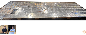

If you keep that in mind, then the graph with the error bars (also attached a screenshot of that below) basically says that LCP are superior from a fatigue point of view.
With the limited sample size they processed I don't see how you can claim superior. To me this looks like statistically equvialent which is what they said in the video. I think you would need a much larger sample size than they showed in the video to claim superior.
Oliver
Fair enough. But I, for one, was impressed by the sample size.

You are correct; I had drawn incomplete conclusions based on the single frame shown on the first page of this thread. Upon watching the video I've removed that statement - my apologies.

You actually might not need as many samples as you think. The key is to have a “statistically significant” amount. If I remember my stats class from college correctly you can do math that computes how many samples are needed to make sure your result is in a 95/99/whatever % confidence around the real value.
The video didn’t explicitly point this out but I am very confident Vans did that math to make sure their sample size gives them a sufficient confidence interval.
Also remember that most coupons in the photo have 8 rivets so the real sample size is 8x the number of coupons.
