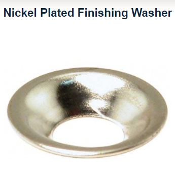

Nickel Plated Flat Washer - Does that have 100 deg countersink to match aviation flat head screw?
Where to buy / PN?

Hey, Ron, I have a box of these washers and never discovered the perfect use for them, but- just this week (first 'annual' since paint) got some paint turn-out with my screws (@#$%^&). Will these stick to the paint and prevent that post paint?
They may not stick to the paint but they will keep your screws from messing up the paint.

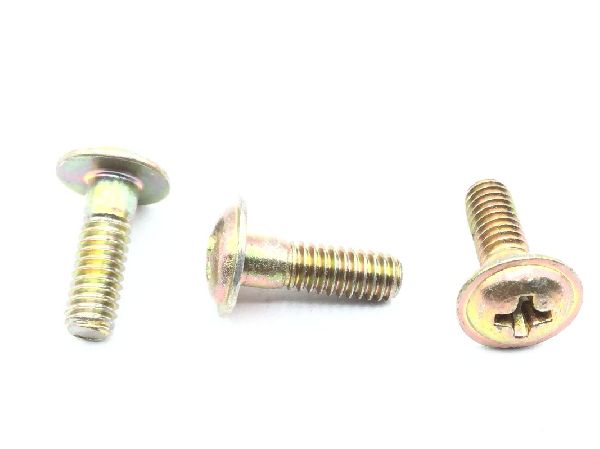

BTW, the screws being used at the front of the cowl are not what is recommended. The plans call for washer head screws because they have some smooth / unthreaded shank where they pass through the cowl.
Using common truss head screws results in the threads baring on the edge of the screw holes which will accelerate elongation / wear in the holes.
Have a part number handy? I’ll add some to my next Van’s order.. Looking at KAI 38.07, I’m seeing a truss head screw listed, AN526C832R8. Not positive, but I believe that’s what I currently have..
The paint is what it is at this point. Looking to hide existing damage and reduce future damage until I can get the cowling re-painted.
I’m with you Joe.
My 12, s/n120401, used truss screws all over the place to include the cowl, spinner, and was according to plans. But I noticed with the 12iS I’m helping with the cowl fasteners identified washer head screws. I immediately thought the plans were wrong and reverted to the truss screws.
Tomorrow when I go back to the 12iS build I will review the hardware call outs and replace the screws with what the plans call out. It will be an easy swap out since we are a long way from startup or paint.
It looks like the correction hasn't made its way through on the Legacy ULS plans yet, but the 12iS KAI DWG 37iS/U-12 shows AN525-832R8.
They are cad. plated instead of stainless, so don't look as pretty, but they will help minimize wear in the screw holes of time.

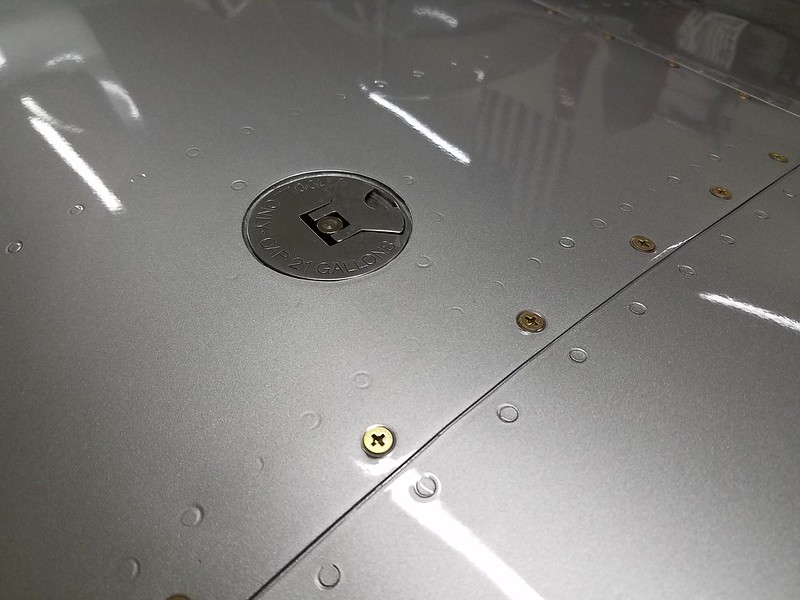

Screws for cowling, etc.
Very interesting - I'm wondering if I should replace the 'old' screws on my vintage build with these - places life anywhere that the canopy plastic parts of the canopy are secured with the older stainless screws??? That would be approximately 100 replacement screws. And now I'm wondering about if it would be good to replace the screws in the gas inlet and spinner???
The locations specified on the cowl are because of experience with those locations. The other locations you mentioned haven’t been a problem so the other screw type is used.
Washer?
Stupid question: I purchased the new screws. Do I also use a nylon washer with them or just the screw?
