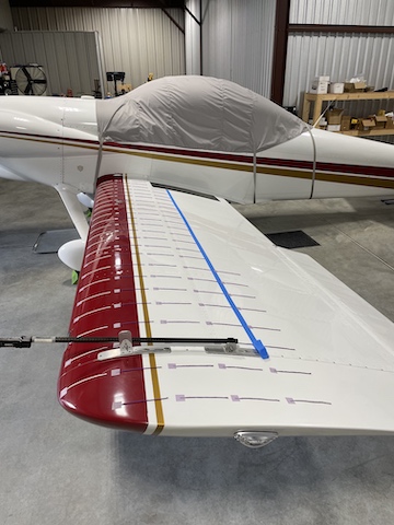

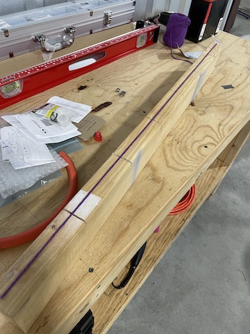

I recently built this extremely high-tech, fully digital, solar-powered tuft jig for some stall testing:

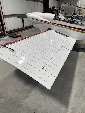

I scored the top of the 2x4 with a miter saw, and held the yarn with two fingers whilst slicing with a razor blade...used standard blue tape to lay out the tuft lines:
And used purple "no mar" Scotch tape to hold the individual tufts in place:

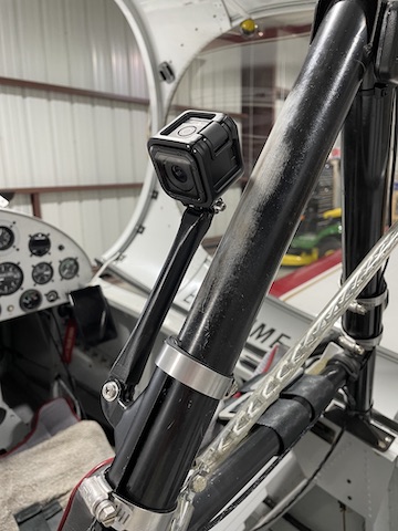

Built a new mount to raise the oblique camera above the canopy skirt to improve the field of view of the tufts during flight:

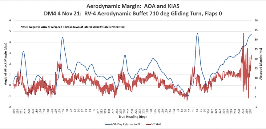

The purpose of this drill is to document separation behavior when flying near the stall and stalled. The constant thickness, no-twist, no-taper RV planform tends to stall "all at once." If the airplane is in a gliding turn (say, trying to maneuver after a loss of power during initial climb phase), this breakdown in lateral stability (fancy way of saying "stall") manifests itself as a sudden wing drop. If you plot AOA and airspeed margin (how close the the aerodynamic limit you are) in a gliding turn at the edge of the envelope, it looks like this:
The valleys in the airspeed and AOA are actual stall (wing drop) where you can see the margin (difference between actual speed and AOA and stall speed and AOA) is zero.

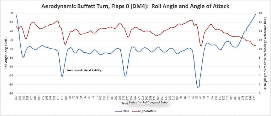

Here's another plot of the same maneuver showing angle of bank (roll) and AOA. Note that as the airplane stalls, sudden uncommanded roll (wing drop) occurs:

There is no indication if a loss of directional stability, as noted in the X axis of the 2nd plot. That would require measurement of sideslip and rudder angle. You must be referring to lateral stability.
Scott,
You are correct. Thx! Changed directional to lateral above.
Thanks for another great and well done test!!
Scotch seems to make a million tape types. Is this what they call "wall safe" with a purple splashed package?
Bill,
Agree, I'm not sure Scotch has ever made the same tape twice (they must have hired some folks from Lycoming ;)). I found this "purple" tape in the aviation isle at my local Ace. Does a good job and no issues with the paint. I did learn it's probably a good idea to dip the bitter end of the tuft in some Elmer's or something similar to keep it from unraveling...20/20 hindsight, of course.

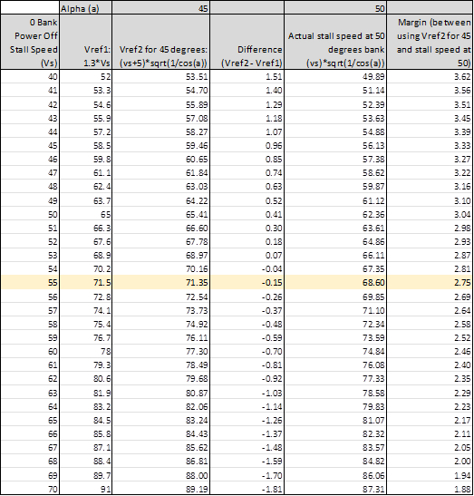

We typically think of Vref as Vs x 1.3. This is actually very close; but the flight test requirement to validate this takes G load into account--specifically a 45 degree bank angle. The short answer is that the airplane has to be able to pull sufficient G to fly a 45 deg banked turn without tripping stall warning. In this condition, there is a desired 3 kt aerodynamic margin. A couple of examples of simulated engine failure followed by a 210 degree turnback maneuver can be viewed here if you are interested in tuft behavior under those conditions:

Rick Marshall was nice enough to put this math in tabular form. The "alpha" reference on the top line of the table simply refers to the variable "a," not angle of attack. It's actually bank angle:
If you listen to the tape, you can hear me suffer thru the cockpit math real time...Also several mis-speaks--I have a bad habit of referencing stall as "breakdown of directional stability." This is generally not correct. I really mean "loss of longitudinal stability" if I can't hold the nose up and "loss of lateral stability" when I lose roll control during the accelerated stalls. I need to fix this, no excuse.

If you fly airspeed only without a stall warning system, and have your Vref dialed in IAW FAR 23, and pull 1.4 G's to capture final, this is your margin--which is to say, not much. Hence old rules of thumb like Vref + 5, Vref + winds, etc. That will give you more margin, but will also mean excess energy when you roll out. These physics are why us knuckle-draggers like to fly alpha for approach and landing--overall just a whole lot easier and more consistent. No math.
