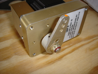

Retrofitted servo
Got servos back from TruTrak on Wednesday. Fast turnaround. Here's what they look like with the new shaft and nut:
Now that's what I'm talking about!! Should be a final fix on this issue. I PM'ed Lucas on the TT forum, can't tell if he got the PM or not... haven't heard anything as of yet.
If you PMd me, I got it. I'm still trying to get caught up from everything during and after AirVenture. I should get another big batch of the retainers out this week. Thanks!
