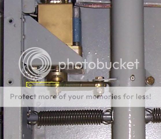

Sorry for the crummy picture, but it was all I had of my roll servo installation. Couldn't a bracket be made that serves the same purpose as TruTrak's fix, but anchor the bracket to the floor rib instead of to the arm?
That's essentially what we built and showed in Post #1 Don - and I am still wondering if it is sufficient. The question is how hard hat screw might try to back itself out. If the force is very small, as Lucas says, then I think our anchored bracket will work - but I don't know the magnitude of that force by analysis or test.

Ironflight;440016 That's essentially what we built and showed in Post #1 Don - and I am still wondering if it is sufficient. The question is how hard hat screw might try to back itself out. If the force is very small said:
LOL! No wonder it sounded familar. I should've guessed that I'm not capable of original thought. :D
