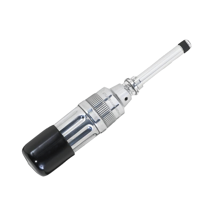

If you really want to go down the rabbit hole, buy a CDI torque screwdriver. It measures down to 5 in/lb. I use it to measure running torque on nylocks.
I saw it and it's gonna be another expensive toy in the toolbox. I'll probably wait until I have to own one 😄.

You’ll want a torque screwdriver when installing the screws in the rear window. I got the FIRSTINFO H5178 on Amazon. They’re less than $80 now and it worked great for me and two other 12 builders that borrowed it.

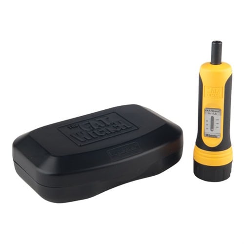

Yep - -FAT torque handle from Wheeler Engineering
More (and less) than you might think. Just a spring, ramp and snaps when reached. I have checked on the bench and matches my little beam OK. From some testing the screws can take way more torque than recommended so with this tool you won't snap any and still be able to remove them.
Search for it and a location/price acceptable, this is just one link.
