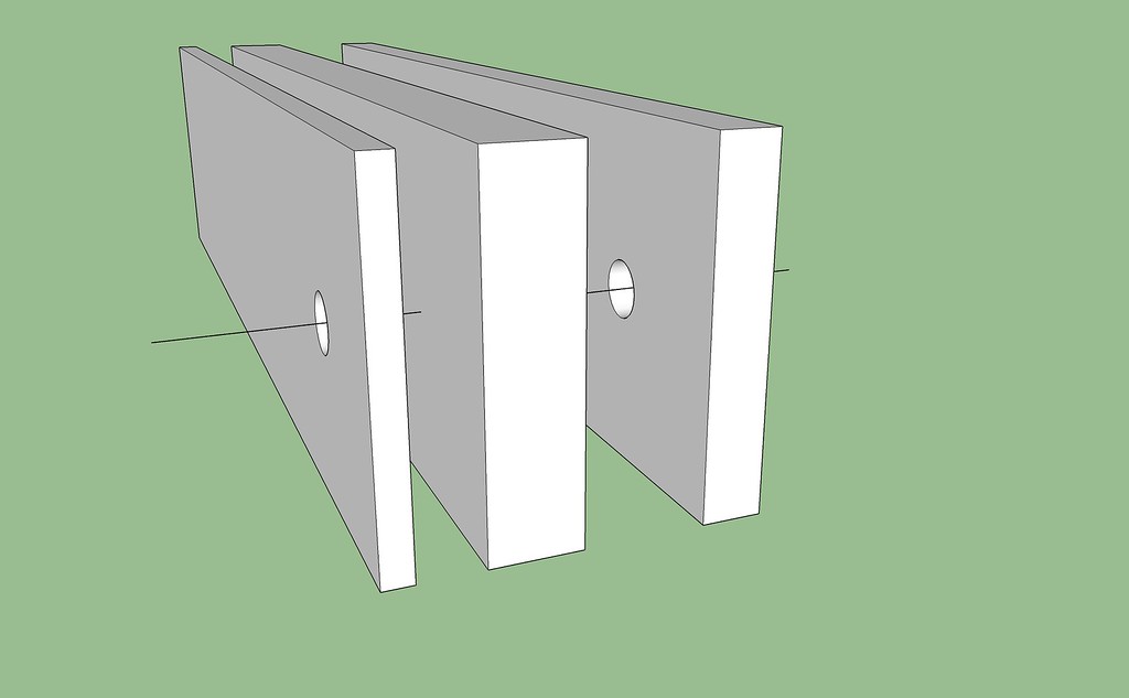

Continuing the fun started in this past thread, I've got a new pair of longerons bent and fit to the already-drilled skins/bulkheads. Preparing to re-drill them. Some problematic areas will be where I originally drilled through several pieces in a stack. Now I need to drill through just the longeron while somehow ensuring alignment with the other existing holes. For example, skin to longeron to engine mount.
Illustration:
Any good techniques or tips on how to accomplish this correctly, through 1/8" thick metal? I know from experience that, no matter how well things are clamped and how straight I drill, if I just match drill through one of the existing holes, the bit will usually come out slightly misaligned with the rear hole and/or make it oblong.

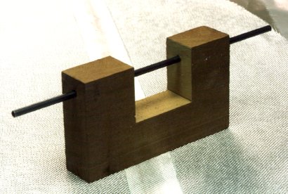

This is a variation of the problem faced by aircraft builders with wood spars.
The issue is mounting steel straps on each side of a spar for through bolts. A U-shaped jig is usually used - pic stolen from a KR-2 site.
A smaller version in steel should work in your case. Use a pin on the aft side to locate and then drill through from the front.
Drill the jig in a drill press - the only part that has to be accurate is the straightness of the hole through both 'ears'

I have done this on straight spars. However, the longeron is an angle, and not straight. This complicates the drill guide. Still can be done, but keep in mind, you would need a jig for each hole, or long jig to capture all of the holes as each could have been drilled at a different angle, and the spar is also bent. That is a lot of work, and unless you have very good machining skills, the chance of making this work is slim.

I disagree... you are assuming a close-fitting jig.
The jig need be only a loose fit around the longeron, and after each hole is drilled a cleco can be used. No need for multiple jigs. Different angles make no difference. The only important thing is that the drill itself is a good fit in the hole - which is why I suggest a steel jig, but drill bushings would work.

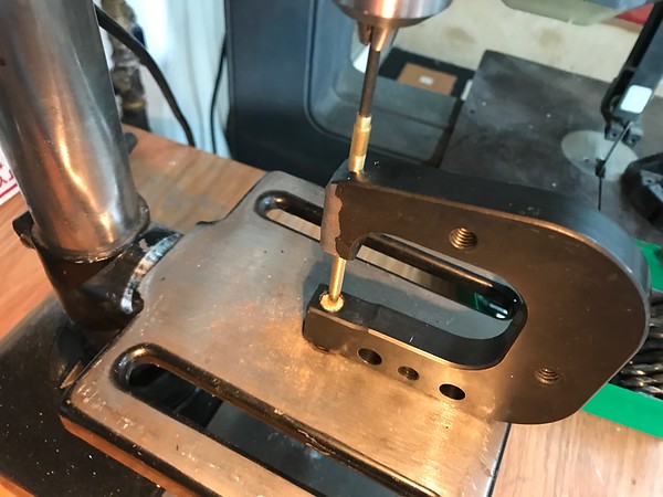

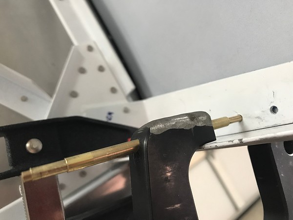

Thanks everybody. After thinking about the problem a little, I came up with something combining Gil's jig idea with Larry's bushings, that I think will fit the bill:

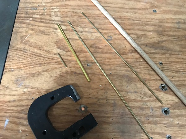

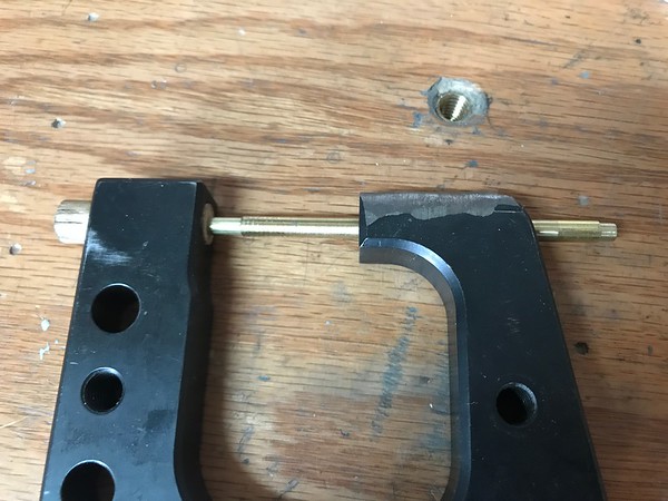

Let's see what I've got here: A bunch of brass tubes, 1/8", 5/32", and 3/16" O.D., a 3/8" hardwood dowel, and a squeezer yoke that will fit around the longeron:

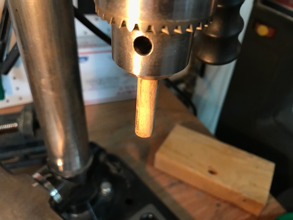

Cut off a length of dowel, and chuck it in my drill press, sanding it down:

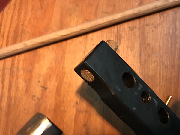

Until it fits snugly in the yoke:

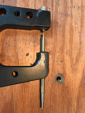

Now cut about 3" of the 3/16" rod, chuck it in the drill press, and file off just enough so it fits snugly in the other side of the yoke. Slide the 5/32" rod inside of the 3/16" rod:

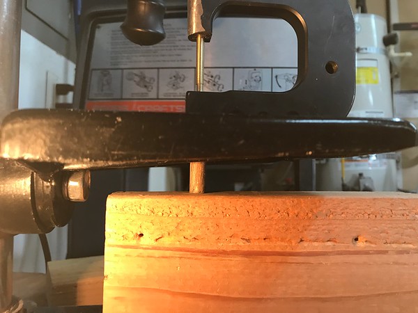

Secure the yoke against my drill press table and support the dowel from underneath:
With a long 1/8" bit, use the tubes as a drill guide to drill dead-center through the dowel:
Now, cut two lengths of 1/8" rod, slide one through the dowel, and the other through the other rod stack-up. Now I've got an adjustable tool that I can drill a #41 or 3/32" hole directly through without any chance of missing:
It fits right in the existing holes!
Not quite ready to drill yet, but I'll report back later on the results. I'll be trying it out with some scrap first, of course, but I think this is going to work.

Verdict: Mixed results
I could reach 4/7 holes with the tool and they turned out perfect. The engine mount flange gets wider towards the firewall and for the forward-most three holes, the jaws of the yoke would not fit, so I had to use another method to get them. Used a drill block and the 1/8" rod as a bushing, and drilled from the skin side inward with a very small bit, then a larger one, etc. until final drilling #30. Turned out fine.
