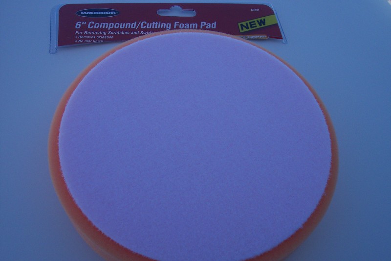

This is probably what I should have used. Maybe I still will: Perfect-It 33662 Quick Connect Foam Pad Kit . At this point, what's another $109?
So I used what was available locally - the flat foam pads. This is the one that damaged my paint:
I used the same orange HF one many times with medium-coarse compound, right after 1500 grit random orbit sander. It takes some work on the tough siloxane topcoat but it leaves an almost-glossy, very even finish. Definitely no scratches like the ones in your photo. A quick pass with the blue pad and fine polishing compound after this produced the shine in my photo above.

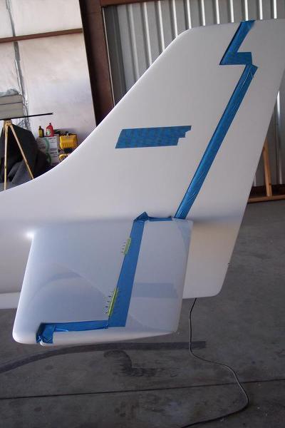

Making progress. After sanding out the swirls from the DA and using the Trizact 3000 with a hand pad. I started re-buffing today. I skipped the 3M #1 and went straight to the #2. I think the #1 was just too aggressive - more suitable for removing oxide from a car hood. I think the #2 going to work and I may follow up with the #3 if I don't give out.
I masked off all the control surface gaps and static ports so as not to clog them with compound:

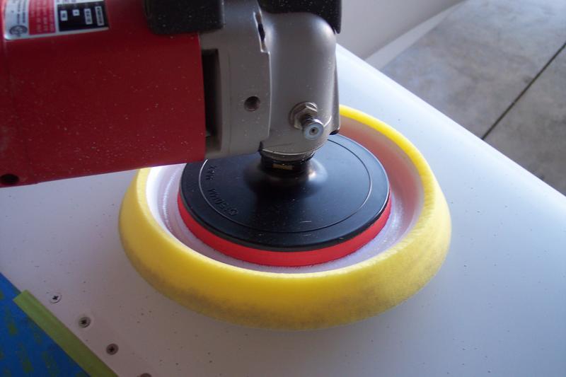

This is the "medium" yellow foam pad I used (Harbor Freight)

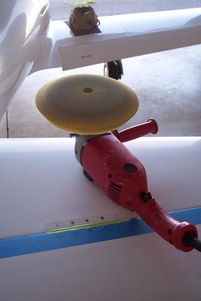

I bought a hook-and-loop backer plate on Amazon for my Milwaukee. For some reason, Harbor Freight didn't stock them:
Working my way forward, you can see where I stopped buffing adjacent to the aft end of the side windows. The #2 compound took out the haze you can see forward of that from the 3000 grit. I could see a couple places that needed more buffing. Tomorrow is another day...

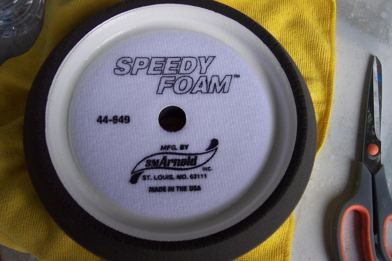

Here's the back side of the buffing pad I was using on the #3 compound. I thought it worked well - the beveled front face made it easy to hold the buffer at a slight angle like DanH recommended. I used a yellow pad for the #2 and a black (softer) pad for the #3 - both from Harbor Freight. After use, I am storing them in gallon baggies so as not to become contaminated.

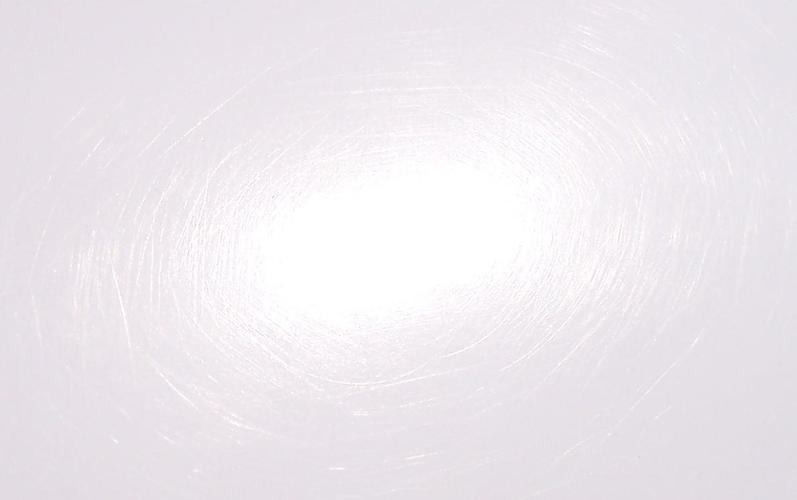

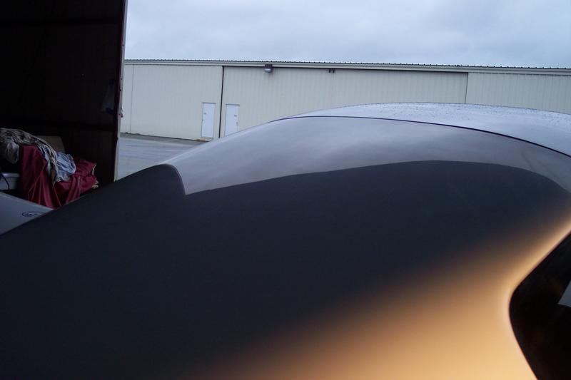

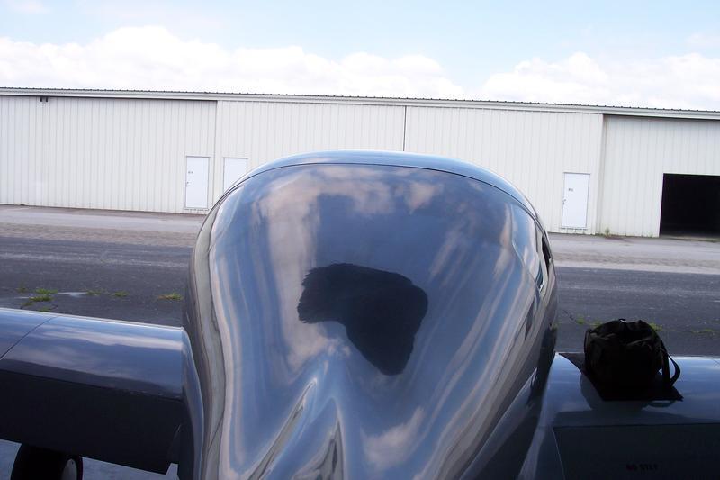

It looks great in the hangar, but what about in the sun? That's where my swirl marks really show up. Maybe I should just fly in the dark? :rolleyes: So did you use a DA with the #1 compound, or a rotary buffer? I found a small patch on my fuselage where I can still see scratches and am thinking about trying to remove them with the #1 and a foam pad in my rotary buffer. Yes, I'm a glutton for punishment...
Ok then...
As stated in the very first post, 4th paragraph, light colors are less of a swirl problem, while dark colors may require a few extra steps. You're cutting a white airplane.
The photo you posted....
...appears to show the result of dirt/grit under the pad, not buffer swirl. Lots of ways for it to happen. Running a fan to stay cool while working in a hangar would be a good example, or just working with the doors open on a breezy day. In the early posts, note I'm working inside a paint booth set up in my shop...no dirt, filtered air.
There's no reason to cut a whole project with a dirty pad. Paint damage is easy to catch in a few square feet if the operator is paying attention. How to see what you're doing is also in the first post, 6th paragraph. Best bet is to look at the reflection of an overhead fluorescent tube fixture; moving your vantage point sweeps the tube across the surface. See the photo below. The average hangar doesn't have appropriate lighting, so you need to set up lights for the work. The same is true for painting.
If you can see damage of any kind in bright sun, it's bad. Buffer swirls, scratches, and even hail damage are all least obvious in noontime sun. Low sun angles show more. Swirls are most visible after sunset, when viewed under typical metal halide lot lighting. On the lot at night is where detailer skill is rated.
You seem fixated on my use of a cut down 3M pad on a DA sander. It's described in post 27, which is pretty clear. The DA is a handy way of buffing small parts when working by yourself, as you can hold them in one hand and cut with the other, something you can't do with a big buffer. For what it's worth, I mostly allow the pad to rotate. I've never cut a big panel that way, because it would be a waste of time, and I have no idea what happens with foam pads from Harbor Freight.
Bottom line is that with care, it's not anywhere near as hard as you're making it appear. And you can excoriate "the experts" as you please, but brother, it's a crappy way to garner additional help.
The photo you posted.......appears to show the result of dirt/grit under the pad, not buffer swirl.
The pad that made those swirl marks was brand new, sorry. Anyway I got them out as I described. Today I zeroed in on a small patch with a couple of scratches. I used the #1 compound on a black foam (soft) pad and my rotary buffer. That combination didn't take out the scratches so I fell back on the 1500/3000 grit with a foam hand pad. That removed the scratches so I buffed over that area with #1 and #2 (using a different pad, of course). It's all shiny now in the sunlight with no visible scratches or swirl marks. I think I'm done cutting and buffing now and am moving on to the colored vinyl trim. Thanks for all the suggestions.

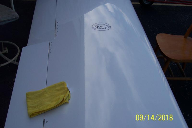

I waxed the top of the wings today with Mother's California Gold carnuba wax. I think it looks pretty good. You can't even see the spots that I had to touch up and blend in.

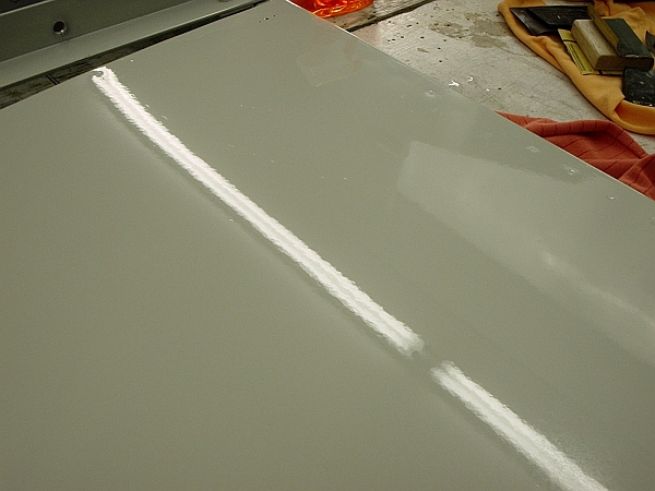

You may not have to do any of that, though. One thing you could try: mask off everything else thoroughly; spray some black paint over the area with the runs; sand away with 1000 grit until all the black is gone. Use a thin firm rubber pad and press only where there is black. That way you won't cut through the white paint. When satisfied, cut&buff as described in the OP.
Is it too big for the razor blade method on the 1st page of this thread (run over 400grit, convex, scrape a little, buff a lot)?
The scraping technique, yes.
But, you can slice off the thick part of the runs and work your way down. I've done it plenty of times. Just use brand new single-edge razor blades and carefully slice off the runs. You can then get the last bit with wet-sanding.
I think this is totally fixable. The biggest issue are the rivet heads and not burning the paint off of those if you buff. Protect them with a strip of tape and be careful.
Razor technique
Thats totally fixable. Sorry, I hadn't looked at the photo. Dan's razor method works really well. You need plenty of light so you can see when the drip has been removed down to the level of the flat surface. I have found the razor needs to be retreated when it stops scraping.
Once you remove the drip, follow his compound and polish method. Tape over the rivets to prevent blowing through the paint.

Now that the paint has been on for about a month or better, it's cut and buff time. (This might have been easier if it weren't quite so well-cured already). Nevertheless, I'm learning how easy it is to sand through a proud rivet head edge and how many nibs in the primer we didn't knock down and now show through as tiny gray flecks in the color sanding process. I will be buying and learning to use an air brush before this is over.
A surprise to me was how long it takes to sand down through our typical orange peel using 1500 grit Trizact 6" disks. I was spending hours each evening all last week and still didn't have one wing's upper surface ready for the 3000 grit in most spots. I ordered some 1000 grit 3M Purple Finishing Film disks to try to speed things along since that is what came up on Amazon when I searched for Trizact 1000. These disks are thinner than the 1500 and 3000, don't carry the Trizact label or embossed texture, and are so fine one cannot tell by feel whether there is even any abrasive on them or not. There is no comparison between the abrasive texture of the 1000-grit purple film disk and a piece of 1000-grit 3M Wet-O-Dry paper, the latter is much rougher with more tooth to the touch. It's hard to tell by sight or feel when these finer abrasive disks are worn out, especially the 3000 grit Trizact foam pads, but I figure my time is worth more than even a 3M $$$$$ abrasive at retail, so I swap them out often.
Yesterday I was putting in my roughly 15th hour on the top of the first wing and wondering if the supposedly coarser 1000 abrasive disks were even saving me any time cutting through the paint so I did a side-by-side comparison of two virgin areas of flap with fresh disks, each run on the sander for 3 minutes inside their respective ~ 16"X16" test sections. There is a visible difference and the 1000 does indeed cut faster, so I will press on doing 1000, 1500, 3000 and the the three compound and polish steps with their respective foam pads. I had no idea it would be this slow (in unrelated news, naproxen sales have spiked locally) but at least this process can be done in a limitless number of smaller work sessions with no need to hurry through any of it in the coming months and years.
Question to clarify a step: I suppose one should remove the protective tapes over the panel edges and troublesome rivet lines before the compounding and polishing steps, just being careful to rotate the pads away from each edge rather than into it. Is that right?
I have a variable speed polisher and am curious what speeds have worked best with the 3M chemicals and 8" pads for compounding and polishing. I understand it's important to generate enough heat, but not too much, using speed and pressure while running the buffer, but I am inexperienced this early in the learning curve. Any suggestions appreciated.

Leave the tape on the edges at least. Easy to burn through and edge or rivet head if even a tiny bit proud. Be glad they’re flush heads!
