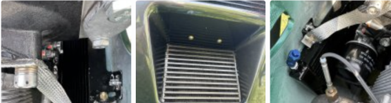

RE: Revised RV-12 Radiator
I think it’s the same revised radiator, but with the completely different mounting. The oil cooler is also attached to the lower cowl. Both are attached with hardware that is easily removable, and the prototype has braided cables that allow the radiator and oil cooler to be disconnected and just hang from the cables when the cowling is removed. I’d call them to get a definitive answer.
