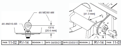

Attaching elevators to Horizontal Stabilizer pp11-02/3
On page 11-02,m it shows a distance 0f 13/16. At this distance, the elevators rub against the H Stab. So, I backed out the rod ends a few turns, which also ensured that "the minimum distance from the Horizontal Stabilizer Rear Spar web to the Elevator Torque Tube is 1 5/8". Then I noticed...
