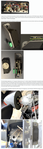

Here's the hardware I've been working with.
It's got a Pi Pico 2 W (RP2350) microcontroller, ADXL345 accelerometer, DS3231 real time clock, TSSP77038 IR receiver, IR333-A IR Led, and a 1 gigabyte SD card. I've almost got the firmware and app to a point where it's ready to mount to the plane and log some accelerometer data. The problem is, there's no way I'm bolting hardware like this to an airplane engine. It needs to be repackaged.
I'm sure I'll hate myself later for making this so tight and not leaving much room to run wires. But here's what my current proposed packaging looks like.
