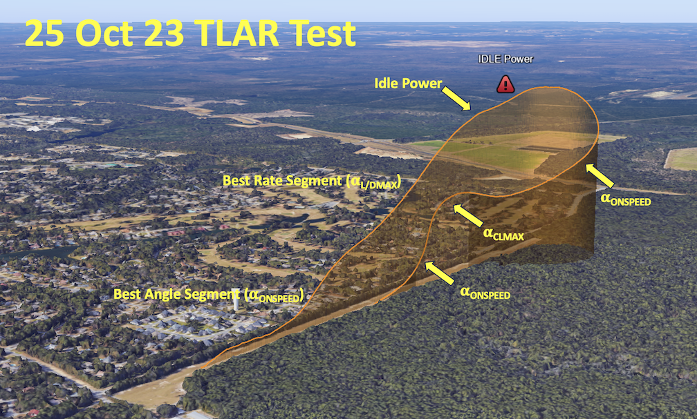

The engineers converted some of our high-speed GNSS/INS data to .kml format and then used Google Earth to develop a nice 3D graphic of a couple of turn back tests :). This compliments the academics in Charlie’s briefing in the first post of this thread and cockpit video well to illustrate what’s happening throughout the maneuver.
Here is the 25 Oct test (previously posted): https://youtu.be/F_RFKlUhdeE
If we plot that, the flight path looks like this:
I ran another test with updated software which fixed the glide capability graphic and voice warnings on 12 Dec. I manage to smartly screw this test up! Notice that I count to three and then pull the power after the "turnback possible" cue. This is backwards. No excuse, but there are still some good lessons to be had. Here is the cockpit and iPhone video from that test: https://youtu.be/zXjkHjFdLAA.
Here is the test plotted in .kml format from takeoff to landing:
It’s pretty apparent why I’m only able to test a right-hand turn back at my home field.
In the Google Earth pictures, you can see wind effects on the geometry of the turn circle. Also apparent in both pictures is that climb angle is steeper than glide angle.

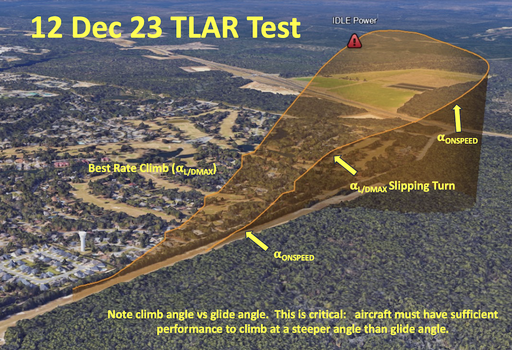

In the 12 December test, you can see a similar sight picture after turning back to point at the runway, and initially I mention a “square corner,” but then elect to slip the airplane during the alignment turn instead. If you watch the AOA indexer, you can see that I transition to L/Dmax (vs on speed) in the slip. This increases descent rate and provides a bit more maneuverability. It does, however result in excess airspeed that I have to lose during the transition to the flare. An on speed slip may have been a better option, but things happen fast during a turn back and both techniques employed in the video resulted in flight path management sufficient for touchdown in accordance with “training rules” (i.e., enough runway left to allow for roll-out and stop with a 10-knot tailwind). The latter is a personal limit and determined pre-takeoff using ambient conditions. I avoid quartering tail winds with a tail wheel unless it is necessary for flight test. Just like an actual emergency, the key is to have figured this out before takeoff, not during the heat of the moment when I’m sucking up the seat cushion.
Flying the simulated power loss during initial climb and return to the runway for an opposite direction landing is one of the most difficult maneuvers I can imagine in a civilian flying environment. I'm not skilled enough to "eye ball" a turnback without help from the computer (TLAR app) and some pre-flight planning, nor am I skilled enough to max perform the airplane this close to the ground without the "eye's out" trend information provided by the AOA tone. I’ve labeled the AOA cues I’m using on the graphics and included indexer (visual AOA display) in the video. My hat's off to anyone that can fly with this level of precision using conventional instrumentation: https://youtu.be/OwcstKP3DVQ. It's a privilege to fly and work with such talented folks.

... Also apparent in both pictures is that climb angle is steeper than glide angle.
Really important point you have raised, Vac. The two angles are dramatically different for your aircraft, and I guess most RVs. We don't glide well, and we are typically over-powered, whatever that means. :)
I guess if you are going straight out on the runway heading, this is the fundamental condition that must happen for a successful turnback.
Any aircraft with an anemic climb rate would be wise to stay in the airport "safety cone" until getting to altitude.

I recently tested out my plane, (180hp RV-4, fixed pitch prop) first at altitude, then slowly brought it lower and lower. There are two ways I typically takeoff, one way is staying in ground effect till 110 knots or the end of the runway, then gently climb out, the other way is to climb to 1000 feet at Vy.
Using the Ground Effect method, I can get to the end of the runway around 110 knots indicated (3300 foot length at 2600msl), then gently start a climb, at 100agl, I chopped the power, counted to 3 seconds for the “startle factor” and began a turn back. I make it every time.. anything higher than 100 feet, I actually have to stay straight a little longer before I turn back so I don’t over run the opposite end!
I’d like to revisit the energy discussion here. Vy is most excess power hence best energy addition but as you’re accelerating, you aren’t holding this. Vx is most excess thrust but is less excess power… if you accelerate from liftoff which is near enough Vx to presume you’re already at Vx and accelerate ground effect to Vy, that whole band is more excess power therefore more energy than you would have gained at Vx climb. It is also less drag throughout so less costly of your energy. Now you can go a bit beyond Vy and still have more excess power than Vx but the moment you hit an excess power equal to Vx’s, your band has ended. And your parasite drag is increasing costing more with no benefit from ground effect right of L/Dmax. And you’ll have to pay a tax in increased load for pitch rate to set a zoom. Best really is ground effect accel to Vy, as able climb Vy, zoom if and when needed to Vx instead using that energy for turn if height not needed.
You could catch Vy in ground effect for most energy add in shortest time then choose to climb Vy or zoom Vx to reduce linear displacement and gain most immediate height. That choice kind of goes back to the above, the steep climb profiles enable more steep descent profiles but there is that worry for short field and/or headwind driven exclusion window… note both the SAFE and the Brian Schiff presentations emphasize with stiff headwinds, low ground speed in the straight-ish ahead options really increases survivability even for crashes into not much of option straight ahead available as compared to a crash running with the wind. If you’re gonna do it with stiff wind, you really want a long runway. Also, the steep climb profile vs shallower descent depends on average of climb. Vy means you’ll be less likely to be too steep reducing exclusion window while you could zoom if needed or instant turn with that energy difference Vy to Vx instead, which likely is a better option (assuming you have AOA data available).
Remember instantaneous turn is analogous to zoom while sustained is analogous to climb. Instant turn and zoom both use kinetic to get you something while climb uses CE for PE and sustained turned in normal circumstances uses CE for angles while using PE as a reserve for this case.

I do get leery with the no AOA indication airspeed only based turn back. Optimum turn is 45 AOB at minimum power required. Best straight glide is L/Dmax (faster in headwind, slower with tail, another thing gliders can readily show). Yet minimum power required is often really close to stall. Goal of the turn is more angles for less altitude, or less energy if capacity to “zoom.” 45 AOB needs to be increased 18.9%, so round up pilot math 1.2 minimum power in the turn. But you probably don’t have a published minimum power when applying to other aircraft and will have needed to find it for your RV (kit plane article comes in handy here). Vx is typically pretty close, so you could use 1.2 Vx. Or, as Vac uses onspeed as proxy for both Vx and minimum power for those with AOA, you could similarly use 1.2 Vref. You’ll note often these numbers are close to straight ahead best glide L/Dmax. So, alternately, you could just use constant best glide speed straight as it closely mirrors optimum turn’s speed too. But we get into issues with some planes as L/Dmax may occur flaps up pretty close to stall, or at least closer than we assume. The Cirrus SR22 occurs at 0.65 normalized AOA not 0.5. Cessna 177RG at 0.6 not the expected 0.5. Icon is similar though it has AOA standard equipment. This has implications if you’re holding speeds going into turns. Especially as Vac likes to point out, “the slower you go the faster you go slow.” If you were already trimmed, no problem, do the turn letting the nose settle where it will based on the trim. But, as this situation starts with both ease of pitch and start turn immediately, you likely aren’t trimmed to the desired value and will be using some back stick. At which point it is easy to get too much. While you could start more conservative without a computer and work it down, without AOA feedback, you probably want to look at the platform and see if this be a concern. If so, you may want to adapt to more conservative procedures and therefore a higher bottom of zone. (Vs/Vbg)^2 <= 0.5 and you’re ok. The larger it is greater than 0.5 then the more concern you should have. Both values should be published for other aircraft. Note Vs as in you’ve already cleaned up. If you’re a Vy climb, there is good chance your Vy is slightly faster than L/Dmax. Due to tractor propeller wash effects and impacts to AOA, think go around trim stall causes, your trim will be even faster as you start your glide. You might want to simply accept this value with your Schiff tests, and make your profile accordingly, accepting you’ll trim toward L/D after initial turn if you have wherewithal and need. Consider it a slight margin allowing you to pull back after the first rollout. But your bottom of zone starts higher. Yet you can let the trim work and not risk stall by avoiding back stick in the turn.
Note: if you have AOA, you can do this for any weight simply noting the correlating AOA good for every weight. But the AOA will need sufficient range of display and precision.
