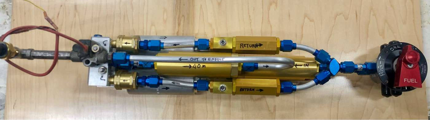

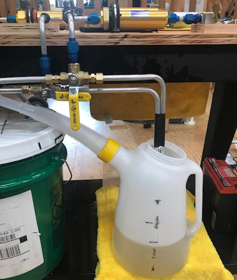

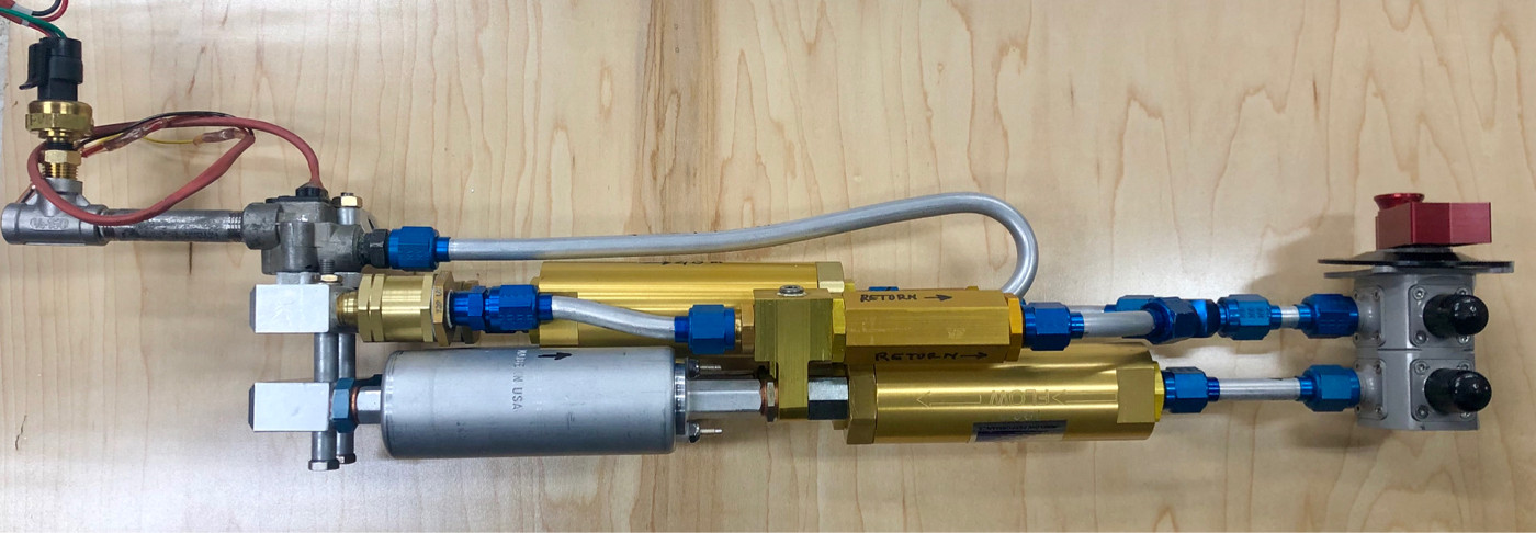

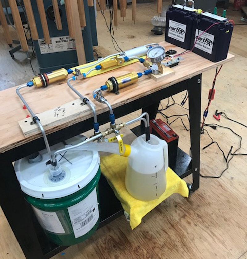

I decided to build this test rig, shown here collecting data for one of the Walbro pumps. It incorporates pre- and post-pump filters and enough lift, bends, turns, and manifold reversals to roughly mimic the aft-of-firewall dynamic flow restrictions of a typical RV installation. Here, the return line is closed off, and “engine” output, dialed-in at 30PSI resistance, is being shunted to the flow-measuring vessel.
Here you can see the right side valve shunting output to the measuring vessel. The black marks were established using a precision flask, and the flow would be fully stabilized by the time the stopwatch was started at the bottom mark.

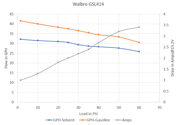

I did thorough dynamic testing of three pumps and used the raw data to generate the three Excel performance charts below, testing each pump at 10PSI intervals from 0-60PSI(increased to 5PSI intervals within my operating range of 20-40PSI). The rig allows precise stopwatch timing of exactly one gallon of fluid at each pressure point. It features 3-way valves to shunt the output return line flow and/or “engine” flow into a measuring vessel or back to the source tank. The return line output was blocked completely for GPH vs. Pressure testing, but I also measured pressure and return-line GPH for each pump with the “engine” flow blocked completely to mimic pre-start operation of the pump.

Finally, I decided to dismantle each pump tested to compare design and construction- some photos and discussion will follow in a later post in this thread.(edit note 2-17-19: I tried to add this info here but exceeded the allowable post word-count. Please see the post on page three of this thread where I’ve added photos and commentary- O.H.)
Happily, a very clear winner emerged for RV’s between 125 and 300HP, the Walbro GSL414, with results shown in the first graph. Note that it generates a reliable flow of more than 35GPH at all pressures below 40PSI, and consumes less than [email protected] through the 25-35PSI range that my RV will operate within. Even this output is far in excess of our needs up to about 300HP, but power required is so low that ONE of my twin EarthX ETX900-VNT’s will operate one of these pumps and a LightSpeed PlasmaIII through an entire 40-gallon fuel load!

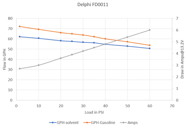

Compare that with the absurdly high output and consumption of the Delphi from AP depicted in the third graph. All that surplus output pumped back through the return lines is wasted energy. At 795grams, the all-steel Deplhi also weighs nearly twice as much as the 454gram aluminum-body Walbro GSL’s.

And the winner is!: the Walbro GSL414

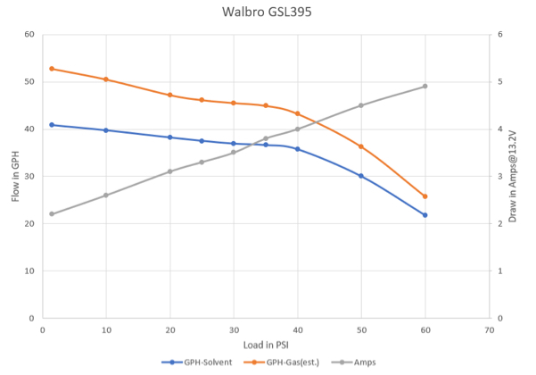

This pump pushes [email protected] through the return lines drawing [email protected] sitting idle at pre-start!
The Walbro GSL395 was also tested, but proved less efficient.
Here are results from the Delphi pump obtained from AP:
Pushes fully 62GPH@33 PSI drawing 4.2Amps @13.2V sitting idle pre-start. The flow from this pump was actually frightening to witness with gasoline.

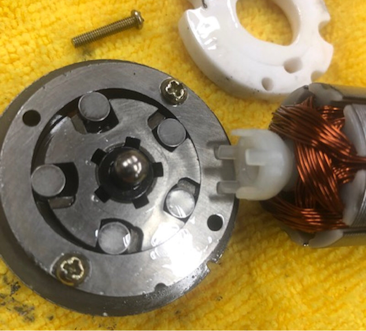

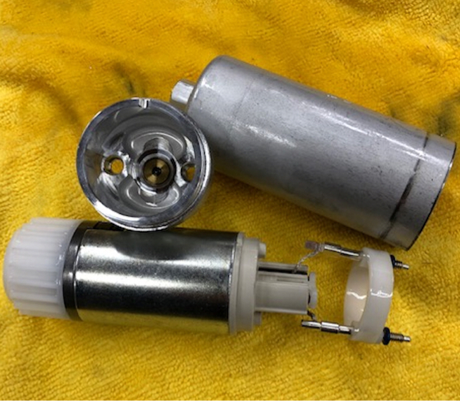

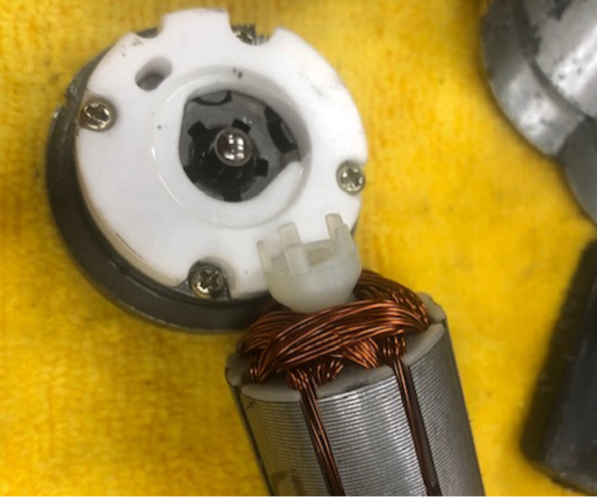

The promised internals-

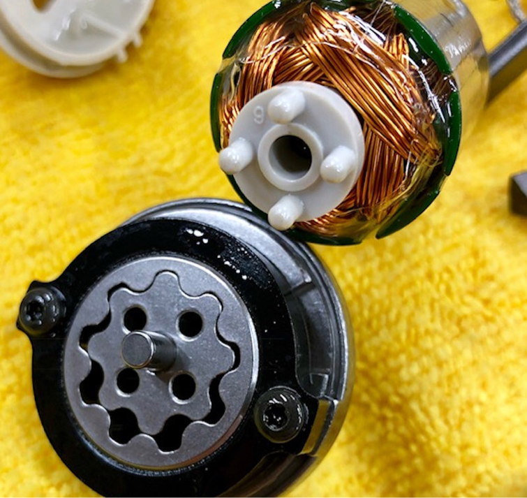

(2-17-19 edit) I promised to add photos and commentary on the internals of these pumps. Sorry for the delay- I’m putting this here for a “bump” , and also will try to edit it into the primary post of this thread.
Of the three pumps tested, I cut up the Walbro GSL395 and the Delphi, which are quite different internally. A Walbro tech told me that all of the GSL-series pumps would be very similar inside, with the differences being in gerotor thickness, motor windings, etc., so I decided to keep the GSL414 intact as a spare and for demo-ing my test rig at the next EAA chapter 124 meeting here in Santa Rosa, CA.
Major differences between the Walbro and the Delphi, which is OEM on several autos, include an all-steel outer body on the Delphi that is more than 1/10” thick to allow machining in stop-recesses at both ends. It also has plastic inlet and outlet bodies as compared with an integral aluminum inlet and housing and a precision machined cast aluminum outlet on the Walbro. The steel shell contributes to the huge difference in weight (795GM vs. 454GM).
The most significant differences lie within the pump section itself. The first two photos here are from the Delphi pump, which is a screwed -together sub assembly as seen in the top photo. With the cover removed you can see the roller vanes captured within a wheel directly driven off a set of five plastic fingers mounted to the end of the motor armature. Centrifugal force keeps the rollers in contact with the fixed, eccentric outer ring, so volume of the cavities between rollers grows and diminshes with each revolution.
The following shots show the Walbro GSL395 outer aluminum housing and thin-walled steel inner housing that carries two permanent magnets inside. The white plastic body to the left houses a fine, full cross-section filter screen and a relief valve for internally recirculating pump output back to the pump inlet in the event that output is locked. The Delphi is absent both of these features.This relief valve should never operate in normal operation of a proper installation. The screen is NOT serviceable, suggesting that a low-resistance, large-section, screened pre-filter should be used(Walbro recommends 40 microns). Note the beautiffuly machined outlet interior housing a tiny check valve. Both pumps feature check valves at the outlet, but I’d be concerned that this could be blocked open by debris during a failure, possibly robbing output from pump #2, so Iwill install big external check valves isolating each pump.
The second photo details the gerotor, a marvel of simplicity that has a very reassuring feel when rotated manually. The inner and outer gear profiles are ingenuously ground so that each lobe maintains precise contact with its mate at all times, creating sealed cavities that grow and shrink in volume when rotated. With this design, the inner gear is concentric and also directly driven by four plastic fingers at the end of the armature. The outer ring is driven by the inner gear to rotate within an offset bushing, made of a black composite material. Note that the inner gear has eight teeth and the outer gear nine, and the geimetry is such that with each revolution of the inner gear, the teeth progress by one tooth on the outer gear- brilliant!
Photos of the Chinese-made Airtex pump that I disassembled for an earlier thread, similar in design to the Delphi, can be seen here:

A 393 should be drawing around 5.5 amps at 43.5 psi, not 10.

GSL393 pulls 6.67 amps (engine not running, all fuel returned to tank via fuel pressure regulator).

Checking datalog from last flight: 39 psi WOT take-off. 41 psi engine not running. Significant?
