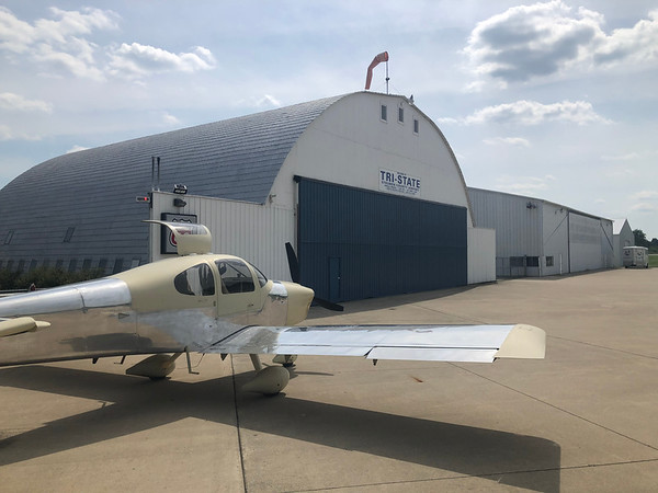

Left early Saturday morning for a smooth, cool flight to Angola, IN. Very short ride from the airport to Lake James.

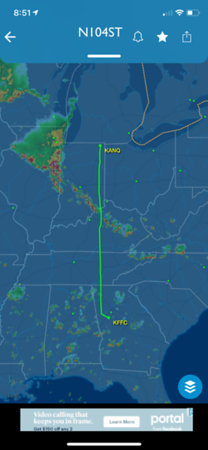

but not without Mother Nature trying to make it things interesting- this water roadblock wasn't in the forecast.
Just a slight detour was all that was needed to find a RV size VFR gap.
