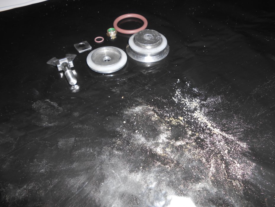

Here are some photos with comments:

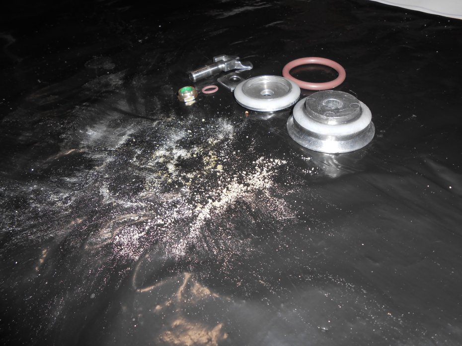

One cap apart the other waiting to be cleaned:
![GC1.jpg](/proxy.php?image=https%3A%2F%2Fi.ibb.co%2Fwdgz2h4%2FGC1.jpg&hash=231efed0d12133dec3ddd23e06973a04)

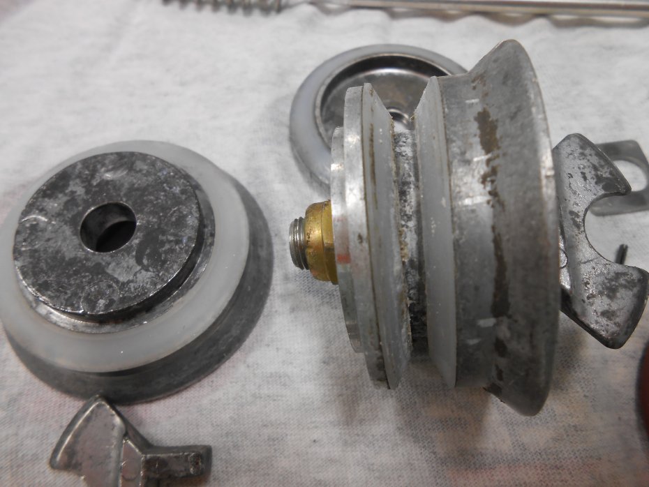

Corrosion under the big o-ring:
![GC2.jpg](/proxy.php?image=https%3A%2F%2Fi.ibb.co%2FydxTmHy%2FGC2.jpg&hash=56ce3f5e3ad828e4f1793ff22d0efeee)
Parts, notice new roll pin? The glue looking stuff near the top of the cap is the "EZ-Lube" talked about during this thread. Nothing easy about removing it!:
![GC3.jpg](/proxy.php?image=https%3A%2F%2Fi.ibb.co%2F3rb4bCd%2FGC3.jpg&hash=10788b389208dbfff3cfdb617b90f8d0)

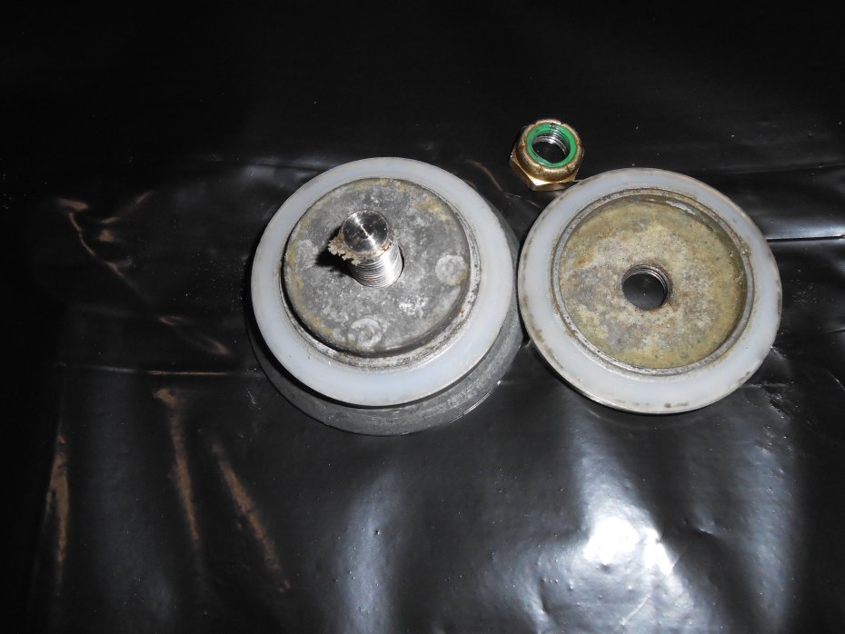

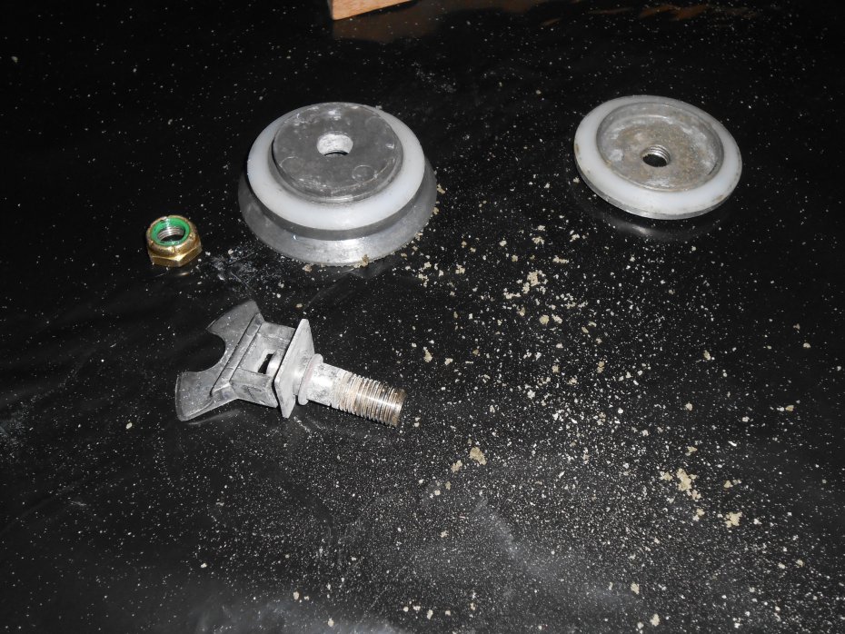

YUK! Note crude on threads just from un-screwing the cap, 1998 build up to present, you can see that the bottom part of the cap has threads in it in this photo:
![GC4.jpg](/proxy.php?image=https%3A%2F%2Fi.ibb.co%2Fhm0BN3N%2FGC4.jpg&hash=95160339c959cbcaca88ed40d2be1dfc)

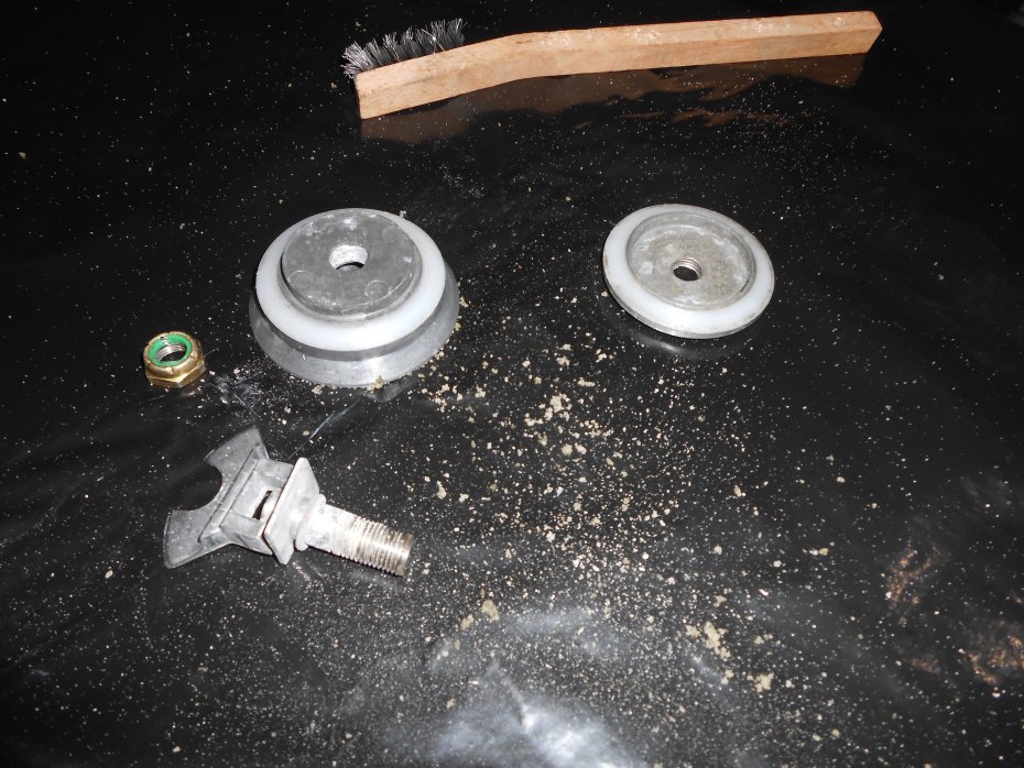

A real quick Stainless Steel brushing has this to show!:
![GC5.jpg](/proxy.php?image=https%3A%2F%2Fi.ibb.co%2FsJkrF3c%2FGC5.jpg&hash=0bd4922a58de0a44a82175e2e8006315)
Stainless Steel shaft. Note corrosion from aluminum on o-ring and shaft, in the top part of cap, see the white stuff where the shaft slides? Now is the time to realize that is why you need to push the shaft down to get the cap to work better when removing it for fill ups:
![GC6.jpg](/proxy.php?image=https%3A%2F%2Fi.ibb.co%2FwJKLHHJ%2FGC6.jpg&hash=bdb4d31c846eaf19b8c08c8ac23afcb0)

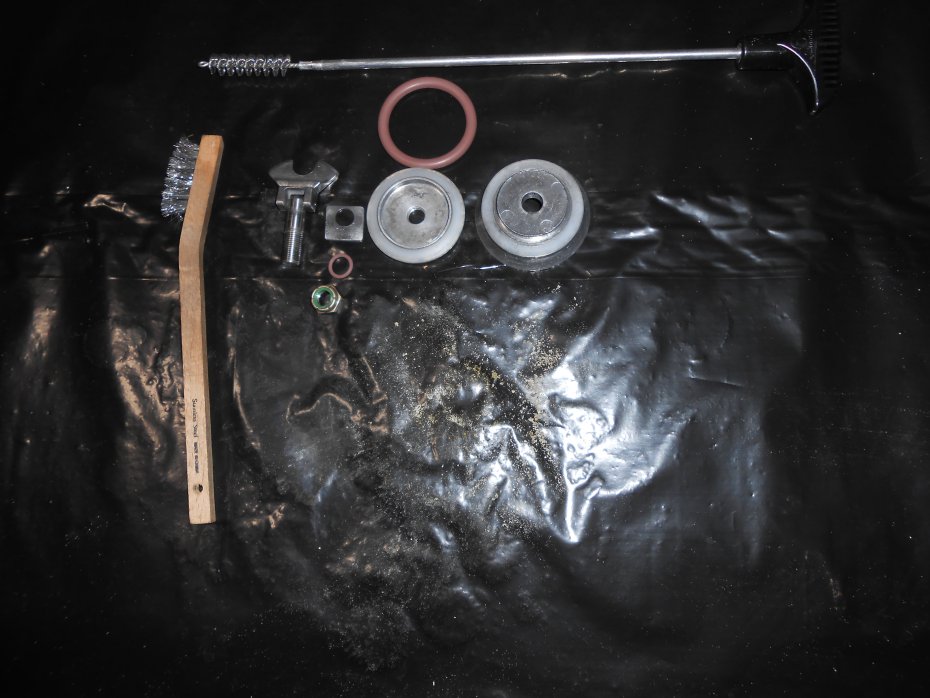

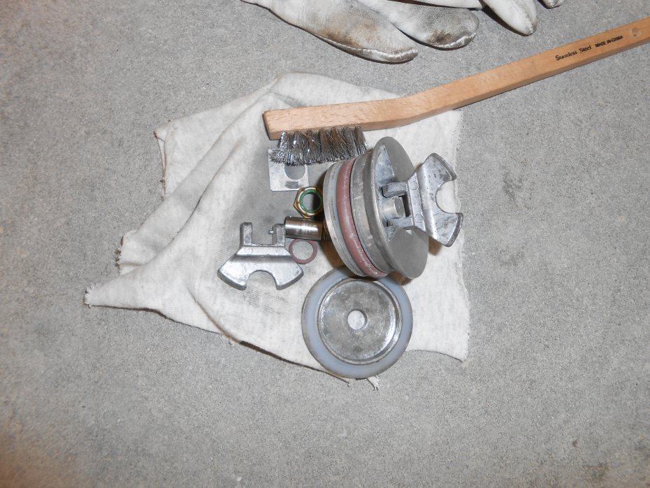

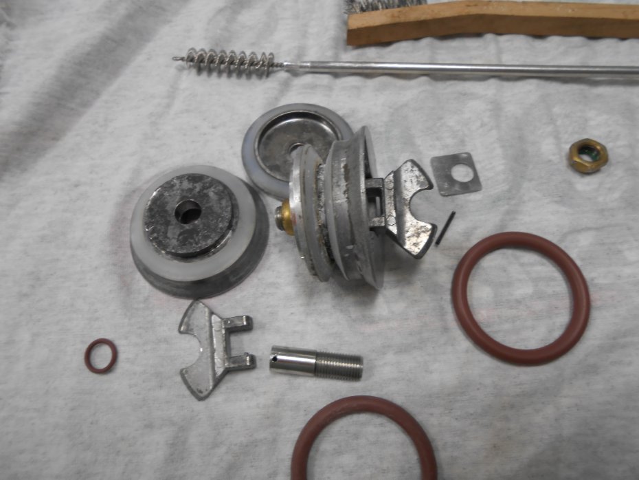

Parts cleaned ready for assembly, several photos showing pile of crud and shiny shaft, along with cleaned parts:
![GC7.jpg](/proxy.php?image=https%3A%2F%2Fi.ibb.co%2FKV00H5N%2FGC7.jpg&hash=9a9e72fc4f2b6e5c63aa7af4ba3a0882)
![GC8.jpg](/proxy.php?image=https%3A%2F%2Fi.ibb.co%2FDR4MxYC%2FGC8.jpg&hash=30b3c809e9fdd84a141f048cc89d5ba9)
Stainless Steel toothbrush used to do the brushing, the gun cleaning bore brush (also SS) is in the background:
![GC10.jpg](/proxy.php?image=https%3A%2F%2Fi.ibb.co%2FDggm4hw%2FGC10.jpg&hash=956203d368af9e8bcc5c9ddc05bfc70f)
