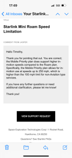

I can now confirm that they are advertising Mobile Priority to work up to 250…
As long as the terms of service restrict aviation (They specifically call out greater than 100 mph up to 250 mph for non-aviation usage is ok), we will always have at risk discontinuation of service (and a $600 paperweight) and if it does continue to work 3 times + the previous cost. Mine is going back. Did work well before they capped the speed at 100 mph.
