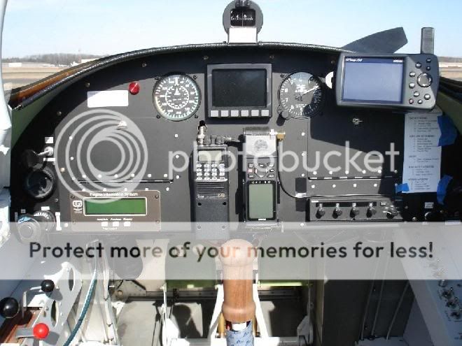

This is how I purchased the plane.
(Before)
