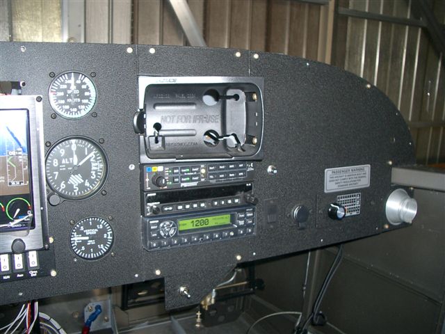

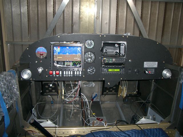

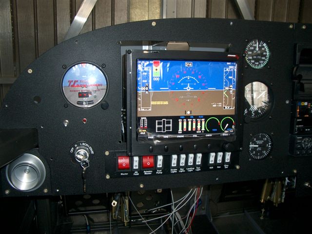

I've been waiting years for this post!
OK, here it is. Nothing's wired for real, but the EFIS is running off of my power supply.
Cheers!

Alt electrical source
Guy, I see an alternate elec source switch, I think? Is tha dual alternator or batt backup? THx.
What is your general mission? Night VFR? I ask, as you've pretty much stolen my RV-9A panel plan ;)

My general mission is day/night VFR. I'm using a single battery and alternator with an endurance buss similar to Aeroelectric Z-11 (I think). In case of an electrical issue, I can just pull the alternator field breaker (if it's not already blown) and switch to the endurance Buss. The AFS 3500 and GPS have their own internal battery backups, however the EFIS will still be on the endurance buss.

I like this panel design.
Beside the obvious aesthetic value of the symmetrical design, it's clear that you've thought about operational issues.
For example, you put the seldom used functions/switches on the far right where they won't usually be operated in flight. The other switches are grouped so that you operate them just by feel without looking. You've also left some blanks for the inevitable panel upgrade.
Of course, the EFIS is right up front and centered where it should be.
The only concern I have is that the GPSMap may be hard to read unless it's right under your nose. My 296 is difficult to see with my tired eyes. If this is a problem, an angle mount may help.
