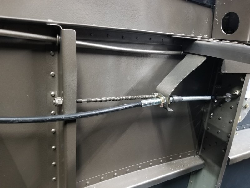

Lots of things getting done since the plane was moved to the airport last March, including those dreaded spar bolts which are surprisingly easy to get in, but much harder to torque down (the bottom ones). Pulled the plane out today to test the nav antenna that is in the right wing. The Eastern Iowa Airport has VOR/DME 3 miles west of the airport and I was able to tune in and hear the morse code. Many more things to do but still hoping to fly in a couple months.

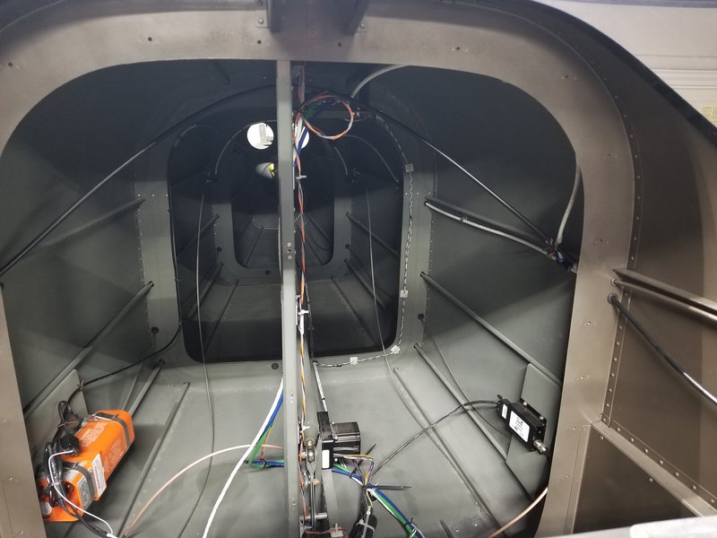

Panel Update
Finally getting around to cutting the panel. Going quite well with a jig saw and circle cutter

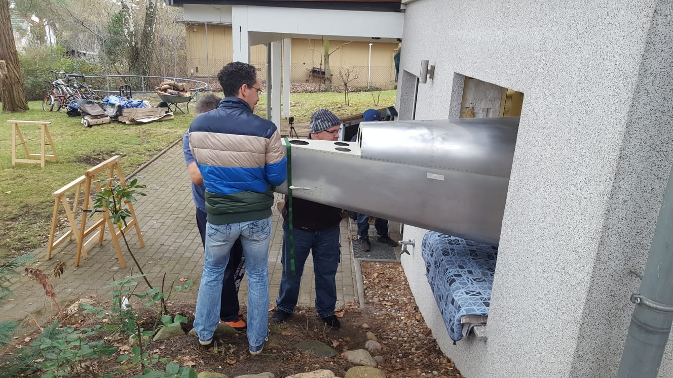

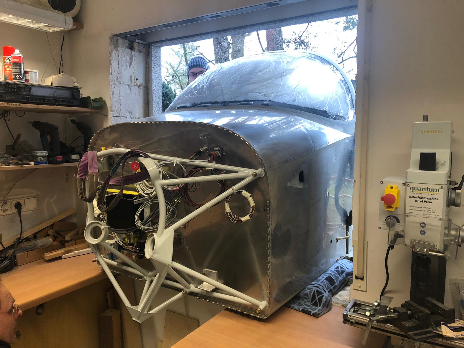

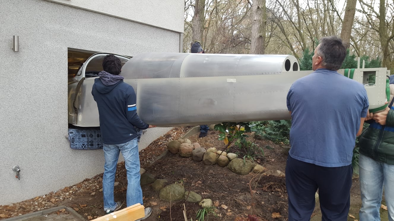

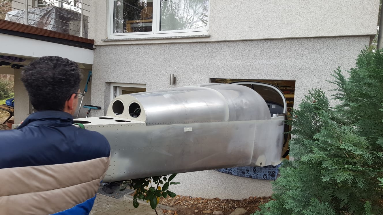

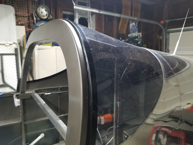

Get out of the workshop
Mission Windows successfully completed today.
The window frame had to get out so that the fuselage could leave my workshop in the basement. Now it goes to the painter.

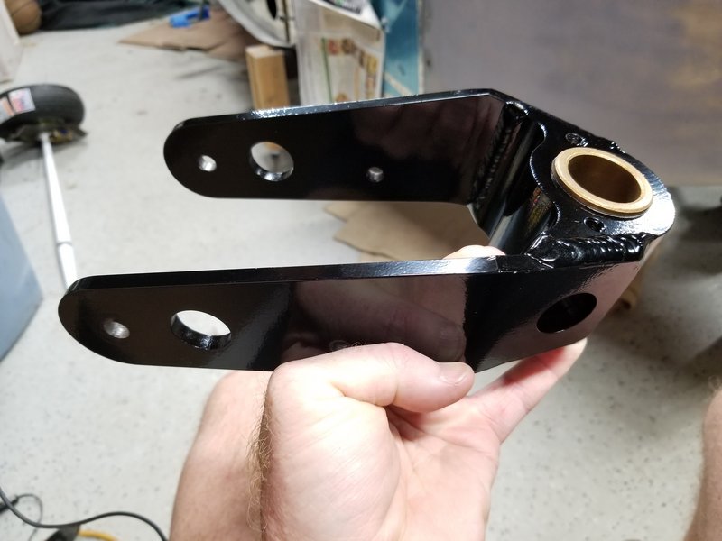

Powder coated front wheel bracket
Having too much fun powder coating things. I took my baffles elsewhere since they wouldn't fit in my little oven. Now the wheels will go on. I could wait, but I'm excited to do it and I can work on the wheel pants etc while I figure out how I'm paying for my panel:D.
I think DIY powder-coating is cool, but I will offer one comment regarding something that a lot of people don't know about.
Highly loaded parts like a nose gear fork (engine mount, landing gear leg mounts, etc.) sometimes crack. Looking for cracks on these types of assemblies is one of the things done during a condition inspection.
Painting or powder coating these types of part with a dark color (black being the worst), makes cracks nearly invisible.
That is why all parts supplied pre-powder-coated in the kits have always been very light grey or white.
Well guess I made a rookie decision on the black powder! If i knew that a few days ago I would have picked a different color. Thanks for the info!

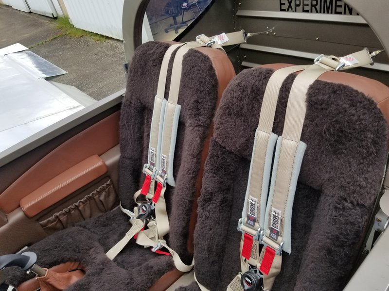

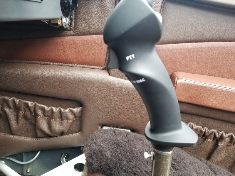

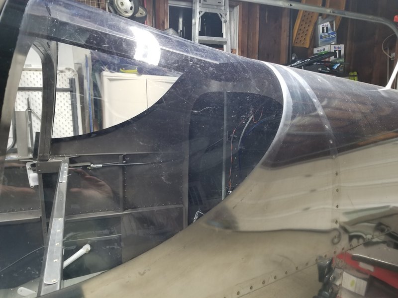

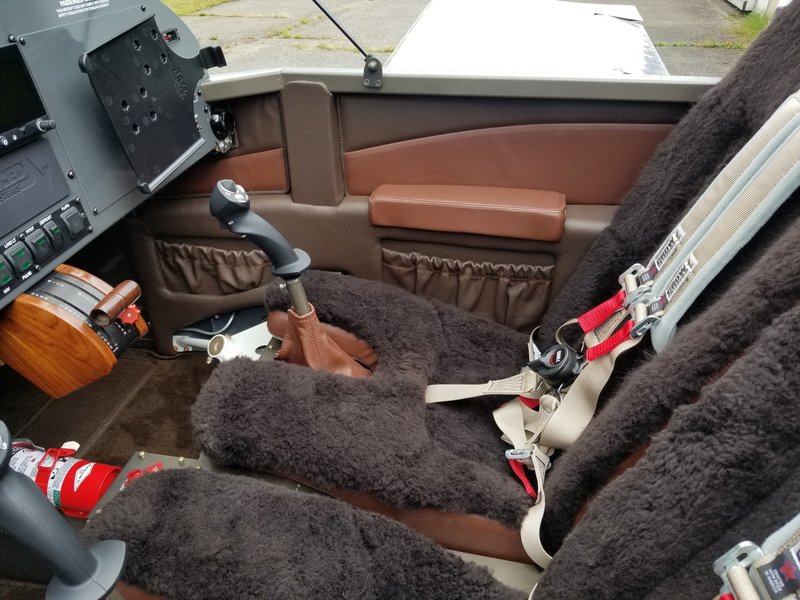

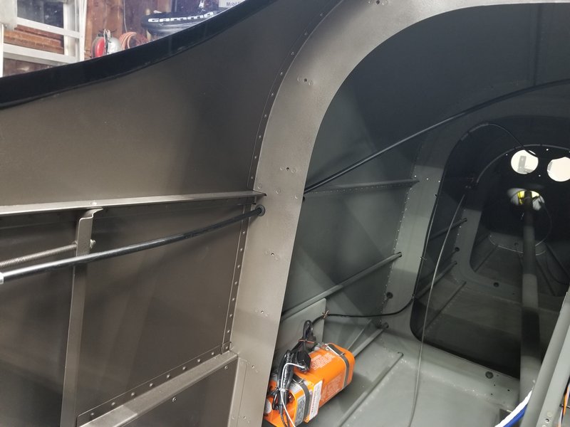

Almost a 14 mod done and rear window installed
I just finished the install of the Almost a 14 mod. I had it done once, but I chose to install the aftermarket flap motor and that doesn't jive with the lower bar that's needed with the mod. I ended up installing the push pull cable. I had to make custom brackets to hold the cable on each side. I think it came out pretty good for an amateur. I also just got the rear window installed with sikaflex. It's not cosmetically perfect(look at Bruce Hill's and Bruce Swayze's sites and you'll see what my goal was) but is good enough. Thanks to the 2 Bruces for their great build sites!!
One step closer. Should be flying spring 2022.
Your picture is pushing me to install my interior package. I thought I was OK leaving the side panels off and got used to it. Very nice work. I haven't seen the carpet on the areas around the seats and center. I may have to consider that.
Very nice. I installed the AeroClassic seats and interior in my 9A, I was quite happy with the finished product.

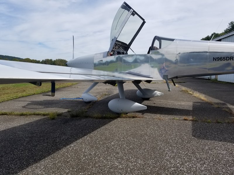

Assembly Complete
Things left to do:
Calibrate fuel senders, calibrate magnetometer, run engine.
1121 lbs.
IO 360 M1B, Hartzell prop, full Garmin panel, Classic Aero interior.

Nice. It is a good feeling to be finished - well at least finished enough to fly! I guess we are never really finished. Have a great phase one. Good luck doing the fuel calibration with the g3x. I have done mine several times and still not as good as I would like. If you figure it out, let me know!
Things left to do:
1121 lbs.
Feelsgood when the list of remaining steps fits on a single paper!
Congrats
Things left to do:
1121 lbs.
Congrats.
I hope I am only a few months behind you.
Are you going to bump up the gross weight to 1750#?

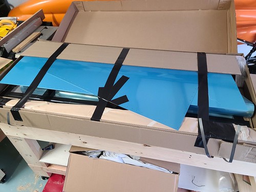

Received my Empennage kit today. I am taking the EAA sheet metal class next week and will get started after that.
You will love the process and results Brian! The Empennage kit is the most memorable the feel of accomplishment will be unmatched.
I would suggest ordering wings right away if budget allows, followed by fuselage order to be ahead of the game.
Good luck happy riveting you won't regret a second. Don't ask me how I know :D
Thanks. I ordered the wings at the same time as the Empennage I should have it early February. I figure I will get started on the wings and then order the fuselage. I am a bit space constrained so I don't want to get the fuselage until after i get the wings finished.
