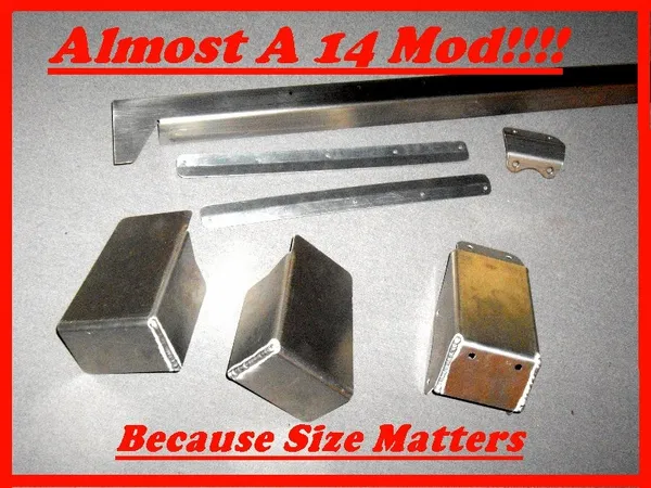

One VAF poster says “The forward position of the Almost a 14 Seat Mod is the same as the aft position of the standard configuration.”
That looks exactly like the solution to my issue... I have to see if it will work with the extended slider tracks I have in the plane.
Flyboys says:
Q: Can the Supertracks be used with the Anti-Splat Almost-14 mod?
A: Yes, these two mods play together nicely. In a rare case, we’ll sometimes have customers have issues with a fastener from the Almost-14 mod interfering a little bit with the S-tracks. It’s up to you to figure out how to deal with that but it shouldn’t present much of a problem for a person who has built the rest of an airplane!
I have the Almost 14 mod and Supertracks in my RV7. They work very well together. From your description, it sounds like the Almost 14 mod is exactly what you need. With the Almost 14 mod and the seat in the aft position, the canopy doesn't slide back quite far enough to work well. The Supertracks mod fixes that.

Also, we've found that many of our taller RV-7 and RV-9 customers have benefited greatly from installing the "Almost A 14" mod from Antisplat Aero. With that mod, you can put our Aviator frame in the rear most hinge (for max leg room), and have at least as much recline angle as the stock seat. That may be a good solution for you. Looking forward to hearing from you

Luke - Thanks so much. Please be assured that I have nothing but admiration for your products and the work you do. I've ordered the Anti-Splat kit and it will arrive on Wednesday. I'm looking forward to installing it and seeing the difference. I know subtle changes make an enormous difference. For example, I have carbon bucket seats in a sports car. They were okay - but a common mod is to install a 1" lift at the front mounts. It sounds trivial, but the difference is monumental - I can drive the car comfortable for 5 hours which was simply not possible before.
