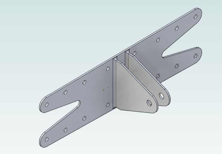

I've been evaluating an integrated doubler/hinge pair that I could locate on the aft side of the spar and rivet in place (w/Cherrymax rivets) without removing any skin rivets.
Here's the part I've been thinking about. It would be machined from a hunk of 4130 alloy steel (same material as the current hinge brackets).
I'd like to structurally bond it in addition to rivets to reduce the likelihood of cracking of the spar at the rivets holes.
This is still a "thought experiment" though it is gaining momentum within the confines of my mind.
Please share your thoughts, critiques, and ideas.
Your design does not include the nesting effect that puts load directly into the spar flange and skin. This is an important feature of the factory design.
Also, to machine that from billet would be mightly inefficient - starting with a block over 2" thick and taking most of it down to 0.06". But you could cut it out with wire-EDM pretty efficiently and if you nested them on the block of material there would be relatively little waste.
But as I said, you do want to have the nesting feature of the factory doubler.
Hi Steve,
Thanks for the reply. I have been considering how to tie this part to the spar flanges in addition to the web. There are 2 issues that hamper this approach (for me):
  • Tolerance stack-up prevents my design from simultaneously aligning the part to the flanges and putting the pivot hole in the proper location.
  • My HS rear spar is dimpled so it would be challenging or impossible to get a flanged doubler to contact both flange faces simultaneously. How are others with dimpled spars approaching this issue?
If I pursue this approach, I will have to accept that possibility of finding cracks at some future inspection. The question is: is it enough better than the legacy design to be worth the cost and effort.
Regarding the block of material required to make this, I agree there will be a lot more chips than part when I am done. The finished part will weigh about 0.2 lbs while the stock will weigh around 7 pounds. Wire EDM and nesting is a good suggestion. I will explore that.
Thanks again,
Dean
Hi Steve,
Thanks again,
Dean
If you are determined to eliminate the flanges (something I would not do....) why not just cut the flanges off the Vans kit and use it? Sure would save a bunch of machining.
But I would use(ed) the Vans kit as is and invest(ed) in an artist brush for painting a few rivet heads. :)

Hi Sam,
Your installation looks great. As far as I can tell, your skin is machine countersunk so you were able to nest the flanged doubler tightly between the flanges of the spar. With my dimpled spar, I don't see a means to do this. (Finding a way to get around this issue could change the way I approach this.)
I did consider cutting the flanges from Van's retrofit kit, but key to my concept is to tie the hinges together with as few point loads (rivets) as possible. (In part this is to partially compensate for the fact that this concept does not tie to the spar flanges.) I thought about welding hinge "ears" to a flat plate to eliminate most of the machining, but am concerned about holding tolerances and confirming the quality of the weld.
Dean
Hi Sam,
The skin and spar are dimpled. I countersunk the doubler flanges (the installation docs say to dimple it if I recall correctly) and pushed the doubler into place, it fits very nicely.
I used the RV6 PRE PUNCH kit on my aircraft and the nested doubler fits perfectly and tightly. My skin and spar flange were dimpled and I dimpled the nested doubler as well. Once the six top and six bottom skin to spar rivets are removed you can push the doubler in place. The spar and skin have enough give in them to allow the doubler to be pushed into position past the spar dimples. It takes a little force to push it in, but mine "snapped" into place and fit perfectly (thanks Vans!). In fact it is a little tough to remove from the spar after test fit. I was also concerned with the "dimple interference" when I was pre gaming the job in my mind. In actual practice it all worked out without a hitch. Hope this helps and you have a similar experience.
My concern with the dimples as well. In my case on the 4 ( non prepunched) I have to drill the nested doubler using my spar as a template then dimple the doubler. Not sure how to do this without a loose fitting doubler?
Duff
Duff
There is enough flex in the spar and doubler flanges to fit the doubler in place for match drilling. During one of my test fits the countersinks in the doubler weren't matched with the dimples in the spar and I was able to move the doubler as needed. No need to over-think this. :)
Dean
Dean, if the bending loads from the hinge flange are not transferred to the spar flanges then the skins will not be carrying the load, they will just twist the spar web until the load is distributed via the spar web. This is the loading that caused the cracks.
I am not sure why Vans chose to redesign the fix and eliminated (what appeared to be an elegant fix) of the first hinge redesign . . . but knowing Vans, they did an FEA and looked at the actual loads and the tension/compression to the skins in the process. That could be the only reason (my brain) they extended the aft "nested" piece to include more rivets on top and bottom to transfer that load. Unless you take all this into account and consider the stiffness (modulus) of steel vs aluminum, a TLAR design will not likely equal the benefit of SB design.
Honestly, I have no cracks (250hr) and will likely just wait until one appears to do the modification.
Hi Bill,
I missed Van's first (elegant) re-design and am only familiar with the current SB. (I recall hearing about the change, but missed it before it was replaced.)
The fact that so many aircraft have flown so long (and undoubtedly some flew with cracks for a while) without structural failure indicates the original is strong enough for the loads, but is cracking due to fatigue cycles. I agree tying the hinge to the flanges and skin is a good fix. I'm interested in potential fixes that don't involve the skin.
If I can accept the legacy design is almost good enough, is there a solution space that brings me to good enough using only the spar web. A one-piece, steel hinge assembly/doubler may distribute the load (even more so if bonded) over a greater portion of the web. If the ears are integral to the steel doubler, more of the bending loads will go into the entire steel doubler rather than the two small footprints of the legacy hinge brackets.
I don't know whether or not I have cracks, as I won't get my plane back from the painter until next weekend (if all goes well!). I'm not likely to have cracks as the HS has only 40 or 50 hours on it. Like you, I will have some time to keep an eye on it, consider options, and move ahead once I am comfortable with a plan.
For those that installed the flanged doubler, was in necessary to access the forward side of the spar to match drill the holes for the hinge rivets?
Thanks for helping me think thru this issue.
Dean
The issue is that the elevator hinge creates a point vertical load and its associated fore/aft moment needs to get reacted into the skin with a fore/aft couple into the skin. The spar web has flanges that attach to the skin and transfer the load into the skin forming a closed cell torque box. (With bigger loads this would be helped out by a rib backing up the fitting and spar web with multiple fasteners to get that couple into the skin.) It is not a “bending” load as you describe. It is a vertical load and moment couple between upper and lower fasteners that attach the fitting. “Thicker spar web” may help with the load at the rivets attaching the fitting but then that load is transferred in the spar web through the rivets and goes around the 90 deg bend in the spar web to get to the skin attach fasteners. Going around that bend is the material thickness of the spar web and therefore a prime location for crack. A doubler may solve the current crack location in the vertical web of spar but will probably cause new cracks at edge of the doubler in the corner of the 90 deg flange that attaches the skin. If you think this through it is pretty intuitive. In my opinion that corner is the fatigue detail that Vans second iteration in the repair SB solved by having the new doubler nest and pick up skin fasteners.
Putting a large steel plate on the spar web may have another negative consequence related to horizontal tail bending. Bending due to lift on the tail is a reacted into the skin in a inbd/outbd couple (not fore/aft couple like i explain above for the point hinge fitting load) The spar is aluminum of a particular web thickness and a particular stiffness. All of a sudden the bending inbd/outbd in the spar web hit a very very high increase in stiffness of a steal doubler. Rapid increases in stiffness is prim location for cracking. This is why spar always taper in thickness changes. Think of tree branches always break at intersection to thicker branches.
No good engineering is ever presented without its caveats.
-A freebody diagram would be helpful for both of these I explain above but I am on vacation with only an iPhone to write this response.
-I am a structural design engineer so some strength engineer my give a better explanation, since they always want to prove us designers wrong.
