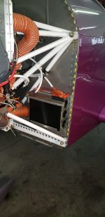

Here's what I ended up with on my 14A with exp119, single alternator. The extra layer over the firewall is Dan Horton's firewall insulation kit.
No issues with cowling installation but it's close to the oil pressure sensor line. Your EarthX battery may be a bit taller than what I have installed.

I am putting the second battery on the left side somewhat symmetrical to the Vans standard location on the right. I don't plan on using the master & starter relays in their stock location, as Im installing EFII. This gave the opportunity to use some of that space for a second battery. I toyed with the idea of using the smaller size earthX battery to allow more mounting options, but decided against it, due to concerns with needing a battery while on a trip. A standard size box, just gives options. I did lower the second battery a bit to not interfere with some of the other firewall mounted stuff like the sensor block on the top left. I also decided to use nutplates to mount the battery box instead of riveting it in place. I wanted to be able to move it out of the way in case some significant service in that area came up. One issue to deal with was a pre punched firewall penetration for wiring, and the holes to mount the relay doubler. When I created a bubbler for the battery box mounting, I incorporated a patch for the wiring hole. Sorry, I don't have a snap with the box in place, but I think you will get the general idea from the below pictures.

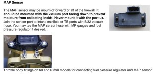

This is mounted pilot side FWF low. I would not recommend this location but higher up on the firewall. (30 degs cooler higher up) Mount slightly lower than you have it and blank off the passthrough and relocate.
Can't remember the source but I was told it isn't a good idea to mount MAP sensors low, moisture in the lines could potentially drain downward into the sensor & ruin them.

Of course, can't remember the source. :rolleyes: Somehow, I doubt moisture is an issue with temps operating in the 160 F (20 mins after engine shutdown) range plus a blast tube. To date over 700 hrs. and 6 years no issues with these sensors. (Checked every run-up preflight)
Here’s the source. I’m not sure how you would mount it “down”. Most installations I’ve seen are on the firewall with the ports ‘forward’
