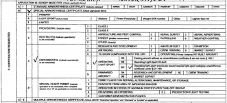

I didn't do the S-LSA to E-LSA conversion but I do have the paperwork (PDF really) chain from the FAA for my RV-12. All my Airworthiness Certificates were/are "Special Airworthiness Certificates" as Paul rightly pointed out. On the certificate as an S-LSA Box A "Category / Designation" is shown as "Light Sport". As an E-LSA Box A is shown as "Experimental Light Sport". A little punctuation like "Experimental - Light Sport" might have been clearer.
Here is part of the application for change that may (I said "may") make all this a bit clearer...
