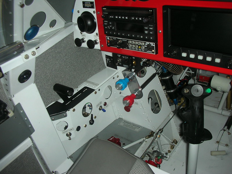

Hey @fl-mike - I'm just finally getting around to thinking about doing this. Here's a pic of my current throttle Quadrant. You mentioned that the Formation throttle quad would be a "drop in" for mine.
However, the "formation" throttle quadrant is rounded at the top compared to mine.
I'm not sure this would "drop in". Am I looking at the correct one from DJM.

The "formation" quadrant has a separate throttle friction adjuster from the mixture/prop friction control providing better friction control.
Thank you. From the picture, it looks like you can adjust the friction on 2 of the 3 controls. Is that right?
