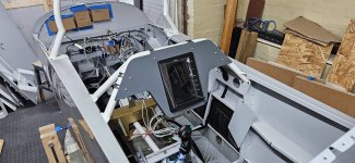

It can be done
With very little effort and is pretty straight forward. Here are shots of mine (flying now). I did install an independent shutoff switch so it could be disabled if not used or abused.
First shot is the mock up and second is live. I did do some minor adjustments later, but it works well. Very convenient to have the GIB handle the radios, watch for traffic, change squawk....or just fly the plane without having to look over the shoulder.

I have a 7" display in my RV8 BackSeat as shown Below, it is fully connected via CANBUS to my front display so can navigate, access attitude and engine data, display Aircraft cameras, has full moving map, etc. Unit only needs Power and CANBUS connection, so wiring is simple. What is of note is the way I installed it (Leg Cut Outs) so climbing in/out of the RV8 Back Seat is still humanely possible for adults.
Also shown below is Vern Littles displays that can process several EFIS data out formats, based on an Arduino CPU), of note here is that these displays can can cycle through multiple data display options as shown (not single purpose) just using the G3x data.

Confirmed that a fully functional rear seat display is feasible and should not be too difficult to install.

I also have a G3X Display in the back. Also a Flap Switch is mounted there so a Passenger / Copilot can fly from the rear. In case I fly with a child I have a switch in the front to disable all the stick and flap switch functions.
I used some 4130 flat material and welded it to the rollbar. Then I made a panel which screws into the flat material which also acts a a spacer for the seatbelts of the Pilot. Works quite well and if I fly with a pilots frined he can adapt the flightplan, switch frequencies and use the autopilot. I would do it again.
