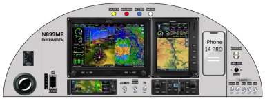

Howdy all, Trying to make the final purchase on my avionics. I have friends who say get 1 G3X and 1 GTN750. I have others that say get 2 G3X and a GTN650.
Both will fit, both are about the same cost. GTN750 requires a G5, twin G3X requires a battery back-up and AHRS. I need an IFR capable machine for occasional use, likely not flying to minimums, not my style. Pictures for visualization, stolen from this site.. Just looking for the votes on what the consensus thinks. GTN750 offers better button navigation for loading FP's. However, twin G3X's offer a slew of configurable real estate. Thoughts?

I use a single screen for occasional IFR to minimums. I find it totally adequate. I would also consider ditching the 507 and using the auto pilot control from the screen. message if you want to chat more offline.

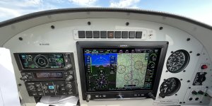

I'm in the process of installing a GDU460 (10" screen) and GTN750xi in my RV-8 for several reasons. I don't like how low the double screens sit on the panel. I much prefer working on the 750 over the 650. There's nothing a second G3X screen can display that I can't display on one G3X screen and a GTN750. I also want a G5 for the dissimilar architecture to the G3X and built in back up battery and ADAHRS. And as you mentioned, the price works out basically the same.
Here's my layout. I don't put the 750's top bezel in line with the top bezel of the G3X because I want the tops of the screens to line up because I think it looks better (the screen will stand out a lot more than the bezel when on and it makes scanning back and forth between the screens easier on the eyes) and also it lets you put the G3X even higher.

After much gnashing of teeth and looking at all options for my RV-8 panel upgrade, I went with a single screen G3X, a G5, a GNX-375 with the transponder and ADS-B, a Garmin GMA-245 comm panel, a -507 AP controller, and both a panel mount and remote mount radio for dual radio capability.
I fortunately got to fly other people's airplanes with different setups before making the decision. My mission statement was "ease of use, occasional IFR if needed to get somewhere"..... but I wanted as much ergonomics and less "Menu hunting" as possible. Dual radios and a comm panel for me was a must because I do a lot of formation flying and not having to dig into several menu layers in the G3X. Dual radios also allows me to talk to my wingmen while also easily flipping over to talk to ATC or picking up ATIS, etc. I didn't like when I flew friend's airplanes and I had to go into the G3x menu a couple of layers deep to change the radio volume, or do things with the AP, etc. The audio panel made it also really easy to swap radios and customize the layout. I also have "radio swap" for the primary radio mapped to a button on my Stick grip. That one thing is about my fav feature of all, especially when in Fingertip and I don't really want to have to look down into the cockpit to swap radios.

Thanks everyone, this helps a lot. I think I'l convinced not to get all stupid with a double display.. One additional question... as 90% of north Americans are right-handed, I personally want my right-hand dexterity when operating these complex devices, and much of that time I'd imagine I'll have the A/P on, so my right hand is free.... But almost every single screen set-up I see has the radio stack on the left side. Does everybody just get used to the left-handed radio interaction?? Seems a bit more difficult, even in my decathlon, I often grab the stick with my left hand to tune radios with my right.. Thougths?

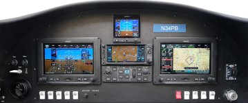

I like your panel layout.
What does the iPad give you that isn’t available on the G3X?
Would a second G3X serve the same function, or is there an advantage to using the iPad?
I ask because I fly every day at work with two displays and an iPad (iPad primarily for charts and weather). But it seems like a G3X would be capable of both of those tasks…
I have two 7" G3X displays in my RV-8, plus the GTN625 and G5. Do I miss the larger display? Sometimes - but it's pretty nice having semi-redundant units:

I like the weather and data acces better on the ipad. Also a true sectional. Ialso set up the g3x as track up and the ipad as north up. Much better awareness and planing enroute imho.

Honestly, I very rarely fly with the iPad now that I’ve gotten used to the G3X interface. I like to have it on XCs because it’s easier to search for stuff and to make quick route changes and then “send to panel”. The iPad also has better overlays for current stuff like NOTAMS, TFRs, etc that the G3X is not going to have. But for local flights or even breakfast XCs, I don’t even bother with the iPad now.
And no, I don’t think a 2nd smaller G3X would be better. I really like the big centered display.

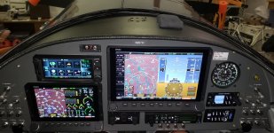

Thanks for posting a very nice panel pic. I'm considering locating avionics as high as possible to maximize my view of them, but also to see if I can cutout the lower part of the panel for stick clearance if I want to increase the height a little. I think 1" would be easy, and more would be possible, depending on how much stuff needs to be in the radio stack. In my plane, the ergonomic improvement of more stick length seems clear.
How did you get the GDU 460 so high?

Here is my layout
GDU460, GDU470 high on the panel with a GNX375 and GMC507 below. Remote radios. Dual ADAHRS. My thought was to keep my primary displays high which is what I use 90% of the time. Only need true IFR capabilities rarely.
Ditto on your recommendation Ben. The only thing I'd do differently is reverse the750 and AP controller to the right side and the G5 to the left. Unless maybe you're left handed... But the mechanical aspects of your right hand to the 750 and AP makes more sense to me. Yeah, I know, there is that thing about a control stick, but I still like my idea. Also agree with your "leveling the screens" not the bezels. I strongly recommend, as you do, the 750 rather than another G3X.
