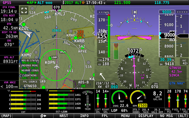

Sure, I’ll show ya mine…
Here is a screen shot of a typical long cross country cruise setting where “I want to get there but not burn a crazy amount of gas”. This setting gives me a comfortable four hours plus IFR reserves. If the trip is more than 8 hours (one fuel stop) I tend to break it up into two days.
This is a stock IO-360-M1B with AFP injection and dual pMags, and a standard Hartzell BA CS prop running a little LOP. The injectors have been balanced. I sometimes burn 93 ethanol free unleaded when I can get it - perhaps as much as 50% mix with 100LL.
Go higher and fuel flow goes down a little. Go faster an fuel flow goes up a lot. I fly at the altitude that is best for winds (or mountains), but tend to not fly below 6,000’ or above 14,000’. I’ve tested up to 17,500’ and the plane did fine, but the reduce engine power is a significant downside for going that high.
I’ve played with RPM down to 2400 or so, but find for this prop 2500 RPM gets me a knot or two more for the same fuel burn. This is something to explore on your ship.
