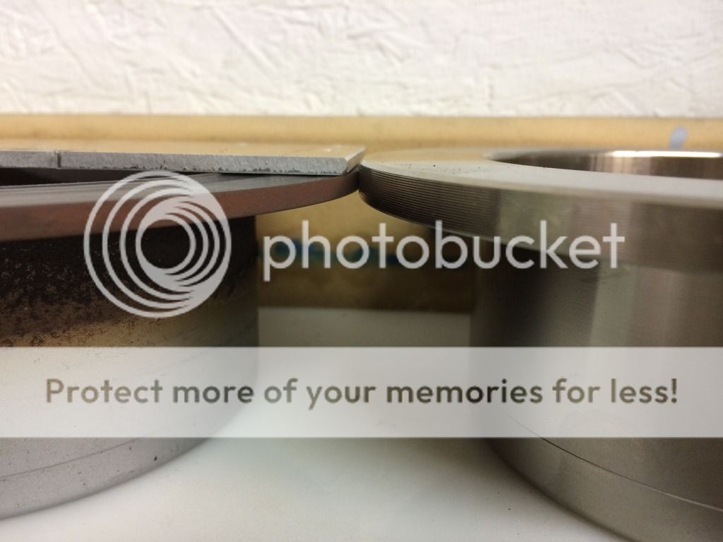

I was just looking at the disc today on my 7. It is pretty close to the bracket - so the question on the extra thickness - it still the same center or on the outboard side?

I think think majority of the additional thickness is on the same rotational center as the original disk. This is a picture of the old disc and new disc side by side with the 1/8" thick material I made the spacer from on top of the old disc.
