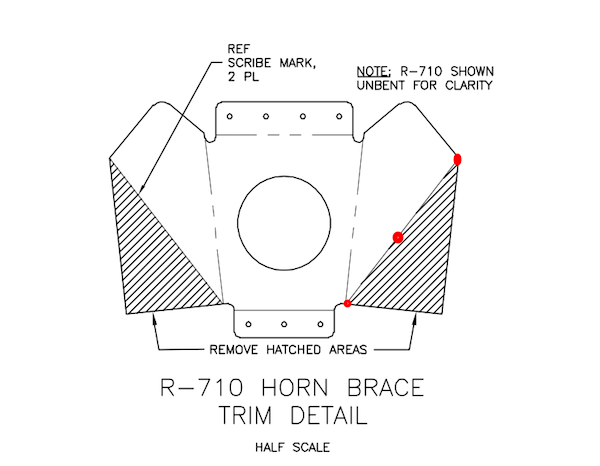

R DWG 7, R-710 Horn Brace Detail View
Be very careful when trimming to the middle of the whole like the plans tell you. Very likely going to cause an Edge distance issue. I would advice to cut very conservative here to the top of the whole and only trim until it fits even if it leaves a "half whole" in the center.

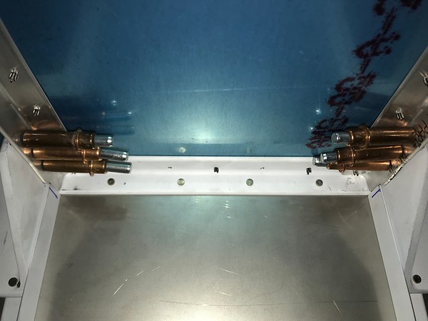

Riveting leading edge to spar solution
On the RV-7, the plans call for riveting the leading edge to the spar AFTER the main ribs have been riveted to both spars. The problem is, these AN470 rivets are difficult to set because the head is too close to the web of the main rib...even using an offset set. From what I have gathered, most folks get around this by using blind rivets (Van's approved method).
I figured out a much better/easier way to do it without having to use blind rivets. Here's what we did today on my second wing...it was so easy, and it turned out perfect!!:
1. When the instructions tell you to rivet the main ribs to both spars, you can do so....EXCEPT for the ones directly behind/underneath the leading edge. Just cleco these to the main spar (6 of them). It's ok to rivet them all to the rear spar
2. After building the leading edge and ready to install, place it on the spar and cleco in place. Start at one end of the leading edge and un-cleco the main rib directly below it. Bend it out of the way enough to give yourself room for the rivet gun. Rivet the leading edge rib to the main spar. When you are done, cleco the main rib back in place and move to the next leading edge rib. Repeat this until all 6 leading edge ribs are riveted to the main spar.
3. Now you can now go back and rivet the 6 outboard main ribs to the main spar. You will probably have to use the offset, but they are easily reachable.
Hope this helps.

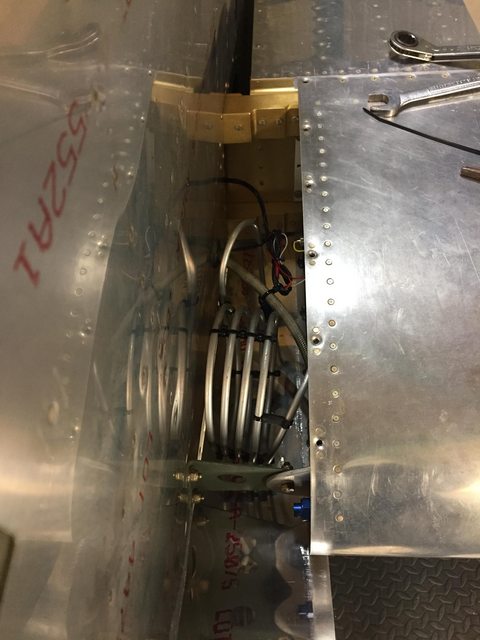

Beringer brake system
This one is for anyone installing the Beringer brake system.
The brake lines are braided. Fittings are straight 45 degree flare and banjo style. Banjo fittings have a slight angle which comes in handy.the system comes with Master cylinders, ALIR (anti-lock) valve and parking garage brake. I won't get into how or where things should be mounted. Beringer does not provide a parking brake mount. The reservoirs have a small flange for mounting. This is intended as tips for the install.
The ALIR is quite long and if mounted with the included mount, is very close to the firewall recess. Check before installing it. I chose to leave it out and save two lines, some complexity and extra weight. 12 ounces.
The master cylinders are adjustable. Install the extenders then screw the rod ends all the way in. I used five turns out on either end. There's plenty left to adjust the pedal location. Final hole in the brake pedals was 3/4" from the bottom. I drilled one with a pilot hole then used it to match drill the others, then enlarged to final dimension. The springs get close so use two washers in between pedal and rod bearing. It's shown on the RV10 install.
Here's a tip on making the lines.
Wrap the line with a piece of Gorilla tape. It helps control the fraying. Cut the end clean with a pair of heavy pliers like Kleins. Remove the tape. Carefully slip the threaded ferrule over the line. Use a small screwdriver to spread the braid open in a cone shape about 1/4" back. Don't unbraid it. Just open it enough to get the "olive" on the tube. Place the olive on the inner tube and press against a hard surface till it bottoms. Use a tiny probe to feel the inner tube. It should be up against the top of the olive. Use the cutters to snip the excess braid back maybe 1/32" or so. It helps later. Slide the ferrule up. Lube the threads of the banjo. Insert and screw it in hand tight. Clamp it between wood blocks in a vice and use tubing wrench to tighten couple turns. Finish off with the torque wrench. Note the tubing rotates. This is a big deal.
To complete the line, install the partial line. The angle is important and the tubing rotates so think this through. Place the other banjo in the fitting where the opposite end will be installed and get a good measurement for the line. Wrap a piece of tape, mark the cut line and the direction of the banjo angle . Remove the line. Cut the line.
Repeat the steps to install the second fitting but don't torque it. You only get one shot at it.
Install the line and triple check the fittings are oriented correct. Mark the first end so you can't accidently torque it again and mess up the orientation. Mark the second end carefully. Move to the vice and torque while watching the mark. Stop short and reinstall it. Back to the vice for final torque and a little prayer it ends up perfect. Repeat another six or eight times for the other lines.
I chose to go with one piece lines from the parking brake to the calipers so I snaked the line in and cut it a foot or two long then reinstalled it. The last two fittings at the caliper end will have to be done on the plane. Best of luck.

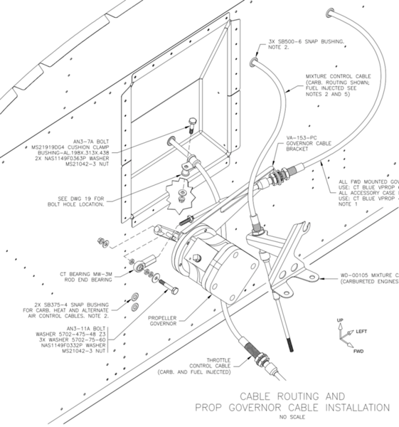

Firewall DWG 19
This one is not really a gotcha as much as just something I wish I'd been aware of at the time. Would have saved time and a small bit of frustration at having to un-do and re-do work
When working on your firewall at the start of your fuselage kit, DWG 19 is the reference. (Page 8-1 in the manual). If you follow it in detail, you'll end up setting several rivets that you will later have to come back and drill out. Also, there are a couple of rivets you'll need to add later where you'd like to be able to dimple the firewall but won't be able to. Instead you'll have to countersink.
Again, not a show-stopper, but something where a little hears-up would have been very nice.
Which rivets? Those for attaching the battery box, the two relays and the brake reservoir. Here's where to look for specifics:
See either DWG 31 or 31A (tail/nose dragger depending) for the battery mount. It makes sense to go ahead and install the nutplates when you are riveting the firewall.
See DWG 36 or 36A for the brake reservoir.
See OP 32 if you are planning a fuel injected engine. It requires a different doubles in a different location that the carb setup shown on DWG 19. (Mentioned by a previous poster but I thought I'd include it here.)
Hope this helps..
-Ivan

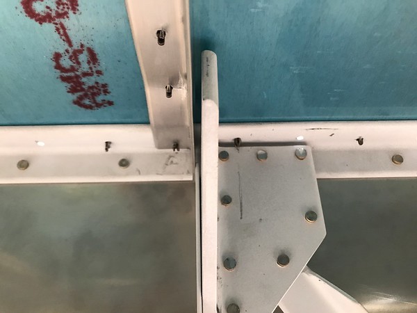

Riveting order on elevators. E-703 and E-704 to E-702
I have attached a picture with a red arrow. The plans have you rivet E-704 and E-703 together before attaching to the elevator spar. However, when you go to rivet these ribs to the elevator spar you can't get most squeezers on these two rivets and they are difficult to buck as you need to use an offset tool. You can avoid this problem if you FIRST rivet E-704 to the spar and then rivet E-703 rib to E-704.

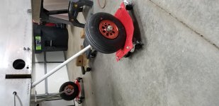

R-911 Rudder Bottom Fairing for RV7
This is for the RV7 only. When you are fitting your R-911, make sure you take the tail wheel spring into account. The diagram shows a 3/16" distance between the spring and fairing. I dont think this can be accurate. When the tail is on the ground it is going to flex some. I have 3/8" on mine and I'm comfortable with that. I have seen other posters here that have as much as 3/4".

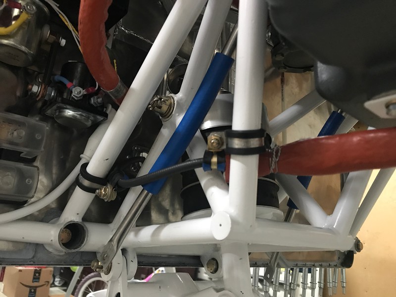

Roll Bar Bolts
I'm suprised you couldn't hear my cursing all the way from Estes Park.
The Aft bolt (1/4") on each side of the 7 roll bar has a washer and nut installed under the longeron. It has a special aluminum shim then washer then nut. It was easy with the fuse upside down but right side up, gravity is not helping. Somehow this has to be done in a space barely big enough to get my catcher's mit fingers in the space. The aluminum shim stays put pretty well without persuasion, but the washer wants to fall off before the nut can be slipped into place.*
I needed a trick. Neodymium magnet to the rescue. This time two of the uncoated magnets. Place the magnet on the bolt head. Slip a washer on the bolt and it stays put. Slip the nut in the space. Say a prayer to the Nut Gods. Stick your toungue out so words don't offend same Gods, then gently rotate the bolt with an open end wrench (magnets are stuck on the bolt) till it grabs a couple threads.
Yes, I've heard of builders glueing the assembly then turning the bolt into the part, but one mistake there and a cross thread nightmare ruins the day. After years of wrenching in cars, I learned to always use human fingers to feel the threads engage properly.
Used the magnet trick more than once. The left aft baffle for my IO-360 has a lower inside bolt/spacer/nut securing it to the case. I used a zip-tie/hose loop to hold the spacer in place while the bolt was inserted, then used a magnet wand to hold the nut/washer and screw the bolt into them.
