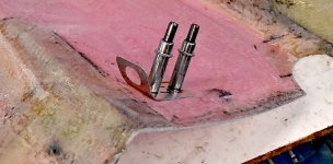

The cowling’s Mil-Spec quarter-turn fasteners are installed now. Still need to add the various locking elements. These quarter-turn fasteners are equivalent to Skybolts, the chief differences being that I had to make my own mounting strips and Mil-Spec seems to be out of business now. I started with an RV-4 kit for these but didn’t use them on the sides, deciding instead to use nutplates and screws. I have a number of spares now in case of an issue. I inventoried the parts and there’s plenty left for the sides, I I decide to change to them there.
Making my own mounting strips for the quarter-turn fasteners was a good thing. Mine are more compact than Skybolts and lighter, both plusses for this little RV-3B. On the sides, I laid up some glass to make glass flanges.
Up to now I’d been using clecos in the screw holes. Today I drilled them out to #19 for the #8 screws. I used a #19 reamer in the #30 holes and this worked perfectly. I got smooth accurate holes.
When I tried inserting the screws, I learned that two of the #8 nutplates had mysteriously shrunk down to #6. Probably I’d gotten them mixed up in the bins years ago. That gave me some practice removing rivets and installing new ones.
With AN525-7 screws and thin nylon washers, the cowl is finally secure. It lines up nicely with the cowl tool off, and I’m ready to move on. There’s some glasswork still needed before finishing, though.
