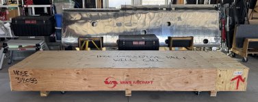

The box was delivered to our hangar by Catmandu and Karen and sits in front of the completed left wing.
Crate after opening with inventory list sitting on the corner.

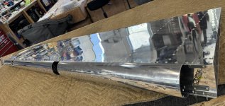

I was able to finish the vertical stabilizer in three part-time days of work. Probably about 15-20 hours mostly working along. Removing the blue plastic then remarking parts, deburring, and primering three pieces of thicker aluminum took about 2-3 hours.
This piece was a true joy to assemble and it put together very fast. No submissions to the Van’s builder feedback was needed. This vertical stabilizer kit meets the very high expectations that were set by Van’s for the RV-15 kit! I did have to countersink a lot of holes of two different sizes, just to get a taste of earlier building skills, I guess. There are also quite a few solid rivets, both flush and round-head, to squeeze. Boy, I sure appreciate our too-expensive hydraulic squeezer! But, no shooting of rivets was required.
Only one task was beyond my immediate capacity. A #12 reamer was called for on six holes and, perhaps surprisingly, we don’t have one. But, it wasn’t a show stopper. All of the holes will not be used until much later (maybe a year?), so an order off to ACS is scheduled next week, long before reaming those holes will be necessary.
The only other “lesson learned” was at the very last on page 6-36. I had been squeezing these rivets with two dyes until I reached the leading edge and the dye wouldn’t fit. I switch to a “no-hole” yoke, which worked great. I then realized that I would have had better success on all the rivets with the “no-hole” yoke.
This effort was really fun. In the future, I expect folks will buy and start the tail kit first and it will be a wonderful way to start! Working almost entirely alone, the total time spent on this sub-kit was probably less than 15 hours. Maybe more like 10 hours.

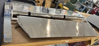

You basically build to assemblies: The rudder skeleton/spar, seen in the upper right, and the rudder skin with stiffeners. Once both are completed, the two are mated and the skin is closed out.
2. Although not described in the KAIs, Wheeler North (AlphaAlpha) had alerted us to the advisability of adding a soft buffer (he suggested ProSeal) between the stiffeners before closing the rudder skin. This would be between Steps 1 and 2 on page 07-14. While this is probably more important in fast RVs (and adds a very small amount of weight at the extreme aft end), I decided to do something similar. Paul suggested using black Right Stuff, which doesn't require mixing. This step was definitely a two-person job and we pre-briefed on exactly how we were going to do it so there was no putting together and then pulling apart. One person pried the two side of the rudder skin open wide (we felt a bit like dentists!) while the other squirted a glob of Right Stuff on and between the aft ends of the stiffeners. Once applied to all pairs of stiffeners, the skeletal framework was inserted, we ensured that the starboard side of the skin with the broken edge was overlapping the port side, and the skin was quickly Cleco-ed on. Planning it out ahead of time led to a very smooth and successful assembly.
Right Stuff is an alternative to ProSeal for providing a pliable buffer between the rudder stiffeners.
The little black dobs of Right Stuff where the stiffeners come close together are used to prevent cracks forming from vibration. Commonly done on "high-speed" RVs, we decided to add these dobs to the RV-15 rudder.
Completed rudder only took just over a day of work.

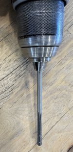

I did receive the #12 reamer in the mail today from ACS, many days faster than they had predicted. I reamed the 6 holes in the vertical stab and also called that Section 6 "complete" today.
Number12Reamer.JPG With this #12 reamer in hand today, I also finished Section 6.

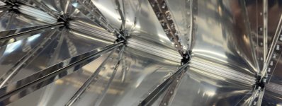

Like each sub-assembly so far, I completes a skeleton and then covers it. Here is the completed horizontal stab skeleton.

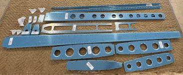

Thanks for the notes, Louise! Progress is looking good.
Were the HS brackets in your pic above unfinished, or did you choose to prime them? Mine arrived with gold anodizing:
The KAIs specifically say to Coat these parts "with a suitable corrosion resistant finish. The anodized finish on these components is not intended as a stand alone corrosion preventative." Thus, I primered these beautiful pieces. :( See Page 08-07, Step 5.
Interesting!! I had not read that yet.
I also have not put the strut attach points into the wing - same deal there?
I wonder what the point of that nice finish is…
Taping over un-riveted areas is how I do it. I use red electrical tape, which I only use for important notices to myself. It releases without residue anytime, at least the 3M version does, and if I see it I know something there needs attention.
Dave
That is really interesting as the anodized finish makes the aluminum highly corrosion resistant. There is a mention of "sealing" it, though.
