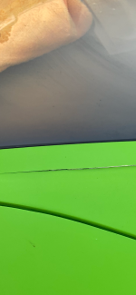

I also want to make a pitch for Jan's process of bedding the windshield in Sikaflex. It made for a very nice installation using it to make the fillet on the outside instead of the microballoon build up. And then on the inside, I made a nice fillet as well that prevents the deep crevice between the glare shield and windshield to help minimize the guck that can build up there over time.
Thank you very much :)
