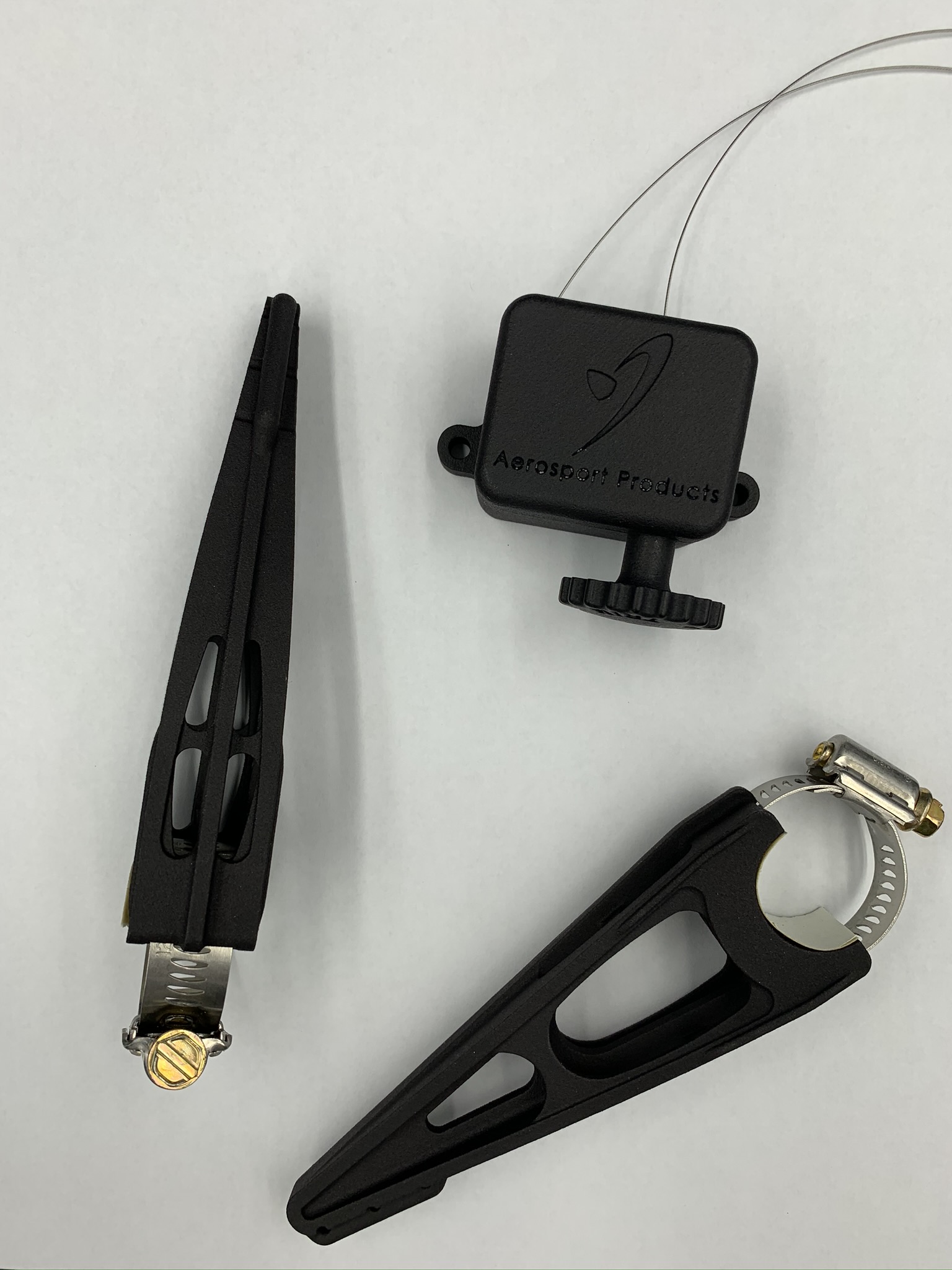

Aerosport products made mine and I have been happy with it. Spring bias system attaches to rudder torque tubes under the panel.
I installed the Aerosport rudder trim, but also installed the Garmin Yaw servo. The rudder servo works well so no real need to adjust the Aerosport trim. Because the Aerosport system is a bias spring set up, it helps prevent the rudder from slapping around on the ramp in windy conditions when fueling etc so glad I installed it.

I used the Aerosprt spring bias system but converted it to electric. Works well.
That said, once the center point is found, I haven't used it much.

I have the AeroSport spring-bias system--works great. I have it set up for cruise (ball centered, feet on the floor off the pedals) and never touch it. I simply add a little right rudder in a climb, and a bit of left for a fast descent.

I also have the Aerosport rudder trim. But I never touch it. I could remove it and I'd never notice.

3: Some sort of spring biased manual or electric trim (my choice)
