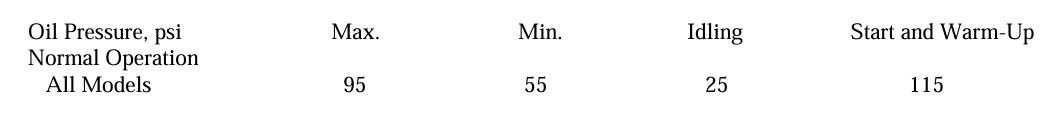

New to me -10. Oil pressure gets to 90psi on takeoff, especially if oil temp is lower, around 140 degrees, but usually settles in around 85psi during cruise with oil temp at 180 degrees. Is this too high? Does anyone have the oil psi ranges-green, yellow, red for the oil pressure? Maybe it’s just a matter of resetting my ranges as it looks like always pushing the red during takeoff. 2009 Mattituck IO-540 which is made from lycoming parts TIA!!

It is fine. Red line is 100 or 110, based upon the vintage. Oil pressure will vary with oil temp. Colder oil will give higher pressures than warm oil. I think there also may be something a bit different in the 540's oil system. My OP spikes on initial take off power application and drifts down to normal levels over the next 60 seconds. I thought it might have just been my unique engine characteristics, but suspect it may be a unique quirck of the 540, as I don't see that behavior on my 320.

This from Lyc.
Nothing wrong with 90 at full power. If that bothers you, adjusting cruise to 75 will lower the 90 number and put you right at the sweet spot.

Mine does the same. I have the top of my green arc set at 95 PSI per the Lycoming Operator's Manual.
