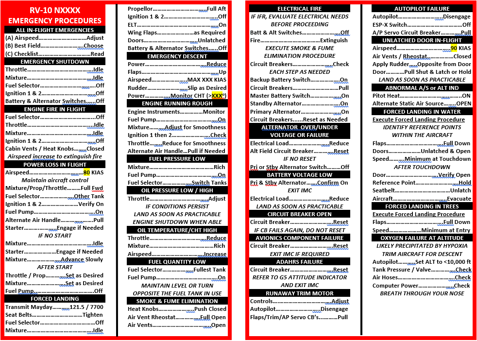

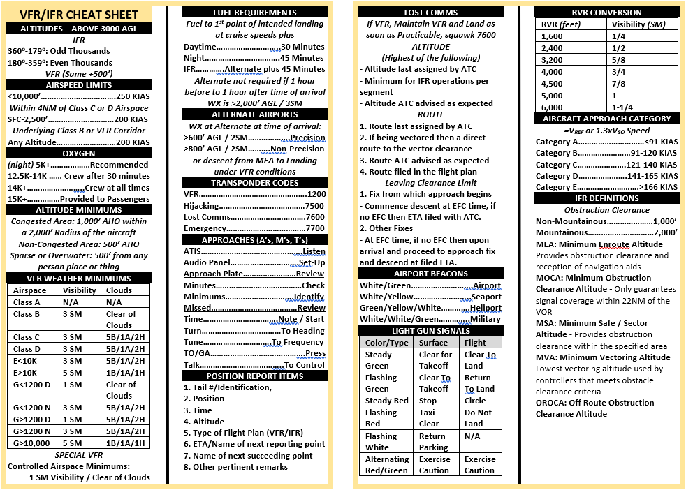

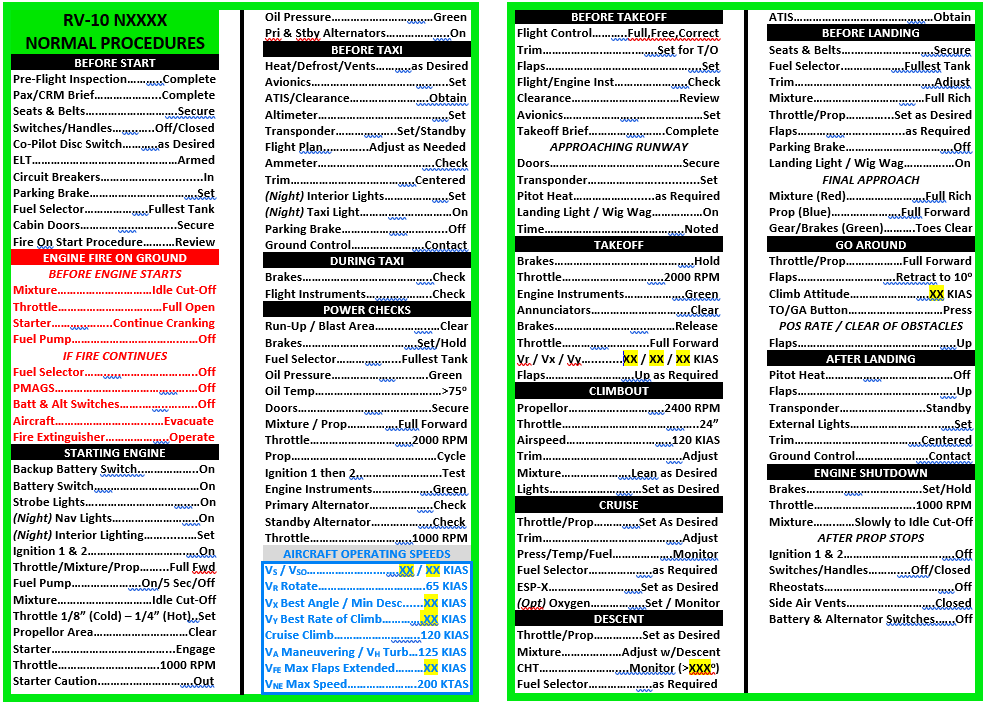

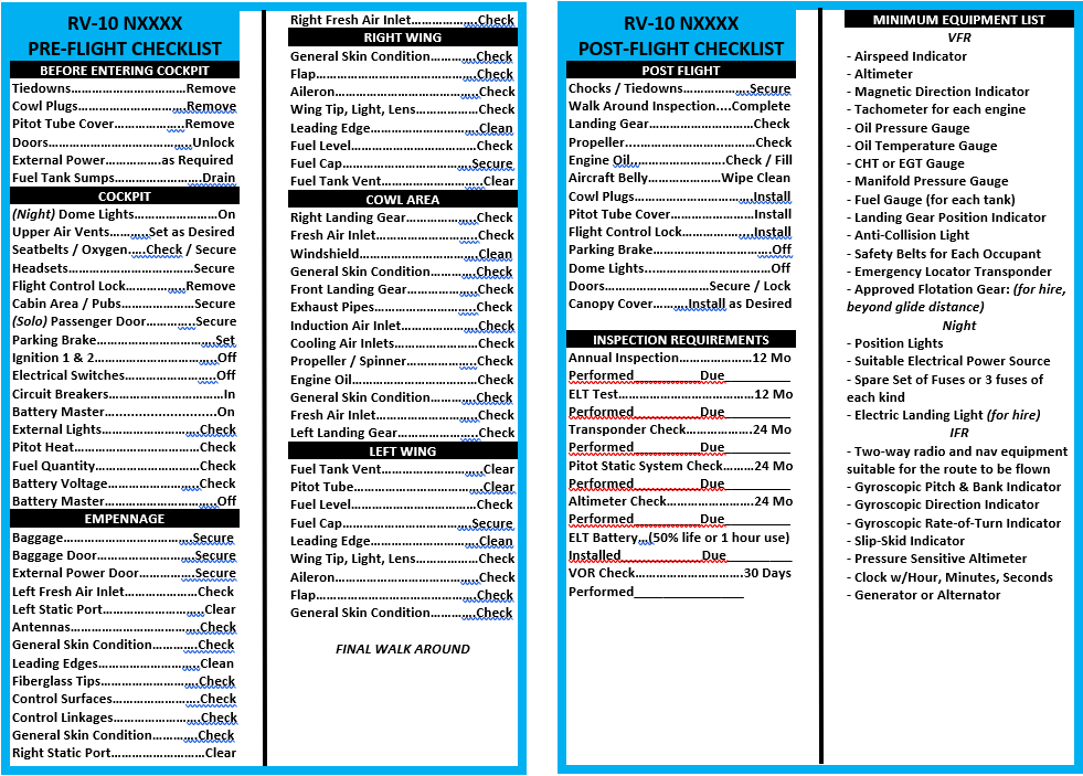

I am in between build projects so I decided to build out some checklists for a future RV-10. I made Normal, Emergency, Preflight, and a VFR/IFR cheat sheet for common reference items in the aircraft. These are designed to be folded in half and laminated for ease of storage in the side pockets. I attached pictures, but will gladly send the word document for anyone that would like to modify them for their specific aircraft (I left speeds off since I don't have an aircraft to determine those yet). These could likely also be easily adapted to other single engine aircraft so feel free to share. If you would like the word document just PM me with your email address and I will send them over. Hope this helps.
