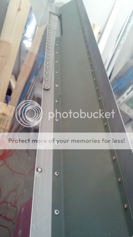

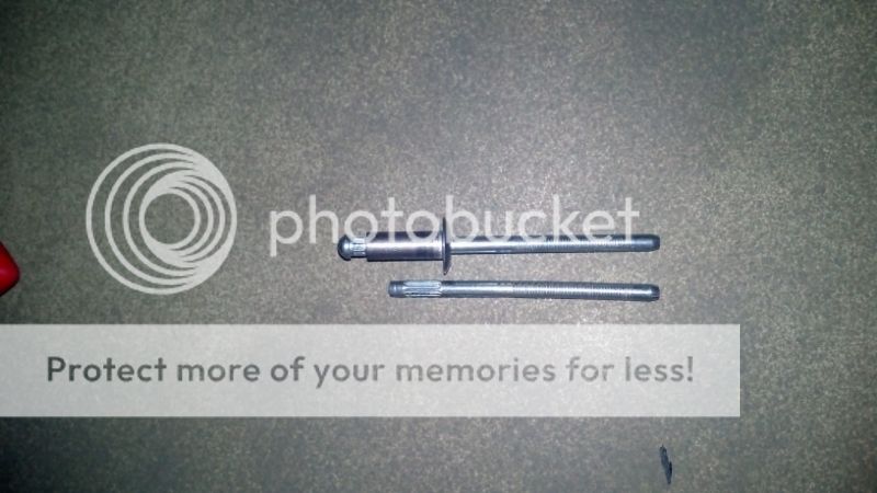

This weekend I installed the flap gap fairings on my QB wings. After contacting the mothership for advice on a substitute for the inboard rivets, I started installing the MSP-42 cherry rivets suggested. During the pull on 2 of the rivets, the stem broke low enough that I can't get a grip to finish it out.

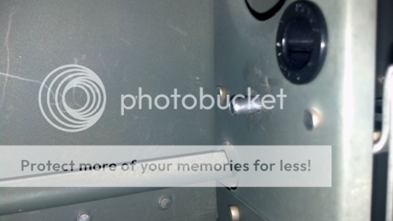

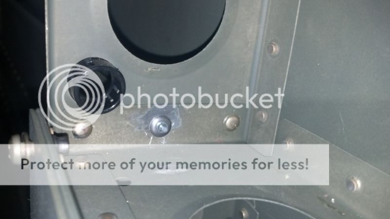

Afterwards, I thought I'd move to another job - correcting a goof on the battery box install in the tail cone. This is the intersection of F1029 and the F1007 frame. The suggestion from Vans in this case was a BSPQ-5-4. During the install the stem broke as well, but worse than that the bulb on the backside doesn't look even close to well formed.

First - I did enough of the blind fasteners on the horizontal to remember to keep the stem perpendicular to the piece. Is there anything else that could be causing the stems to break (tooling is my first thought)?
Second - Obviously these need to be replaced, but some technique suggestion would be appreciated. I had to drill out 1 previous blind with the stem still present and it turned into a disaster because the drill wandered and enlarged the hole. I don't want that in my spar. Any suggestions on an easy way to pop out the stem?

We remove the occasional pop rivet working on our "Brand S" project, and have found that the easiest way to remove the stem is an automatic center punch with a small-diameter tip (grind one down if you have to - they are cheap at Home Depot). Just pop away until the stem exits the other side for parts unknown....

like Paul said, you might have to grind down the broken stem, a dremel works great for this then using an automatic center punch drive it out backwards. You can then drill out the head. Just make sure you only go deep enough to break off the head. Don't try to go all the way through.

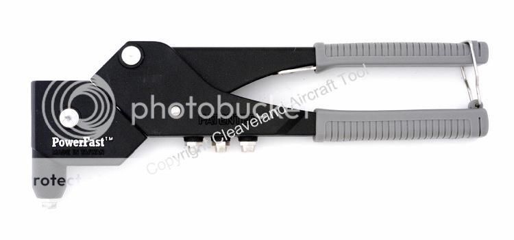

My rivet puller is from Cleaveland Tool - very minor use, but not with proseal. I'll check tonight for contaminants though - maybe a chip of aluminum or something.
Check for proper tip size. You want the hole to just pass over the stem. I has a problem with Cherry Max doing just like yours. Took a smaller dia. hole tip from another gun and problem solved.

Thinking out loud - - The end of the rivet puller nose has a conical shape that spreads the jaws. When the jaws are pulled up(handles squeezed), they close and pull on the shank. Is it possible that the shank length available for engagement is too short for this tool? If so, could the tip be modified to allow more shank engagement? Like shortening in a lathe - maybe both ends?
Edit: Looking at the pic closer, it might be the larger hole in the puller is pinching the hole around the shank.
